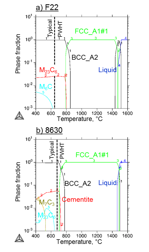

Figure 8 - Thermo-Calc prediction of phase equilibrium in a) the F22 and b) the 8630 parent metals.
Predicted phase equilibrium calculations for the 8630 parent metal, Fig.8, shows that above the martensite transformation temperature, complete dissolution of the M23C6 and M7C3 carbide phases is possible. Chemistry differences, between the 8630 and lower carbon content F22 forging, result in dissimilarities in phase content; cementite is not stable in the F22 forging, whereas M6­C carbide is not stable in the 8630 forging. At a typical PWHT temperature of 650°C, complete dissolution of M23C6 is not predicted in the F22 forging.
