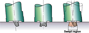

2.2 Skew-stir TM lap welds
The Skew-stir TM variant of FSW differs from the conventional method in that the axis of the tool is given a slight inclination (skew) to that of the machine spindle, as shown in Fig.6.
Fig.6. Basic principle of Skew-stir TM
A lap joint made with a Flared-Triflute TM probe is shown in Fig.7(a). In this example the width of the weld region is 190% of the plate thickness and little upper plate thinning is apparent. (The corresponding weld width achieved when using a conventional threaded pin probe is 110%).The notch at the edge of the weld achieved using this tool is shown in Figs.7(b) and (c). It should be noted that the notch at the retreating side ( Fig.7(b)) does not lie in a direction perpendicular to the sheet interface as it does in a weld made with a conventional pin probe. The notch at the advancing side ( Fig.7(c)), however, turns in a direction perpendicular to the sheet interface, but this is much less pronounced than when a conventional pin is used.
