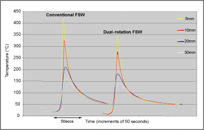

One advantage of dual-rotation FSW is that it reduces the peak temperature reached during the weld thermal cycle. Figure 16 shows a comparison of thermal profiles produced by conventional rotary and dual-rotation friction stir welds made in AA7050-T7451 using similar probes and process conditions. For a given travel speed of 5.25 mm/sec(315 mm/min), a difference of approximately 66°C in the maximum temperature of the HAZ region close to the probe (5 mm from the weld centre line) is shown.
Fig.16. Thermal profiles of conventional rotary friction stir welds and dual-rotation friction stir welds made in 6.35 mm AA7050-T7451, using the same probe geometry and a travel speed of 5.25 mm/secs (315 mm/min). The probe rotation speed was 394 rev/min and 388 rev/min for conventional rotary and dual-rotation stir welding techniques respectively

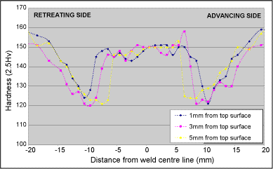

The lower temperatures reached in the dual rotary weld reduce the change in mechanical properties produced during friction stir welding. After two months natural ageing ( Figures 17 & 18), the dual-rotation friction stir weld shows higher hardness values in the stirred zone, thermo mechanical affect zone (TMAZ) and heat affected zone (HAZ) compared to the conventional friction stir weld.This indicates that the lower temperatures produced by the dual-rotation technique reduced thermal softening resulting in an increase in weld hardness.
Fig.17. Hardness traverses as a function of depth through the cross section of a conventional friction stir weld made in 6.35 mm AA7050-T7451, using a travel speed of 5.25 mm/sec (315 mm/min) and a probe rotation speed of 394 rev/min
