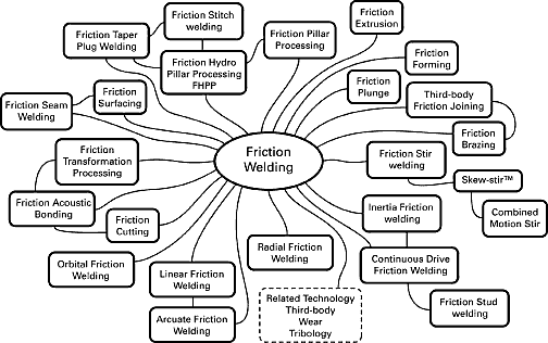

It has long been recognised that frictional heating can be used to join, process and treat materials.
Fig.1. Friction processing technologies
A number of friction based technologies have been developed that enable the friction processes to be applied to a range of component shapes and products [1-7] (see Fig.1). For example non-rotary, orbital, linear and angular reciprocating motions have enabled the friction process to be applied to a variety of non-round components. [8,9] Practically all of these friction welding techniques are regarded as 'one shot' joining processes, whereby the joining process essentially takes place at more or less the same time across the entire joint. Thus, as the cross-sectional area of the joint becomes larger, so the forces involved in the friction welding operation increase proportionally and eventually, in practical terms, become prohibitive.

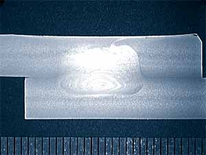

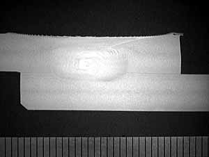

A lap joint made with a Flared-Triflute TM probe is shown in Fig.5. In this example the width of the weld region is 190% of that of the plate thickness and little upper plate thinning is apparent at the weld interface.
Fig.5. Macrosection showing a wide weld region produced using a Flared-Triflute TM probe with lap welding tip profile. Lap weld produced in 6mm thick 5083-0 condition aluminium alloy, at a weld travel speed of 4mm/sec (240mm/min)

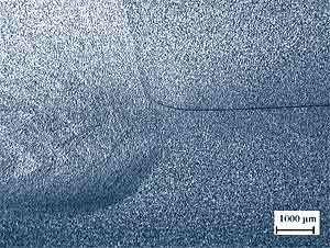

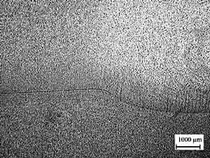

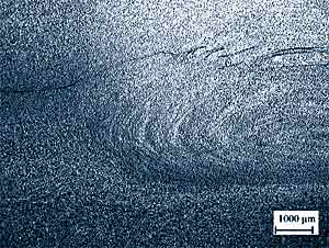

The outer regions of the weld at the overlapping plate/weld interface show a slight upturn (see Fig.6a and b). This upturn is much less than that caused by a conventional pin type probe. A greater presence of oxide interface remnant is revealed at the retreating side (see Fig.6a) compared with the advancing side (see Fig.6b).
a) Retreating Side
b) Advancing Side
Fig.6. Detail at the extremes of the weld region. For Flared-Triflute TM type weld shown in Fig.5

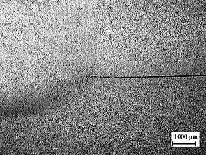

In this example, the width of the weld region is 195% of the plate thickness and no upper plate thinning at the weld interface is apparent. Unlike the welds produced with the Flared-Triflute TM probe, ( Fig.6a and b) the welds produced with an A-Skew TM probe revealed a nominal downturn at the outer regions of the overlapping plate/weld interface ( Fig.9a and b). As with the Flared-Triflute TM welds shown in Fig.6a and b, these A-Skew welds revealed a greater presence of oxide interface remnant on the retreating side, Fig.9a, compared with the advancing side, Fig.9b, as would be expected with a conventional pin type probe.
a) Retreating side
b) Advancing side
Fig.9. Detail at the extremes of the weld region for the A-skew TM weld shown in Fig.9

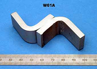

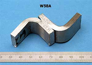

Mechanical testing of lap welds was undertaken using a 'hammer 'S' bend test'. Bend testing was carried out with the weld region unrestrained. This lap 'hammer 'S' bend test' proved a discerning method for establishing basic weld integrity and freedom from weakness caused by plate thinning. Figure 10a and b show typical results achieved from welds produced with Flared-Triflute TM and A-Skew TM probes.
a) Lap weld produced using a Flared-Triflute TM probe
b) Lap weld produced using a A-skew TM probe
Fig.10. Hammer 'S' bend tested lap welds

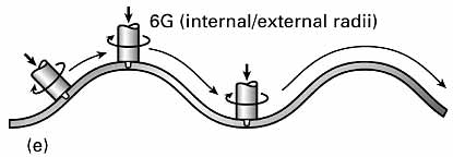

Tubular applications of FSW
For most applications, the FSW technique is used as a one sided welding process. The solid-phase characteristic of FSW provides all-positional welding capability. [10] Figures 11a-e show a number of FSW applications for positional welding, which give difficulty when fusion welding.
When welding flat plate it is immaterial whether the FSW process is applied to the joint internally or externally (see Fig.11a and b).
a) Welding of hollow component
b) Welding of hollow component
c) Welding stationary horizontal pipe
d) Welding stationary 45° angled pipe
e) Welding a corrugated component
Fig.11. Examples of positional Friction Stir Welding
(The G designations refer to the American Welding Society convention for positional welding [23] )
Furthermore, FSW can be achieved by traversing the tool or the workpiece. However, when welding comparatively small radii tubular components the design of the shoulder depends upon whether the tool is applied to the outside or inside of the tube.
Moreover, when welding tubular components, either the tool can be traversed around the tube (in which case all-positional welding is employed) or the tool is stationary and the tube is rotated (in which case welding is generally performed in one position).

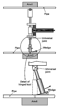

With regard to the future, investigations at TWI are continuing to explore a number of developments. Applications include cylindrical tanks and similar tubular components. [10,24,25] Figure 12 illustrates the essential design concept being considered to enable a single or multi-headed friction stir welding facility to be used to internally butt weld line pipe and carry out remote down hole-repairs.
a) Side view
b) End view
Fig.12. FSW design concept facility for butt welding of line pipe. Comprising a hinged flexible drive head together with a longitudinal positioned 'run off' wedge plate, designed to eliminate any end of run hole filing requirements.
A minimum of three centralising roller supports is shown, although the actual number would depend on the flexibility of the tubular component being welded. Additional roller supports would act as an expansion device to force the tube against the external anvil. The necessary pressure of the tool on the inside tubular workpiece would be kept constant during the welding operation. At the end of the weld the FSW tool will then be swung in a longitudinal direction on to a removable curved wedge plate to allow the probe to clear from the workpiece. Such a technique will eliminate problems associated with the exit hole. Apart from butt welding, the approach could also be applied to the manufacture of helical welded pipe and to the repair of defects encountered in pipelines.
