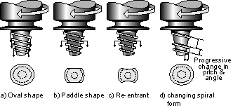

Trials were carried out with the Whorl™ +FSW tool shown in Figure 2, which included a scoop shouldered profile with a frustum shaped probe that incorporated a helical ridge with side flats designed to augur plasticised material downwards. The tool inclination included a combined 3° tilt with the acute angle towards the start of the weld in line with the longitudinal direction of the weld seam, and a 1° tilt towards the retreating side of the weld by tilting the workpiece.
Fig.2 FSW basic variants for Whorl™ type tool.

The main probe development variants of the Whorl™ tool are shown in Figure 2 . Essentially the probe is shaped as a frustum that displaces less material than a cylindrical tool of the same diameter as the probe shoulder change in section. Providing a certain minimum probe tip diameter is maintained the frustum shape means less effort is required to traverse through the plasticised material. The frustum also is more uniformly stressed and the shape ensures that the lower surface of the helical ridge provides a clear downward augering force, with less interference from the next ridge below. The core of the probe need not run parallel with the helical ridge nor does the ridge have to be of uniform pitch. In this respect the helical ridge is not a simple external thread which has to engage with an internal thread, but is essentially an auger which is immersed in the super-plasticised medium it creates.
Fig.8 Whorl type sea shell showing progressively changing pitch and tapered shape.
To enable more effective flow of the plasticised material, it is preferred that the distance between each ridge is greater than the thickness of the ridge itself. The Whorl™ concept provides for probe cross-sections that, apart from circular, can be nominally oval, flattened or re-entrant whereby the probe displacement volume is less than its volume of rotation again to enable the easier flow of plasticised material. In addition the inclination of the continuous spiral ridge can range from nominally 45° to as low as 5° or as high as 85° to the axis. This range allows adjustment in the degree of stirring versus downward drive of the plasticised material. For this downward thrust the rotation, as viewed from underneath the shoulder, must be in a clockwise direction for a right hand spiral, and vice versa. (A whorl type sea shell, with a spiral of progressively changing pitch is shown in Figure 8).
Inherent to all rotating systems is the natural dynamic orbit associated with rotating machinery. Together with the shape of the probe, it is this inherent or even nominally superimposed eccentricity that helps the plasticised material to be transported around the probe. In this respect non-circular flat-sided (paddle type) probes, enable the plasticised material to pass rearwards more easily with each half turn of rotation.
