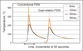

Owing to the relatively low temperature reached, with solid-phase welding techniques such as FSW, the problems of solidification and liquation cracking when fusion welding certain materials, can be significantly reduced. However,the thermal cycle produced in FSW is sufficient to modify the original alloy temper in certain heat-treatable materials (e.g. 2xxx and 7xxx series aluminium alloys) producing a reduction in both the mechanical and corrosion properties across the weld. [2 & 3]
One advantage of dual-rotation FSW is that it reduces the peak temperature reached during the weld thermal cycle. Figure 4 shows a comparison of thermal profiles produced by conventional rotary and dual-rotation friction stir welds made in AA7050-T7451 using similar probes and process conditions. For a given travel speed of 5.25 mm/sec (315 mm/min), a difference of approximately 66°C in the maximum temperature of the HAZ region close to the probe (5 mm from the weld centre line) is shown.
Fig.4. Thermal profiles of conventional rotary friction stir welds and dual-rotation friction stir welds made in 6.35 mm AA7050-T7451, using the same probe geometry and a travel speed of 5.25 mm/secs (315 mm/min). The probe rotation speed was 394 rev/min and 388 rev/min for conventional rotary and dual-rotation stir welding techniques respectively

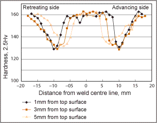

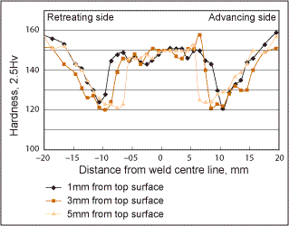

The lower temperatures reached in the dual rotary weld reduce the change in mechanical properties produced during friction stir welding. After two months natural ageing ( Figures 5 & 6), the dual-rotation friction stir weld shows higher hardness values in the stirred zone, thermo mechanical affect zone (TMAZ) and heat affected zone (HAZ) compared to the conventional friction stir weld. This indicates that the lower temperatures produced by the dual-rotation technique reduced thermal softening resulting in an increase in weld hardness.
Fig.5. Hardness traverses as a function of depth through the cross section of a conventional friction stir weld made in 6.35 mm AA7050-T7451, using a travel speed of 5.25 mm/sec (315 mm/min) and a probe rotation speedof 394 rev/min
Fig.6. Hardness traverses as a function of depth through the cross section of a dual-rotary friction stir weld made in 6.35 mm AA7050-T7451, using the same probe geometry used in the conventional friction stir weld ( Figure 5), a travel speed of 5.25 mm/sec (315 mm/min), and a probe rotation speed of 388 rev/min and a shoulder rotational speed of 145 rev/min

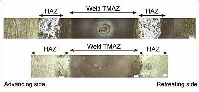

The HAZ of conventional friction stir welds in both 2xxx and 7xxx series aluminium alloys has been shown to be the region most susceptible to localised corrosive attack. [4] Figure 7 shows a comparison of the extent of corrosion in specimens from conventional and dual-rotation friction stir welds that were exposed to the same test. Both welds were made in 6.35 mm AA7050-T7451, using similar probes and process conditions.
Fig.7. Photomacrograph of the top surface of a) Conventional friction stir weld; and b) Dual rotation friction stir weld
After two months natural ageing the 'near shoulder side' of the weld surface was removed and the surface prepared to a ¼ micron finish before being immersed in a 0.1M NaCl aerated solution at ambient temperature for 7 days. Both welds were made in 6.35 mm AA7050-T7451 using the same probe geometry and a travel speed of 9.2 mm/secs (552 mm/min). The probe rotation speed was 394 rev/min and 388 rev/min for conventional rotary and dual-rotation stir welding techniques respectively. A shoulder rotational speed of 145 rev/min was used for dual-rotation.
In the conventional friction stir weld the high temperature HAZ is shiny due to severe localised attack that has occurred in this region, therefore cathodically protecting the surrounding areas in the HAZ. In the dual-rotation friction stir weld there is no shiny region evident in the HAZ suggesting the degree of localised attack occurring in this region to be lower than in conventional FSW.

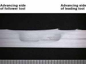

Metallographic examination of Staggered twin-stir TM lap welds revealed that the r width of the a 'common weld region' measured 430% of the sheet thickness as shown in Figure 14.
Fig.14. Macrosection taken from the 'common weld region' of a Staggered twin-stir TM lap weld in 3mm thick 5083 -H111 aluminium sheets
The tool arrangement used to produce this Staggered twin-stir TM weld is that illustrated in Figure 9; whereby the advancing sides of the 'common weld region' are positioned outwards. Consequently, both retreating sides face inwards with the lead weld retreating side receiving further friction stirring treatment from the retreating side of the follower tool.
