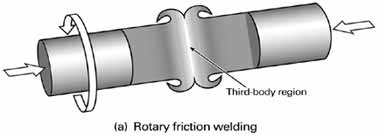

The earliest and most common friction welding technique is rotary, see Fig.1(a). The parts to be joined are subjected to dry friction during the initial contact, but quite rapidly, as a result of microscopic local seizures and subsequent rupture, a 'third-body' layer of finite thickness is formed. This transient 'third-body', effectively provides a quasi-hydrodynamic bearing. [1-3]
Fig.1. Friction welding variants
Two variants of the rotary friction welding process have been developed. These are known as conventional 'continuous drive friction welding' and 'stored energy friction welding'. The most widely adopted is inertia friction welding.
The essential difference between the two rotary friction welding methods is that, while under a constant or increasing axial load, continuous drive welding is carried out at a constant rotational speed (that may be changed to higher or lower constant rotational speeds at different stages of the weld cycle), while inertia welding starts at a relatively high rotational speed and progressively reduces to zero. The concept underlying inertia friction welding is that a predetermined amount of kinetic energy can be stored in a flywheel and converted into heat at the weld interface. Other non-rotary friction welding techniques are known, these include orbital, linear, and angular reciprocating friction welding.

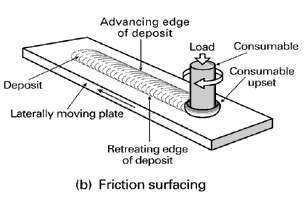

Friction surfacing uses a consumable in the form of a solid round bar, or tube, and is now established as a surfacing technique. [4,5] The basic principle of the friction surfacing process is illustrated in Fig.1b. The deposit, a product of a hot forging action, is inherently homogeneous and of good mechanical strength. The interface region usually remains intact, even after resisting loads equal to the ultimate tensile strength of the weaker material. Fig.2, shows a 6082 aluminium friction surfaced deposit.

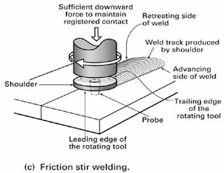

Friction stir welding (FSW), Fig.1c, was invented in 1991 and developed at TWI [6] but is still regarded as a new process. FSW is a technique which allows aluminium, lead, magnesium, titanium steel and copper to be welded, continuously, with a non-consumable tool. [7-8] The technique brings the benefits of solid-phase friction welding to certain materials regarded as difficult to weld by fusion processes. Fig.3, shows details of the macrostructural features within a 25mm thick 6082-T6 condition friction stir welded test weld.

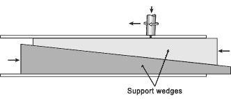

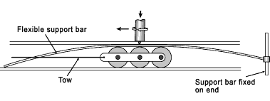

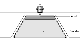

With regard to the future, investigations at TWI are continuing to explore and develop a number of techniques for welding extrusions and hollow sections. The friction stir welding of certain thin walled hollow sections requires internal mandrel support, e.g. moving anvil, hydraulic actuated or scissor action support Fig.6a, b & c, illustrates some design concepts being studied at TWI

Fig.6c) Hydraulic Bladder/Anvil support
Fig.6. Extrusion & hollow section supports for FSW

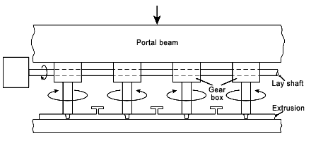

Invariably manufacturers want to fabricate their products as fast as possible. Increasing the welding speed or, as with certain applications, the use of purpose designed multi-headed friction stir welding machines, can increase productivity and profitability. Figure 7 illustrates a design concept for an opposed rotation multi-head friction stir welding machine. Such opposed tool rotation balances side force asymmetry and enable a reduction in the reactive torque normally necessary to clamp plates together. A roller clamping system would be used in conjunction with the multi-head technique.
