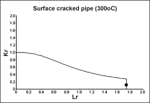

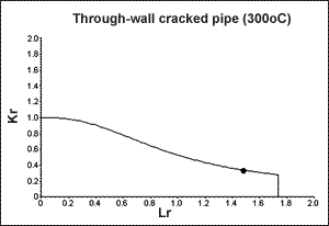

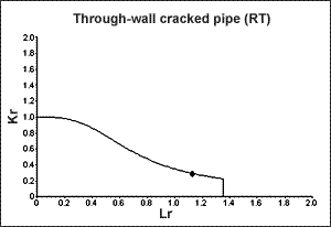

Critical parameter analysis was carried out for applied load and maximum values obtain for each case is given in Table 4. This maximum load is associated with the assessment points, which locate on the Failure Assessment Lines ( Fig.1). As it clearly shown in Table 4, both BS 7910 and API 579 procedures predicted similar maximum load for the through-wall-cracked pipes. However, the prediction for surface-cracked pipes is inconsistent between the two procedures: API 579 predicts higher maximum load (with less conservatism in comparison with experimental results) compared with BS 7910.

Fig.1. FAD curves with assessment points for all the pipe geometries studied. Failure mode for all the pipes is plastic collpase

Assessment of the pipes 01-03 under four-point bending showed that plastic collapse is dominant failure mode for all of them. This can be seen from Figs.1a to c, with failure assessment points close to the plastic collapse region. This justifies sensitivity of assessment results on reference stress value as well as tensile properties of the pipe material.

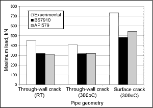

Predictions by BS7910 and API579 for through-wall cracked pipes are conservative (on the safe side) relative to the experimental results ( Fig.2).
Fig.2. BS 7910 and API 579 maximum load predictions for the through-wall and surface cracked pipes at RT and 300°C
For the pipe 03 with surface crack, API 579 compared with BS 7910 predicts higher maximum applied load. Two reasons can be mentioned:
One is that BS 7910 implements Kastner equation ( Kastner et al, 1981) for estimation of reference stress of circumferential surface cracked pipes, whereas API 579 recommends using of different solution ( Eiber etal, 1971). A separate study conducted at TWI ( Cheaitani et al, 2002) revealed that Kastner equation is more conservative than the API 579 solution ( Eiber et al, 1971). This conclusion are drawn when both solutions were compared with the result of a verified finite element study ( Cheaitani et al, 2002). Since plastic collapse is dominant failure mode for the pipe 03, hence less conservative reference stress value will result in less conservative predicted maximum load as shown in Table 3 and Fig.2.
Another reason for the difference between BS 7910 and API 579 predictions could be the result of using flat plate solution by BS 7910 (Raju et al, 1979) for the current surface cracked pipe (Pipe 03). This is done owing to geometrical restrictions. On the contrary API 579 implements using of different solutions ( Klecker et al, 1986) for the same pipe geometry. Although the pipe dominant failure mode is plastic collapse but nevertheless the effect of input stress intensity factor should not be neglected thoroughly.

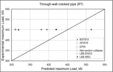

Fig.3. Comparison of the maximum load prediction for the through-wall pipe at room temperature

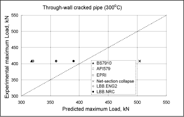

Fig.4. Comparison of maximum load predictions for the through-wall cracked pipe at 300°C

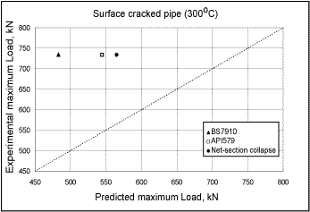

Figures 5-7 also show comparative study between all the aforementioned engineering methods, including BS7910 and API579. Apart from the net-section collapse method, rest of the Engineering routes predicts maximum load for through-wall cracked tested pipes conservatively. The level of conservatism is less for LBB. NRC (1986) compared with other methods used.
Fig.5. Comparison of maximum load predictions for the surface cracked pipe at 300°C
