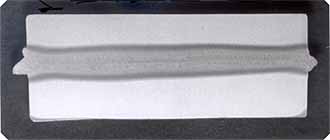

As in the case of high vacuum EBW, it was found that penetration performance was significantly increased in the horizontal-vertical (HV) mode. Fig.8 shows a typical weld made in 30mm stainless in the HV welding mode. Although the fusion zone profile was by no means ideal, it did demonstrate that NVEB was capable of producing high depth-to-width ratio welds.
Fig.8. NVEB weld made in 30mm, 316 stainless steel in the HV mode; beam power 250kV x 300mA; welding speed 1350mm/min
