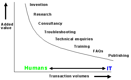

The usage of JoinIT® and TWI's web site is increasing monthly and there are now 60,000 user sessions per month. Of course, knowledge transfer can take place in many ways. Figure 1 shows the various mechanisms used by TWI and, in 10 years from now, it is certain that all will still be in place. However, we can anticipate that there will be much more transfer of knowledge involving IT delivery, working more towards the right hand side of Figure 1. All companies will need to give consideration to retaining a 'corporate technical memory' and the magnitude and expense of the task should not be underestimated. It is one thing to have the necessary hardware and software tools, but another to capture knowledge from experienced staff in the appropriate form so as to create the necessary content for the corporate memory.
Fig.1. Analysis of TWI services

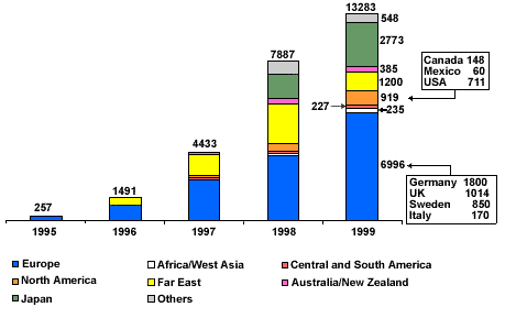

Pekkari [6] recently reviewed those matters which must be tackled by companies involved in welding, joining and cutting if we are to reduce the impact on our environment. He placed emphasis on the need for companies to work to ISO 14001 and to install an Environmental Management System, and he noted that some major organisations are already getting their vendors to put in appropriate management systems if they want to remain a supplier. Figure 2 shows a list of worldwide ISO 14001 certifications and reveals that there is significant growth taking place in Europe and Japan in the numbers of certifications, and this growth will undoubtedly continue in the next 5 years. Whilst regulation will have a big and immediate effect on welding consumable suppliers, all manufacturers will need to be concerned increasingly with waste management, recycling, disassembly and packaging, as well as with the usual issues of welding fume, electromagnetic fields, radiation, laser safety and other similar factors governing health, safety and the environment.
Fig.2. ISO 14001 certifications in the world ( ref.6)
