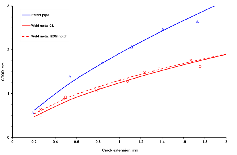

Fracture toughness was determined using single edge notch tension (SENT) specimens based on the design and testing method described in DNV RP F108 (2006). The specimen had an over-square cross-section (2BxB, where B is 16mm; this corresponds to the pipe wall thickness after machining to remove curvature), with crack depth to width ratio (a/W) of approximately 0.3. The specimens were notched from the pipe OD by electro discharge machining (EDM) and then fatigue pre-cracked to achieve the final crack depth. In addition, a set of tests was conducted using EDM notches located in the weld metal of a girth weld which was tested for a subsequent phase of the project. The radius of the notch tip was 0.12mm and similar to the radius employed to make the notches in the full-scale pipe tests. The purpose of these tests was to determine whether notch root radius influenced fracture toughness resistance curve in material (weld metal in this case) with lower resistance than the parent pipe.
The CTOD resistance curves (R-curves) were determined using a multiple specimen procedure. CTOD was obtained using a double clip gauge method in which the clip gauge readings obtained above the notch mouth are extrapolated to the crack tip. The equation used is:
eq-1
(1)
Where
ao       =    initial crack height
V1      =      crack mouth opening measured by clip gauge at a height of z1 above the surface
V2    =    crack mouth opening measured by clip gauge at the height of z2 above the surface.
The CTOD R-curves obtained in this way are shown in in Figure 2 and are described by the Equations 2, 3 and 4 (the units are in mm):
Parent pipe (fatigue precracked):
δ = 1.917 Δa0.704                                                                                  (2)
Weld metal (fatigue precracked):
δ = 1.248 Δa0.6                                                                                     (3)
Weld metal with EDM notch (0.12mm tip radius):
δ = 1.303 Δa0.549                                                                                                                           (4)
The weld metal R-curves are almost identical indicating that, in this case, insensitivity to crack tip radius relative to the standard fatigue precracked specimens. Although these tests were conducted on weld metal, the same insensitivity to crack tip radius is expected in the tougher parent pipe.

Fig.2 SENT CTOD R-curves for parent pipe and weld metal using fatigue precracked specimens except where indicated.

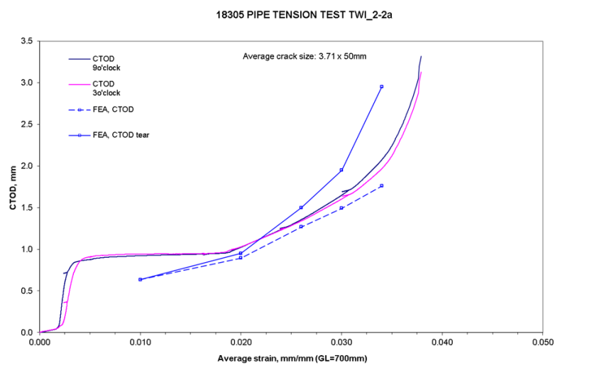

The CTOD versus strain plots shown in Figures 6 and 7 indicate that at 3 and 9 o’clock both 6x50mm notches exhibited near identical behaviour. However, at 12 and 6 o’clock, containing 5x100mm notches higher CTOD values were obtained at 12 o’clock compared with 6 o’clock for the same overall strain. There appears to be zero error in CTOD at 6 o’clock but this could be possible local crack closure resulting from straightening of the pipe during initial elastic loading. Nevertheless, the differences in CTOD were significantly reduced at strains exceeding 3.8%. During the Lüders plateau phase, CTOD remained relatively constant and only began to increase when work hardening started (at approximately 2.5% strain).
Fig. 7 CTOD versus average overall strain compared with FEA modelling with and without ductile tearing for cracks at 12 and 6 o’clock.

The development of CTOD with increase in strain is shown for the two notch sizes in Figures 12 and 13. Although the behaviour of the two 4x50mm notches at 9 and 3 o’clock was similar, the 3x100mm notches at 12 and 6 o’clock differed significantly. Initially, CTOD was lower at 6 o’clock than at 12 o’clock, but when overall strain exceeded 3.5%, the reverse took place and CTOD increased rapidly until a leak occurred at 6 o’clock at 4.1% strain. As observed in the pipe test conducted axial straining alone, CTOD remained essentially constant during the Lüders phase. CTOD began to increase at around 1.9% strain; this was approximately 0.6% strain lower than in the previous test. The maximum load condition was reached at a strain of 3.47% when the CTOD was 2.83mm. When the leak occurred there was a rapid de-pressurisation of the pipe and the test was discontinued. At all notches, crack extension was by ductile tearing and the fracture face at the location of the notch which caused the leak (at 6 o’clock) is shown in Figure 14.
Fig. 12 CTOD versus average remote strain compared with FEA modelling with and without ductile tearing for cracks at 12 and 6 o’clock.
Fig. 13 CTOD versus average remote strain compared with FEA modelling with and without ductile tearing for cracks at 3 and 9 o’clock.
