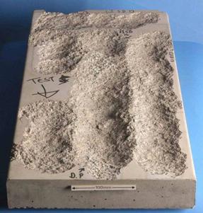

For the series of results reported in this section, the laser power was fixed at 4000W and a laser spot size of 43mm diameter was used, corresponding to a laser power density of 280W/cm2 incident on the concrete surface. Passes were made with the surface of the samples both dry and wet. Figure 3 shows the effects of a series of single passes of the beam over the concrete surface, at speeds from 50 to 300mm/min. For speeds at and below 100mm/min, significant vitrification of the surface was seen, producing a very hard black glassy result, so hard in fact that a wire brush could not remove it. Wetting the surface did not improve the situation, as can be seen if the two passes at 100mm/min are compared. No additional work was performed on this particular type of concrete.
Results - Limestone aggregate
For the series of results reported in this section, the laser power was fixed at 4000W. Laser spot sizes of 65, 43 and 23mm diameter were used, corresponding to laser power densities of 120, 280 and 960W/cm2 respectively, incident on the concrete surface. Passes were made with the surface of the samples both dry and wet. Clearly obvious with the first slab of this concrete, processed with the spot size of 65mm diameter, was a clear scabbling process, characterised by the spalling of significantly large pieces of concrete at high expulsion velocity, leaving a scabbled surface which showed no indication of melting. Figure 4 shows the effects after the scabbling process on this type of aggregate. In this photograph no brushing or cleaning of the surface has been performed. In particular the run on the right of the picture is a single pass at a speed of 100mm/min, while the central run corresponds to a double pass, one on top of the first, at the same conditions and a travel speed of 100mm/min.

All results presented in this section relate to the use of concrete containing limestone aggregate. For a given laser spot size on the concrete, the main process parameters are the laser power and the travel speed. Work performed has indicated that removal rate is proportional to laser power, at least up to the 5kW of power available with the laser being used, as can be seen in Figure 6.
Figure 6. Concrete removal rate and heat input as a function of laser power at a process speed of 200mm/min, for limestone aggregate
At 5kW power, this system has removed material, to a depth greater than 10mm, over a surface equivalent to one square metre, in a time of 110min. A single pass of the process results in a scabbled 'trough', lenticular in section. This shape is related to the energy distribution in the incident laser beam which, at the concrete surface, is Gaussian in form regardless of the fibre delivery. A slower process speed will generally result in a deeper scabbled section, as shown in Figure 7. For concrete containing limestone aggregate, the deepest section has been measured at 22mm, using a laser power of 5kW and a travel speed of 100mm/minute. For removal of large surface areas, a track overlap of 50% proved to be the most effective for producing a uniform depth in the scabbled profile, as can be seen in Figure 8.
