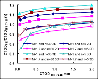

In Figure 1, the ratio γis plotted versus CTOD BS 7448 for the specimens with a straight crack front analyzed using 2D and 3D FE models. Results were obtained for strong hardening behaviour (n=5) and approximately perfectly plastic condition (n=30), and strength mismatch of M=1 and M=1.7. Figure 1 shows that for the same work hardening and strength mismatch, the 3D models generally produce higher CTOD values than the 2D models. This was probably a result of lower constraint generated at the mid-plane of a 3Dmodel compared to the fully plane strain conditions assumed in the 2D model. The variations in γ mean that at small CTOD values (~ 0.1mm), the BS7488 equation results in a 25% overestimate of CTOD, whilst at large CTOD values (~ 2mm), CTOD is underestimated by 20%. Strain hardening (n=5 and 30) had a significantly great effect on CTOD than strength mismatch (M=1 and 1.7). High strain hardening (n=5) generally lead to overestimates of CTOD being made when the BS 7488equation was used. Similar conclusions were drawn by Wang et al (1997) using 2D plane strain FE models to analyze SENB specimens. Since erroneous estimates of CTOD are likely to be made when high strain hardening material is tested,caution needs to be applied when using CTOD values for structural integrity assessment. It has been suggested that the error can be reduced if CTOD is derived from CMOD via J. [Wang, 1997] Indeed, such a procedure has been adopted in ASTM E1290 and E 1280. The effect of strength mismatch (M=1.7) on CTOD was to slightly reduce the γ ratio (less than 8% for n=30), which is within the error estimate of ±10% quoted in BS 7488.
Fig.1. Plots of CTOD FE /CTOD BS 7488 versus CTOD BS 7488 for straight cracks

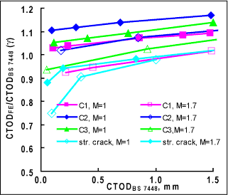

Figure 2 shows the CTOD values obtained from specimens with curved crack fronts C1, C2 and C3, together with the results from a straight crack front for comparison. Specimens, C1, C2 and C3, have curved crack fronts deviating from a straight crack by 3.4, 7.7 and 16%, respectively. For these specimens, J and CTOD estimated according to BS 7488 used the weighted average crack length in accordance with the procedure in BS 7488. In comparison with a straight crack front, crack front curvature generally resulted in an increase of γ. The effect of crack front curvature on CTOD was found to depend on M (for n=5). When M=1, γ for the curved cracks exceeded 1 which means that the BS 7448 estimate of CTOD is conservative. However, when M=1.7, γ was < 1 for CTOD < 0.8mm so that the BS 7488 estimates of CTOD are non-conservative. For straight crack fronts, the analyses show that the BS 7488estimates of CTOD are non-conservative and the error is larger for evenly mismatched strength condition (M=1).
Fig.2. Plots of CTOD FE /CTOD BS 7488 versus CTOD BS 7488 for curved cracks for n=5

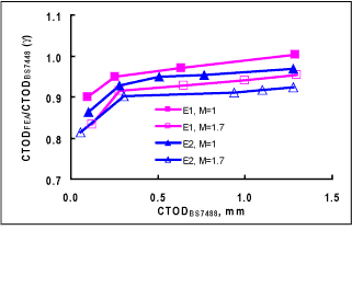

The effect of specimen curvature (along the W dimension) was investigated using specimens E1 and E2 with curvatures of 5%W and 10%W, respectively. As shown in Figure 3, the CTOD values calculated from BS 7448 were higher than those from FEA, with a maximum difference of about 20% at a small CTOD values and a typical difference of between 3% and 10%. This means BS 7448 estimates ofCTOD are non-conservative when specimen curvature is more than 5%W. The maximum allowed by BS 7488 Part 2 is 2.5%W.
Fig.3. Plots of CTOD FE /CTOD BS 7488 versus CTOD BS 7488 for curved specimens for n=5
