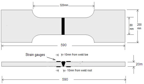

Strip specimens were extracted from 0.8m long ring samples containing identical girth welds to those in the full-scale pipe fatigue test specimens. Figure 1 shows the design for the strip specimens.

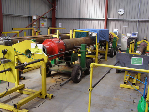

Figure 1. Resonance fatigue testing of the full-scale pipes
3.2 Fatigue tests under constant amplitude loading
3.2.1 Full-scale girth welded pipes
Full-scale girth welded pipes were fatigue tested in resonance rigs, as shown in Figure 2, in order to establish the CA S-N curve. An axial tensile mean stress of 150MPa was applied by pressurising the pipes internally with tap water at a pressure of 34.1MPa (4,950psi). All the tests were conducted in air at ambient temperature and loading frequencies between 25 and 30Hz. During each test, the motor speed, which controls the stress amplitude, was kept constant until the test pipe failed or ran out.
Figure 2. Strip specimen dimensions and strain gauge locations

3.2.2 Strip specimens
CA fatigue tests were also performed on strip specimens to establish their S-N curve. The specimens were tested under axial loading in fatigue testing machines. Two pairs of curved packers, with the same radius as the pipe, were used in gripping the ends of the specimen in wedge jaws. Specimen edges were dressed round and smoothed to prevent premature fatigue failure from an edge. As for the full-scale specimens, the initial strip specimens were tested at a constant tensile mean stress of 150MPa. However, higher mean stresses between 230 and 380 MPa were also tried as the strip specimens exhibited a higher CAFL than the full-scale pipes, as discussed later.
The local stress range near the failure site, allowing for any misalignment-induced secondary bending, was determined for each specimen using the measured strains. By assuming that stress is proportional to strain, the SCF at the weld root due to misalignment was calculated by the following equation:
Eqn 1
Eqn 1
where εr is the strain measured at the weld root of interest and εt is the strain at the opposite weld cap toe. The stress range at the weld toe is the product of Km and the nominal stress range, which was defined as the applied load divided by the cross-sectional area of specimen adjacent to the weld.

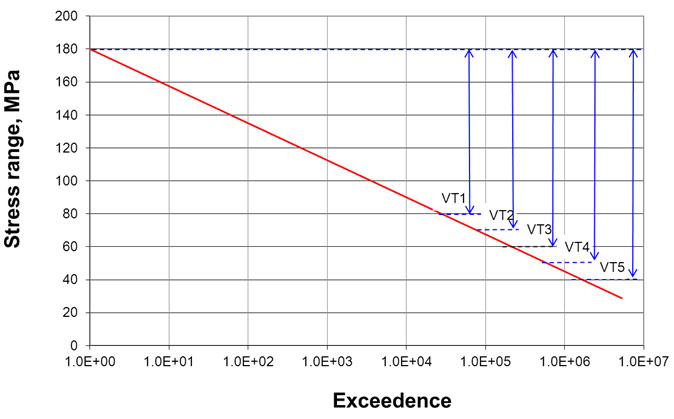

Several sub-spectra with the same maximum stress histograms but different minimum stresses were produced from this spectrum. The characteristics of the five initial sub-spectra, VT-1 to VT-5, as well as their stress distributions are shown in Figure 3. Subsequently, an intermediate sub-spectrum VT-4/5, with a minimum stress range of 45MPa, was introduced. In each case, the exceedence at the minimum stress is the block length for that sub-spectrum.
Figure 3. Stress distribution and definition for each sub-spectrum
All the sub spectra exhibit a linear stress distribution but contain different minimum nominal stress ranges. For example, the minimum and maximum stress ranges for sub-spectrum VT-5 are 40MPa and 180MPa, respectively. Furthermore, the relative fatigue damage, defined as the percentage of fatigue damage at a stress level ΔSi against the total fatigue damage in the spectrum,
Equation
, where m was assumed to be 3.0, gradually increases with decreasing stress range until a value of about 28MPa. This spectrum was intended to make the results of the present VA tests sensitive to the introduction of smaller and smaller stresses. The fatigue damage sum (ΣΔS3n) increased with decreasing minimum stress range in the sub-spectrum, so that it increased progressively from VT-1 to VT-5 [Zhang and Maddox, 2011].

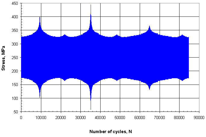

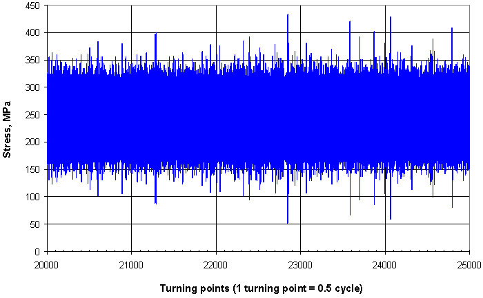

As noted previously, the significance of the practical limitation that resonance rigs can only apply VA loading spectra in a sequential order, with gradual changes in applied stress range (Figure 4), was checked by performing comparative tests on strip specimens in testing machines capable of applying both sequential and random VA loading.
Sub-spectra VT-2 (with a minimum nominal stress range of 70MPa) and VT-3 (with a minimum nominal stress range of 60MPa) were chosen for this investigation. However, to compensate for the higher CAFL associated with the strip specimens (described later), all stress ranges in these spectra were doubled. Thus, the maximum and minimum nominal stress ranges were increased to 360 and 140MPa for sub-spectrum VT-2 and 360 and 120MPa for sub spectrum VT-3, respectively. The applied mean stress in all tests was 230MPa, the same as that used for most CA tests.
The tests were performed in a computer-controlled testing machine that was programmed to apply the stress cycles in each block from the same basic loading spectrum in either a sequential or a random order. For the former, the loading sequence was the same as that used in the full-scale tests. For the latter, it was achieved by selecting the relative stress ranges, Pi (ΔSi/ΔSΔmax), using a random number generator. When the whole of the first block had been applied the process started again and subsequent blocks were applied in the same sequence. This process was repeated until the specimen failed or achieved run-out. A segment of the loading pattern from both sequential and random loading is shown in Figure 5. It should be emphasised that this was an exploratory investigation simply comparing 'sequential' and 'random' loading. Precise details of the random loading sequences seen by SCRs are not available and the present one may not be truly representative.
(a) Sequential loading
Figure 5. Loading patterns of the sub-spectrum VT-2, used for VA testing of the strip specimens:
(a) Sequential loading (same sequence as that used for the full-scale pipes);
(b) Random loading
(b) Random loading.

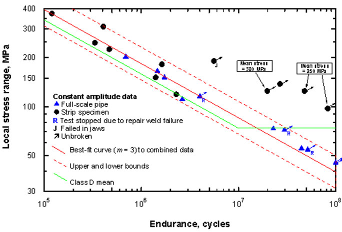

Six pipes, with a total of eleven girth welds, were tested to establish the CA S-N curve. The test results are plotted in Figure 6 where they are seen to be generally better than the [BS 7608 (1993)] Class D mean S-N curve. Examination of the failed girth welds confirmed that fatigue cracking always initiated at the weld root. Noting that the lowest stress that produced failure, with an endurance of 4.4x107 cycles, was 55.4MPa, it appears that the CAFL for these girth welds may correspond to an endurance between 5x107 and 108 cycles, which considering the two unbroken welds that survived for 108 cycles, would be between 45 and 55MPa. The same was found in relation to CA tests on girth-welded 20 inch pipe [Maddox and Zhang, 2008]. It is apparent that the Class D mean fatigue limit of 74MPa, corresponding to 107 cycles, over-estimates the value suggested by the present tests. This argument was further supported by the results of the post-test examination on two unbroken welds which had both been tested under relatively low stresses. One was tested under a local stress range of 54.4MPa and declared a run-out after 5.16x107 cycles while the other was tested under a local stress range of 45.2MPa and declared a run-out after 108 cycles. The post-test examination revealed fatigue cracking from the weld root for both welds, 0.26mm deep in the first and 0.14mm deep in the other.
Figure 6. Comparison of the constant amplitude fatigue performance of the full-scale and strip specimens with the Class D mean curve.
Assuming that all the results from failed welds lie on the same S-N curve, regression analysis produced the mean S-N curve ΔS3.25N = 2.02 x 1013, slightly shallower than the Class D curve, for which m = 3. However, the value of m = 3 is within the 95% confidence estimates of the slope and therefore it would be legitimate to assume this value when fitting the S-N curve. For convenience this assumption was made and the resulting S-N curve became ΔS3N=6.174 x 1012. This curve was used to calculate N values for the application of Miner's rule in the analyses of the VA test results from the full scale pipes. Furthermore, since there were no failures beyond 5x107 cycles, it was assumed that the CAFL corresponded to this endurance, giving a value mean of 49.8MPa, 42% lower than the stress corresponding to N=107 cycles, the conventional CAFL.
4.1.2 Strip specimens
As for the full-scale specimens, initially the strip specimens were tested at a constant tensile mean stress of 150MPa. However, although the two results obtained at relatively high stress ranges were in agreement with those obtained from the full-scale pipes, the test at a stress range of 120MPa was a run-out at 2.67x107 cycles, which was significantly greater than the fatigue endurance of the full-scale pipe tested at this stress level. It was thought that this difference might be due to relaxation of welding-induced residual tensile stresses during extraction of strip specimens. Therefore, the mean stress was increased for the additional tests at this and lower stress levels. However, these specimens, tested under mean stresses of 250 and 380MPa, still ran out, indicating a CAFL more than double that for the full-scale pipes.
Subsequently, further CA tests were carried out at higher stress ranges and a mean stress of 230MPa. Furthermore, as post-test examinations of the tested welds suggested that the fatigue performance of girth welds strongly depended on weld root bead profile, one strip specimen with a hi-lo of 0.48mm (resulting in a very poor profile) was tested at a nominal stress range of 110MPa. This specimen failed in a life close to the lower bound of the data scatter for the strip specimens. Recalling that some tests ran out at higher stress ranges and higher mean stresses, it appears that the higher fatigue limit associated with the strip specimens, as compared with the full-scale, can be at least partly attributed to their favourable weld root profiles.
The test results are shown in comparison with those for the full scale pipes in Figure 6. It will be seen that failed strip specimens tested under applied mean stresses of both 150 and 230MPa gave results in agreement with one another and with those of the full-scale pipes. The best-fit curve to the strip specimen results had a slope of 2.47. By fixing the slope at m = 3.0, it became ΔS3N=6.275 x 1012, very close to the S-N curve for the full-scale pipes. This S-N curve was used to calculate N values for the application of Miner's rule in the analyses of the VA test results from the strip specimens.

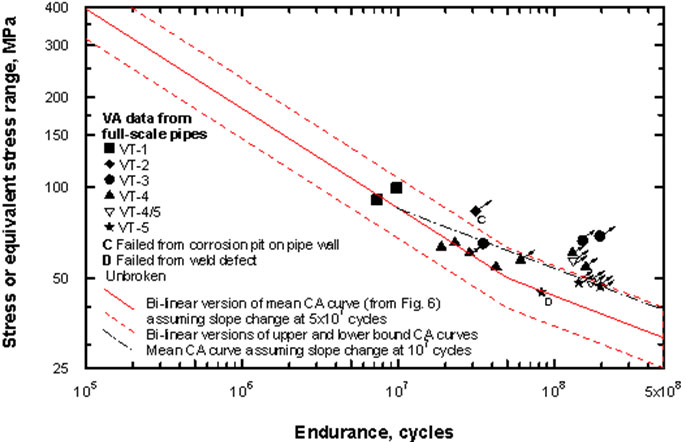

The VA test results obtained from full-scale pipes were analysed in terms of both Miner's sums and, for graphical presentation, the equivalent constant amplitude stress range, ΔSeq. For a particular endurance, ΔSeq is the constant amplitude stress range which, according to Miner's linear cumulative damage rule, is equivalent in terms of fatigue damage to the VA stress spectrum. It relates to the constant amplitude S-N curve for the detail under consideration, ΔSmN = A (a constant), as follows:
Eqn 2
Eqn 2
where m is the slope of the relevant S-N curve, i.e. 3 in the present case, and ΔSi is the stress range that is applied ni times in a spectrum. Note that (Σni) is the spectrum block length Nb. It may be noted that ΔSeq values below, on or above the CA S-N curve correspond to Σ(ni/Ni) values <1, =1 or >1, respectively.
An implicit assumption in Eq. [2] is that stresses below the CAFL are as damaging as implied by the S-N curve extrapolated beyond the CAFL at the same slope. However, it is common practice to assume that they are less damaging by adopting a bi-linear S-N curve with a slope change from m to m+2 at the CAFL. As noted above, BS7608 assumes that the CAFL is the stress range corresponding to N=107 cycles, but the present full-scale pipes suggest a lower value, corresponding to N=5x107 cycles. To allow for this, ΔSeq was also calculated using the bi-linear S-N curve for which the slope changed from m=3 to m=5 at 5x107, on the basis of the equivalent fatigue damage concept expressed below:
Eqn 3
Eqn 3
where m1 = 3 and m2 = 5. Selection of m and A on the right hand side depends on whether Seq is above or below the slope transition point in the S-N curve. The left hand side of the equation is the sum of the fatigue damage ratios due to stresses above (subscript 1) and below the fatigue limit (subscript 2), respectively. Parameters A1 and A2 correspond to the S-N curve above and below the fatigue limit, respectively.
The VA results obtained from full-scale pipes are summarised in Table 2. This includes the sub-spectrum used, its block length, the fatigue endurance, in terms of number of cycles and number of blocks, and the calculated Miner's sum Σ(n/N). The mean S-N curve for the full-scale pipes, ΔS3N=6.174x1012, was used to calculate N. However, two values of Σ(n/N) are given, one based on N values derived from the S-N curve extrapolated beyond the CAFL without a slope change and the other for N derived from the bi-linear S-N curve that changed slope from m=3 to 5 at N=5x107 cycles, for stress ranges below 49.8MPa. The results are also presented in Figure 7 in comparison with the CA results, with ΔSeq calculated using Eq.[3].
Figure 7. Comparison of variable amplitude test results for the full-scale pipes with bi-linear versions of constant amplitude S-N curves, with VA data presented in terms of equivalent stress range calculated using a bi-linear S-N curve with slope ch
Figure 7. Comparison of variable amplitude test results for the full-scale pipes with bi-linear versions of constant amplitude S-N curves, with VA data presented in terms of equivalent stress range calculated using a bi-linear S-N curve with slope change from 3.0 to 5.0 at 5x107 cycles.

Referring to Table 2, it will be seen that Σ(ni/Ni) depends on the sub spectrum. It varied from 0.78 to 1.59 for pipes that failed under the spectra with a minimum stress range ≥50MPa (VT-1 to VT-4),. However, as seen in Figure 7, these values correspond to fatigue strengths that are within the range expected considering the scatter in the CA data. Thus, Miner's rule can be considered to be accurate for these sub-spectra. However, it may be noted that this would not be true if the slope change in the CA S-N curve was assumed to correspond to N=107 cycles, as indicated in Figure 7, thus further confirming that the current design approach of locating the slope change at 107 cycles is non-conservative. Miner's rule proved to be conservative for spectra with the minimum stress range <50MPa (VT-4/5 and VT-5), with eight out of nine welds being unbroken after endurances considerably more than predicted by Miner's rule (Σ(ni/Ni) > 1).
Attention is drawn to two tests that gave results that were not consistent with the others. Pipe S28 failed from a corrosion pit on the inside of the pipe with no evidence of fatigue cracking from the weld root. Although the weld root bead profile was good it was no better than that in other welds that did fail from the root. Thus, its exceptionally long life could not be explained. In contrast, it was clear that the single pipe failure under VT-5 (pipe S30) occurred because the fatigue crack initiated at a 0.65mm deep lack of fusion defect at the weld root.
Since two full-scale pipes tested under CA loading ran-out at 108 cycles, another possibility is to introduce a slope change at this endurance. Although not shown here, the ΔSeq values corresponding to this bi-linear S-N curve were also calculated. Similar to Figure 7, the ΔSeq values were also compared with the CA S-N curve with a slope change at 108 cycles. It was found that all the VA data for endurances greater than 2x107 cycles were above the mean curve, while those for endurances greater than 108 cycles were above the upper bound S-N curve. In view of this, it is considered that the case for adopting the slope change at 108 cycles, rather than 5x107 cycles, is not strong and is unduly conservative. Meanwhile, using the slope change at 108 cycles is clearly the more conservative of the two approaches and so it might be considered preferable for particularly critical cases.

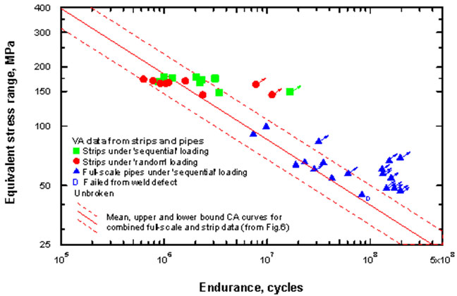

Fourteen strip specimens were tested under sub-spectrum VT-2 and four under spectrum VT-3, half under the sequential version of the spectrum and half under random loading. The results are presented in Figure 8 in terms of ΔSeq, calculated using Eq.[2]. No attempt was made to use Eq.[3], with a bi-linear S-N curve, because although the CAFL was not well defined it appeared as if all stress ranges in VT-2 and VT-3 were above it. Figure 8 also shows the results obtained under sequential loading from the full-scale pipes and the S-N curves based on the combined CA data from full-scale pipes and strips. Although not conclusive, it appears that the random loading was the more damaging, with most of the results lying below the mean CA S-N curve while most sequential loading results were above it. Although there is no overlap of the results from failed specimens it will be evident that the VA data from both the strips and full-scale pipes follow the CA S-N curve. It will also be evident that apart from one of the results for failure under the sequential loading and three run-outs, which were all beyond the upper bound of the CA scatter-band, all the VA data from strip specimens are within the CA scatter-band. This suggests that Miner's cumulative damage rule was reasonably accurate for calculating the fatigue lives of the strip specimens under VA loading, as was found for the full-scale pipes tested under sub-spectra with all stress ranges above the CAFL.
The relatively large scatter in the strip specimen results in Figure 8 probably reflects variations in the weld root bead profiles. However, it was observed that two strip specimens extracted from the same original girth weld had very similar relatively poor profiles, with both a hi-lo and WRBH of about 0.45mm. One was tested under the sequential version of VT-2 and the other under random loading. This provided a good opportunity to investigate the effect of loading sequence independently of a possible effect of a difference in weld root bead profile. The life obtained under sequential loading was ~1.3 times greater than that obtained under random loading.
Figure 8. Variable amplitude fatigue data obtained from full-scale pipes and strip specimens illustrating effect of loading sequence ('sequential' or 'random') on fatigue performance.
It was also apparent that weld root bead profile was significant in the welds tested under VT-3. Only two of the four failed, the unbroken welds surviving for lives more than 5 times those predicted by Miner's rule. Both had exceptionally good profiles, as indeed did the single unbroken weld tested under VT-2, with both the hi-lo and WRBH being less than 0.1mm. However, it is probably also significant in the case of VT-3 that stresses below 140MPa are unlikely to be as damaging as implied by the CA S-N curve in the region close to the CAFL.

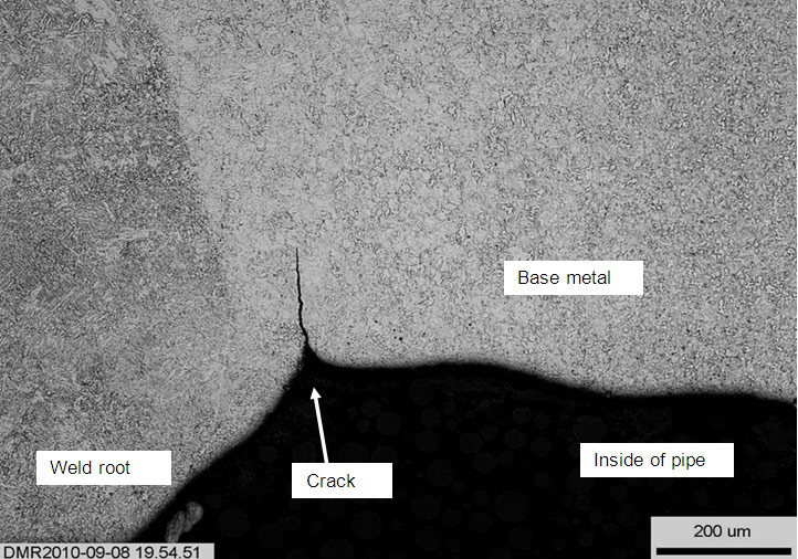

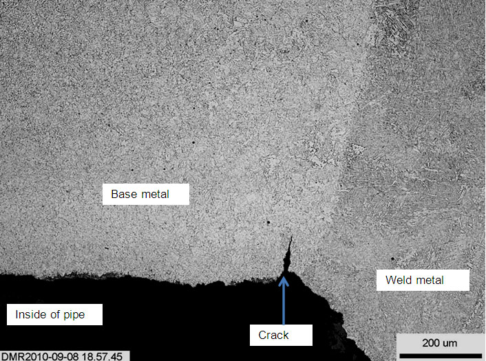

Pipe S12, which contained two welds and was tested under CA loading, was unbroken after 108 cycles. No fatigue cracking was found at the weld start position in weld W1, but a 0.14mm deep weld root crack was found at the weld stop position, where the WRBH was 0.25mm, Figure 9(a). Two sections from weld W2 of pipe S12 did not reveal any indication of fatigue cracking. One of these sections was made at the position with the poorest weld root bead profile (WRBH and hi-lo of 0.47mm), Figure 9(b).
(a) Weld W1, showing a 0.14mm deep crack at the toe of the weld root bead
Figure 9. Macro-sections of the two welds in pipe S12 after being tested under CA loading for 108 cycles:
(a) Weld W1, showing a 0.14mm deep crack at the toe of the weld root bead;
(b) Weld W2, with no evidence of cracking in the region of poorest profile (WRBH= 0.47mm). The definitions for hi-lo and WRBH are shown in the figure

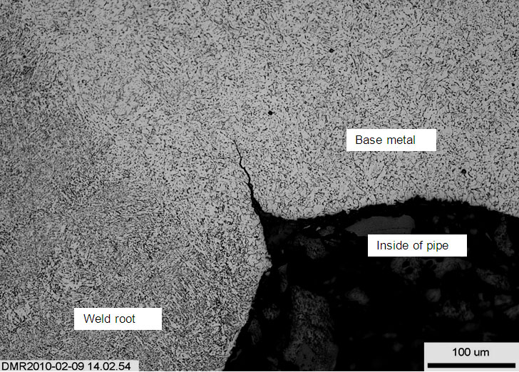

Both weld W1 and 2 of pipe S15, tested under sub-spectrum VT-5, were unbroken after 1.96x108 cycles but macro-sections revealed fatigue cracking from the weld root bead toe in both. Two cracks were found in W1, one just 67µm deep at the weld start position but the other 0.19mm deep at the weld stop position, Figure 10. A section of W2 at a location away from the weld start/stop positions but where the WRBH was 0.58mm revealed a 93µm deep crack, Figure 11. Therefore, the remaining endurances of the two welds were significant even though their Miner's sums were already respectively greater than 2.8 and 3.1 (assuming a bi-linear S-N curve with a slope change from 3 to 5 at 5x107 cycles).
(a) W1 weld, 0.19mm deep crack
Figure 10. Macro-sections of the two welds in pipe S15 after being tested under VA-5 loading (minimum stress range of 40MPa) for 1.96x108 cycles, showing fatigue cracking at the toe of weld root bead:
(a) W1 weld, 0.19mm deep crack;
(b) W2 weld, 93µm deep crack that initiated in a region of poor profile (WRBH = 0.58mm)

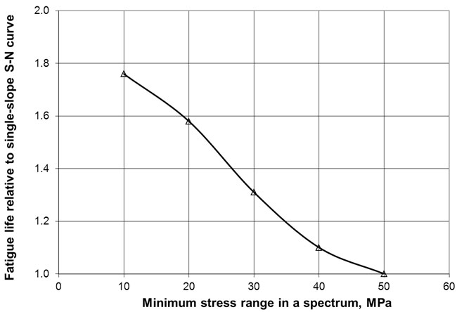

Figure 11. Dependence of the ratio of the calculated fatigue life based on a bi-linear S-N curve to that based on a single slope S-N curve on the minimum stress range in the applied loading spectrum

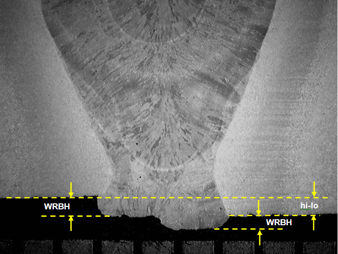

In the present context, it seems that the best indication of a poor weld root bead profile is the combined weld root hi-lo and WRBH, especially the former. Not only does this lead to a sharp corner, and hence more severe stress concentration than would arise from a smooth transition from pipe to weld surface, but any associated axial misalignment would increase the local stress by introducing secondary shell bending. From the practical viewpoint, this highlights the importance of achieving as near perfect inner pipe wall alignment as possible when making girth welds. If perfect alignment between pipe wall surfaces cannot be achieved due, for example, to a difference in the wall thicknesses of the pipes, it would be preferable to place the thickness transition on the outside where the weld toe stress concentration is less severe and can be reduced by flush grinding the weld cap to achieve a smooth transition. This approach is recommended in [DNV 2010].
Although it is unquestionable that weld root bead profile has a significant influence on the fatigue performance of girth welds, other factors may also play a part. This was evident from the fact that in some girth welds the worst weld root profile was not always at the weld start or stop position. However, major cracking still occurred at the weld start/stop positions. Other possible key factors could be welding imperfections and residual stresses.

6.3 Comparison of the fatigue performance of full-scale pipes and strip specimens cut from pipes
The fatigue performance of the present strip specimens was comparable with that of the full-scale pipes at high applied stress ranges but superior at low (stress ranges ≤~120MPa), even when the strip specimens were tested under very high tensile mean stress conditions. This finding was in agreement with the results in previous work by the present authors [Maddox and Zhang, 2008] but at odds with the claim that fatigue data from strip specimens can be correlated well with those from full-scale pipes as long as the strip specimens are tested under high tensile mean stress conditions to compensate for the loss of tensile residual stresses (Salama, 1999). It is recalled that one strip specimen, with a poor weld root bead profile (WRBH=0.48mm), was deliberately chosen for the CA fatigue test at a nominal stress range of 110MPa. Although several strip specimens ran out at 120MPa under a high tensile mean stress, this specimen failed, with an endurance close to the lower bound to the combined strip specimens and full-scale pipe data, Figure 6. Clearly, the weld root bead profile of the strip specimens also has a very significant effect on the difference in fatigue performance between the strip specimens and full-scale pipes in the long-life regime.
At high applied stresses, crack initiation would be easier and the fatigue life would be dominated by fatigue crack growth. As a result, the fatigue endurance would not be so sensitive to the weld root bead profile and the fatigue performance of the strip specimens would be comparable with that of the pipes, as seen in the present project. Therefore, when strip specimens have to be used to characterise the fatigue performance of full-scale girth welded pipes and the weld root bead profile of these strip specimens is favourable when compared to the worst profile of a full-scale weld, they should be tested under fully tensile high applied stress ranges where fatigue life is dominated by fatigue crack growth.
6.4 VA results from full-scale pipes and validity of Miner's rule
The VA test results obtained from the full-scale pipes (Table 2) indicate that, for the basic spectrum used, Miner's rule is reasonably accurate if the minimum stress range ≥50MPa (sub-spectra VT-1, VT-2, VT-3 and VT-4). The results obtained under sub-spectra VT-3 and VT-4 were the most widely scattered, with many welds remaining unbroken. However, this is not surprising since the fatigue damage in these spectra came mainly from stress ranges that correspond to the transition regime as the CA data approach the fatigue limit, where the CA data are also widely scattered. It will be noted that the choice of S-N beyond the CAFL, extrapolation with or without a slope change, had little or no effect on the life calculated by Miner's rule. This is reasonable since all applied stress ranges were above the estimated CAFL. However, this is not the case using a bi-linear S-N curve with the slope change at 107 cycles, as currently recommended in many design rules. The S-N curve would then be as shown in Figure 7. Although the ΔSeq values corresponding to this S-N curve are not shown, they would be either the same (tested under higher minimum stresses) or lower (tested under lower minimum stresses) than those obtained for a S-N curve with a slope change at 5x107 cycles. Since many of the data points already lie below the mean S-N curve with a slope change at 107 cycles, the current design approach of locating the slope change at 107 cycles would be non-conservative.
Sub-spectra VT-4/5 and VT-5 included stress ranges down to 45MPa. Consequently, shorter lives were estimated assuming the bi-linear rather than single-slope S-N curve. However, these were still considerably shorter than the actual endurances suggesting that stress ranges below the estimated CAFL are less damaging than implied by the bi-linear S-N curve with the slope change at 5x107 cycles. Again referring to Figure 7 the same may not be the case for a slope change at 107 cycles; ideally more data, especially from welds that fail, are required to confirm this. Meanwhile, noting from Figure 7 that the data obtained under sub-spectra VT-4/5 and VT-5 are clearly biased above the bi-linear S-N curve slope change at 5x107 cycles, it seems reasonable to adopt bi-linear CA S-N curves with the slope change at 5x107 cycles as a safe but not unduly conservative approach for cumulative damage calculations. The one factor that might be seen to contradict this conclusion is the test result obtained from pipe S30 under VT-5. This failed at a lower Seq value than the deduced CAFL as a result of a 0.65mm deep weld root defect. If inspection of girth welds for offshore pipelines cannot be relied upon to detect such small defects it would clearly be prudent to adopt a lower CAFL, corresponding to N closer to 108 cycles.
6.5 Effect of loading sequence
The VA test results from the strip specimens appear to indicate that random loading was more damaging than the sequential loading used for testing the full-scale pipes. A comparison of the fatigue endurances between two specimens with similar weld root bead profiles suggested that the fatigue endurance under sequential loading was about 1.3 times longer than that obtained under random loading.
In terms of the impact of these findings on the fatigue design of SCRs, it should be born in mind that the random sequence was an artificial one. It was not based on actual observations of the sequence actually experienced by risers but simply randomisation of the stress spectrum. In practice, SCRs may not see such a sequence. Indeed, it could be argued that, although actual SCRs may experience random loads, the stress changes would be gradual as they are controlled by environmental loading. Then the random loading sequence used in the present tests may not be truly representative and the deduced life reduction factor may be too high. However, if actual SCRs do experience such random loading or when it is uncertain, it would be prudent to apply a life reduction factor of 1.3 to account for the possible loading sequence effect.
6.6 Implication of current results to fatigue design of girth welds
The fatigue test results obtained from the girth welds tested under sub-spectra with different minimum stress ranges were assessed by Miner's rule using two different CA S-N curves, one with no slope change and the other a bi-linear curve with a slope change from 3 to 5 at 5x107 cycles (the assumed CAFL). From Table 2, it will be seen that the introduction of a slope change from 3 to 5 at 5x107 cycles made little difference to the Miner's sums for sub-spectra VT-1 to VT-3. The effect was small for sub-spectrum VT-4 and increased for sub-spectra VT-4/5 and VT-5. The results indicated that it would be over-conservative to adopt a single-slope S-N curve in design for loading spectra with minimum stress ranges <50MPa. Assessments based on a bi-linear S-N curve were more accurate, although introduction of the slope change at 107 cycles, as currently recommended in many design rules, would be potentially unsafe. A slope change in the S-N curve is also in compliance with the possibility that the proportion of life spent initiating a fatigue crack becomes more significant in the long endurance regime, hence producing a shallower S-N curve.
As an illustration of the benefit of adopting a bi-linear S-N curve, Figure 11 shows the variation in ratio of fatigue life calculated using Miner's rule in conjunction with a bi-linear S-N curve, with the slope change at 5x107 cycles, and that obtained using a single slope curve for each sub-spectrum. It will be seen that the relative fatigue endurances increase with decreasing minimum stress range in the spectrum. Thus, adoption of the bi-linear curve justifies a significant increase in estimated fatigue design life, or corresponding increase in allowable stress range, when compared with that estimated on the basis of a single-slope S-N curve. For example, for a loading spectrum with a linear stress distribution and a minimum nominal applied stress range of 10MPa, the calculated design fatigue life can be increased by a factor of 1.76 using the bi linear S-N curve.
Although the recommendation to retain the bi-linear S-N curve approach for cumulative damage calculations remains, the case of failure from an undetected 0.65mm deep weld root defect in pipe S30 mentioned earlier leaves a question mark over the choice of the point at which the slope change should be introduced. If inspection of girth welds for offshore pipelines cannot be relied upon to detect such small defects it would clearly be prudent to extend the S-N curve to perhaps 108 cycles before the slope change.
One outcome from the failure of pipe S30 from a defect that could be seen as positive is that it provides an indication of the acceptance level for weld root defects in girth welds. As seen in Figure 7, the test result agreed very closely with the mean S-N curve obtained from defect-free welds which itself was above the Class D mean curve. Clearly further confirmation is needed from fatigue tests over a wide range of applied stress levels but, at this stage, it appears possible that Class D, but even more certainly Class E, fatigue performance could be achieved from girth welds with root defects approaching 1mm in depth. At the same time it would have to be recognised that it may be necessary to assume a lower CAFL than that for defect-free welds.

  1. Establish the constant amplitude S-N curve using strip specimens extracted from representative girth welds in the pipe of interest.

With respect to the fatigue tests, the strip specimens should be selected to include the worst weld root bead profiles (highest hi-lo and WRBH) found in the actual girth welds, they should be conducted under fully tensile loading, preferably at a high tensile mean stress, and they should utilise spectra that contain only stress ranges that are well above the apparent CAFL.

  6. The fatigue performance of the girth welds was strongly influenced by the weld root bead profile. The weld root bead height (WRBH) and hi-lo, sources of stress concentration and secondary bending, were identified as significant indicators of fatigue performance.
