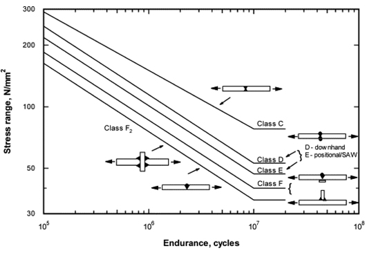

The fatigue performance of a given girth weld is then rated against the fatigue design curves, these curves originated from TWI over 3 decades ago. They were based on data obtained from welded plates in different configurations, with the butt weld data coming from specimens with double sided welds. These design curves were subsequently adopted by many standards including DEn (HSE), and DNV (Figures 1 and 2).
Figure 1. Fatigue design curves used for girth welds

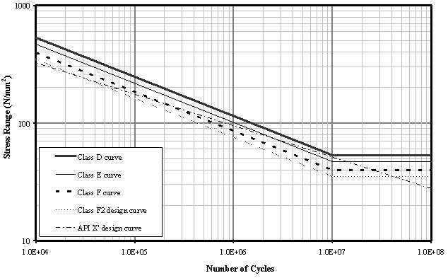

Figure 2. Current fatigue design S-N curves (BS7608 classifications) for girth welds compared with some fillet welds.

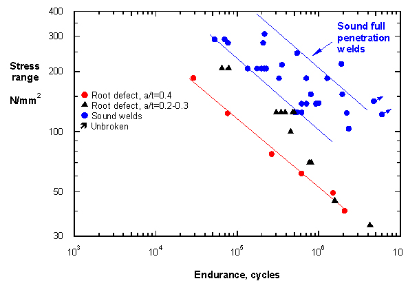

Welding process
In general the welding process does not affect fatigue performance, but depending on the likely location for a fatigue initiation site, the quality of the weld, in terms of presence of flaws, would be expected to affect the fatigue life. Fatigue of seamless riser pipes usually initiates at the root, therefore the quality in terms of bead height; re-entrant angle at the toe and presence of planar defects such as lack of penetration or sidewall fusion significantly affects fatigue.[6] Figure 3 illustrates the effect of root quality on fatigue performance although presence of such flaws in a production girth weld is very unlikely and the figure is purely for illustration purposes. GTAW usually gives good root quality but it has a low productivity so it can be used for the root pass while the weld is completed using SMAW or GMAW.[7] Another attractive process is mechanised narrow groove GMAW made on copper backing shoes on the pipe ID.
Figure 3. Effect of root quality on fatigue performance
Referring to Figure 2 it can be seen that single-sided welds made on permanent backing are given Class F while those made without backing are classed as F2 due to concerns over joint misalignment and poor weld root condition. This choice is not based on actual fatigue test data and could be over-conservative for situations in which full penetration welds with favourable root geometries can be guaranteed[8,9] (e.g. those produced using modern, mechanised pipe welding). Recent research suggested that it is possible to achieve Class E curve when allowance for misalignment is made in the calculation of the relevant stress range and hi-lo is controlled within 0.5mm.[10] TWI is currently undertaking a study to establish which of the current curves are most applicable based on the results of more than 2000 full-scale tests.

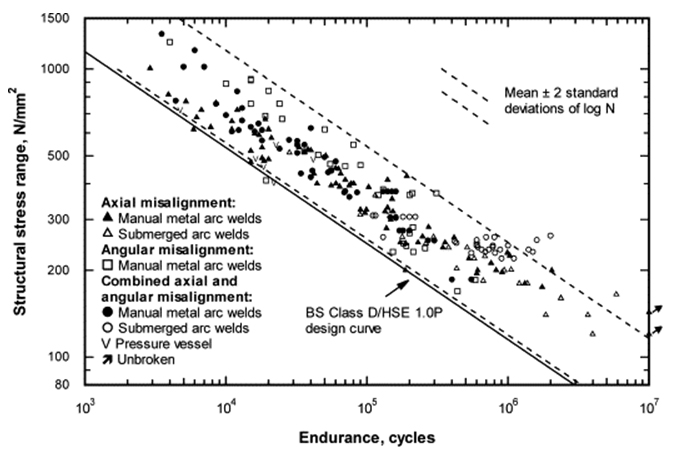

Fatigue data from studies of the effects of intentional misalignment in butt-welded plates are presented in Figure 4. [11]
Figure 4. Review of fatigue data obtained from transverse butt welds allowing for misalignment.
To achieve the desired fatigue life in a riser, high quality welds with minimal amounts of misalignment are necessary but not sufficient; the other most important requirement is a high quality inspection in terms of reliability, resolution and probability of detection.

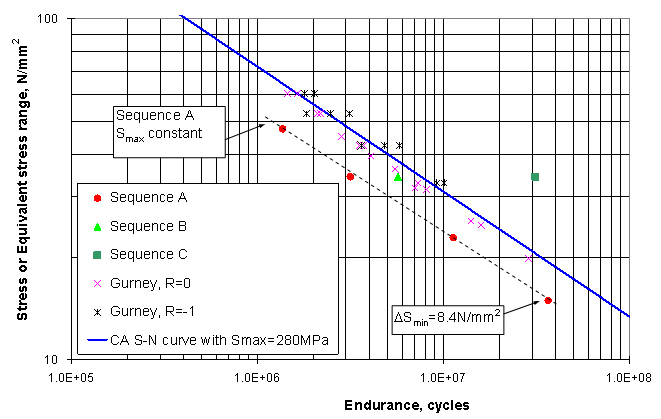

In terms of in service loading Miner's rule is generally used to estimate the accumulated damage due to different loadings in a variable amplitude (VA) spectrum and the fatigue performance is satisfactory if Σn/N ≥1. However recent work[18] has shown that when stress cycling down from a high tensile stress as illustrated in Figure 5 (sequence A: cycling down from a constant max stress) Miner's rule is not conservative enough. However when stresses cycle up from a constant minimum stress (sequence C: increase mean stress with increasing stress range) Miner's rule is conservative and cycling about a constant tensile mean stress gives slightly non-conservative results (Sequence B). Therefore Miner's rule is deemed non-conservative under certain loading conditions particularly when higher stresses are followed by lower stresses in a spectrum (variation in applied mean or maximum stress are of secondary importance to stress sequence). [18]
Figure 5. Comparison of variable amplitude test results with the constant amplitude S-N curve expressed in terms of the equivalent stress range. [18]

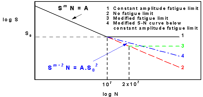

From a practical viewpoint, the nature of the fatigue loading on risers is such that fatigue in the low stress regime of the S-N curve is dominant, however once a crack is initiated under larger stresses then even stresses below constant amplitude fatigue limit (CAFL) will become damaging.[19]
Therefore an assumption is made when dealing with low stresses to either using a lower band bi-linear S-N curve with a change of slope form m to m+2 or extrapolating the constant amplitude SN curve with no fatigue limit as illustrated in Figure 6. Currently significant research is under way at TWI using full scale testing under representative conditions to quantify the effects of VA and VIV on fatigue performance of girth welds in air.
Figure 6. Fatigue design curves for variable amplitude loading

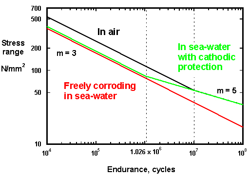

Seawater
Extensive fatigue endurance and crack growth data for carbon steels in seawater have led to comprehensive design guidance. However, most experience is confined to North Sea wave loading conditions (water temperature of around 5°C and a cycling frequency of 0.15-0.5Hz).[23] As shown in Figure 7 in air performance can be restored by cathodic protection in seawater only at low stresses and there is no benefit at higher stresses. Indeed, cathodic protection might even be more harmful than free corrosion at high stresses due to hydrogen embrittlement, especially in high-strength steels. In general the fatigue lives of welded joints are reduced in seawater, with or without cathodic protection by a factor of three at high stresses, at 5°C and even more at higher temperatures. [23]
Figure 7. Examples of design S-N curves for steel welded joints operating in seawater. [23]

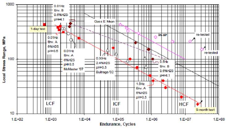

Sour (H2S-containing) environments
The effect of sour environments at relatively low temperatures, and even at relatively low H2S concentrations is very significant, when compared to performance in air, with degradation factors on life of between 10 and 100.[27] Combined high cycle fatigue (HCF) and low cycle fatigue (LCF) data from in Figure 8[27], suggests that the use of a straight line S-N curve for sour conditions represents a reasonably conservative assumption for design. Further qualification testing could then be conducted in the more practical intermediate-cycle fatigue (ICF) regime. There is only a limited amount of data applicable to flowlines in sour environment available in the public domain,[28] although unpublished data exists for many candidate SCR materials under various service conditions as a result of several TWI joint industry projects.
Sour service results in significant hydrogen charging of steel, and hardness is likely to be the dominant materials parameter; at least for C-Mn steels, but local grain size and composition may also be significant in corrosion fatigue of CRAs.[22] The detrimental effect of H2S increases with increase in ΔK, applied stress ratio and decrease in cycling frequency. [24,25,26]
Figure 8. Sour endurance data for HCF and LCF. [27]

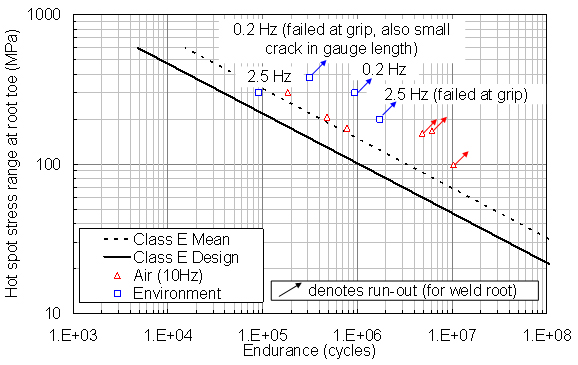

Sweet (CO2-containing) environments
In these conditions, the corrosion fatigue crack extension mechanism is primarily due to anodic dissolution of the crack tip and is significantly influenced by the precise environmental conditions. It has been shown[29] that under very highly corrosive conditions, in which no protective scale was developed, fatigue endurance may be increased, and this was explained in terms of a competition between fatigue crack growth, and removal of the damaged material by corrosion. However if the balance of fatigue and corrosion conditions is changed, acceleration of fatigue can be observed (Figure 9). Thus, in these environments it is important to ensure that the scaling conditions are correctly modelled, and that the effects of inhibitors are taken into account. Scaling conditions with and without inhibiter are currently under investigation at TWI. There is limited evidence to suggest that the presence of inhibitor reduced crack growth rate in one particular sweet environment.[29] However it was only effective at low K and only if present prior to any significant pre-corrosion.
Figure 9. Fatigue endurance test data for an API 5L X65 material in pH of approximately 4.5 at 60°C. [29]
