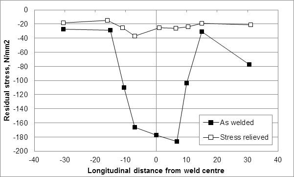

3.3 Residual Stress Measurements
The residual stress measurements in the as-welded and stress-relieved specimens are reported in Tables 2 and 3. They are plotted in Fig.5 and Fig.6, for the axial and circumferential components, respectively.
Figure 5 Residual stress measurements in the axial direction (ie perpendicular to the weld) obtained from stress relieved and as-welded specimens
Figure 6 Residual stress measurements in the circumferential direction (ie parallel to the weld) obtained from stress relieved and as-welded specimens
As the centre of the weld (i.e. at the centre of the bar) cools last it might reasonably be expected that that region would contain tensile residual stresses. Hence, the surface residual stresses associated with the friction weld would be expected to be compressive.
It is noteworthy that all the stress data reported in Fig.5 and Fig.6 were compressive. Of particular interest here is the magnitude of the axial residual stress near the weld, which are perpendicular to the plane of the fatigue cracks (see Fig.7c) thus influence their behavior.

Not surprisingly, the largest axial residual stresses were measured near the weld in the as-welded condition, with a maximum of approximately -200N/ mm2. Elsewhere on the surface of the parent bar away from the weld, compressive residual stresses were smaller, but still significant.
Stress relief by PWHT did not eliminate the residual stresses completely: small compressive residual stresses remained in the welded region and on the surface of the parent bar, near the weld. This was true of both the axial and circumferential components.
Flash removal did not appear to have a consistent effect on the distribution of residual stresses. In any case flash removal is not expected to alter significantly the residual stresses away from the welded region. The asymmetry of the “flash removed” and “with flash” data near the weld in Fig.5 and Fig.6 can be explained in terms of the expected scatter in measurements of this kind.
It is also interesting that compressive residual stresses of the order of -200N/ mm2 in the circumferential direction and ‑80N/ mm2 in the axial direction were measured some 30mm from the weld centerline on the side with the flash intact, representing the as welded condition. Bearing in mind that the welding residual stresses are expected to decline fairly rapidly away from the weld so the measured compressive stresses in this specimen may well be, at least partly, due to other reasons, e.g. reeling.
The influence of the compressive surface residual stress on the fatigue strength of the friction welded joints is considered in the next section.

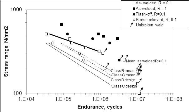

3.4 Fatigue Performance
The results of the fatigue tests are given in Tables 4, 5 and 6. They are also plotted in the form of an S-N diagram in Fig.8 where the mean and design lines corresponding to BS7608 Class B and C are also shown for comparison.
In all the specimens with flash intact (whether as-welded or stress-relieved) which failed in the welded area the fatigue cracks initiated on the surface at the edge of the weld, as indicated in Fig.7. In the specimens tested after flash removal it is not easy to determine the precise location of the fatigue initiation site, with respect to the original weld.
The stress range plotted in Fig. 8 is the nominal stress obtained by dividing the applied load by the measured cross-sectional area of the bar away from the welded joint. In practice some misalignment may exist between the two bars which would give rise to secondary bending stresses in the vicinity of the joint, even if the external load were applied axially. In the work reported here secondary effects might be expected to show as scatter in the fatigue results. Therefore it is encouraging that the specimens exhibited relatively little scatter. This is consistent with relatively small axial misalignment measured in the specimens with flash removed, and suggests that it may be feasible to achieve almost perfect alignment in friction welded components.
Figure 8 Fatigue test results from friction welded rod-to-rod connections
Regression analysis on the results obtained from the as-welded specimens at R=0.1 which failed results in a slope (m) of 6.46, an intercept (Log C) of 22.13 and a standard deviation of 0.143. This is considerably shallower than the S-N curve for Class B. Some of the  specimens remained unbroken after 107 cycles at stress ranges up to 170N/ mm2. If a sufficient number of specimens could be tested to define the fatigue limit (defined here as that corresponding to 107 cycles), it may well be expected to exceed 170N/ mm2 for the particular welds tested here.
The test results were considerably better than could be reasonably expected of a similar joint produced by arc-welding. For instance, if a bar had been produced by full-penetration butt welding it would be assigned to Class D or E in BS 5400 Part 10 (the pre-cursor to BS7608), depending on the degree of control exercised during welding, welding position and weld process. By contrast, the data from the friction welds lie above the mean BS7608 Class B curve. With the shallow slope associated with the friction weld data, their superior performance compared with Class D increases as the applied stress range is reduced.
The shallow slope of the S-N curve for the friction welds is consistent with the presence of compressive residual stresses at the surface of the specimen in the weld region, where the fatigue cracks initiated. Additionally, it could be explained in terms of a significant initiation phase in the total fatigue life of the specimens. This would be in contrast with typical arc-welded joints where, even in welds of acceptable quality, it is reasonable to expect crack-like discontinuities such as slag intrusions, undercut, etc. at the toe (Signes et al., 1967). The presence of these initial flaws in arc-welded joints essentially removes any significant crack initiation phase and the majority of fatigue life is occupied in crack propagation.
Further studies, including micro-sectioning and examination under high magnification are required to investigate the presence, or otherwise, of non-metallic initial flaws in friction welded bars. This might determine whether the shallow slope of the S-N curve can be attributed, at least in part, to the presence of a significant initiation phase.
To demonstrate the effect of residual stresses more clearly, a group of seven specimens was fatigue tested after stress relief by PWHT. As expected, by reducing the beneficial i.e. compressive residual stress, the fatigue strength of the specimen was adversely affected. The reduction in fatigue strength was particularly noticeable at the lower stress ranges. For instance at 300N/ mm2, an as-welded specimen had remained unbroken after nearly 1.2 x 106 cycles, whereas a stress relieved specimen failed after less than 300,000 cycles. The results suggest that Class C might be the relevant design curve for stress relieved joints, but further tests are required to confirm that.
The presence of beneficial residual stresses, some of which may be due to reeling, and the favourable weld quality featuring in the test programme highlighted the need to exercise caution when using data reported here as a basis for the design of friction welds. Further data, particularly including less favourable, although realistic friction welds are needed before any firm design guidance can be formulated.
The effect of stress ratio is also shown in Fig. 8. Although the number of tests is limited, a clear pattern is demonstrated, with results obtained under fully reversed loading appearing significantly stronger than those obtained at R= 0.1. This is consistent with the fact that, with all other factors such as residual stress, etc. being the same, a smaller proportion of the applied loading is tensile (and thus damaging) at R= -1.
The flash produced during friction welding is not always removed in practice. However, there are cases where flash is removed despite the extra effort, and cost, involved. For instance, in some applications this is done in an attempt to reduce the risk of corrosion by eliminating the crevice-like geometry associated with the flash. In others flash removal is undertaken prior to post weld heat treatment, or merely for aesthetic reasons. Regarding the effect of flash removal on fatigue, the data so far suggests that it is beneficial giving improvement to fatigue strength. This is not surprising, as the discontinuity at the edge of the flash in an as-welded specimen acts as a source of stress concentration. The extent of improvement appears to increase at lower stress ranges. However, more data are required to establish whether the fatigue enhancement can be achieved consistently. In particular, if the as-welded specimens include large axial misalignments, the “ridge” effect, described above will be magnified after flash removal and may well act as a fatigue initiation sight. More work is required to clarify this issue.

The fatigue strength of friction welded steel bars was investigated. The weld parameters were selected in order to ensure quality on the basis of visual examination, bend tests, hardness surveys and tensile testing. The work has led to the following conclusions:
  1. The fatigue test results obtained from as-welded specimens at R=0.1 exhibited little scatter, and specimens remained unbroken after 107 cycles at stress ranges up to 170 N/ mm2. This is well in excess of the corresponding value for mean Class B in BS7608, which is 100 N/ mm2.
  2. The mean S-N curve representing the as-welded specimens tested at R=0.1 had a slope of 6.46, much shallower than that of Class B. The shallow S-N curve and high fatigue limit are consistent with the beneficial (i.e. compressive) residual stresses measured at the surface of the specimens near the weld.
  3. Stress relief by PWHT had a detrimental influence on fatigue strength. This is as expected and arises from the relaxation of beneficial compressive residual stress. The results obtained to date suggest that Class C might be the appropriate design curve.
  4. As-welded specimens tested under reversed loading (R=-1) had significantly higher fatigue strengths (stress range) than those tested at R=0.1.
  5. Limited results obtained to date suggest that flash removal increases fatigue strength. The extent of improvement increases with reduction in applied stress.

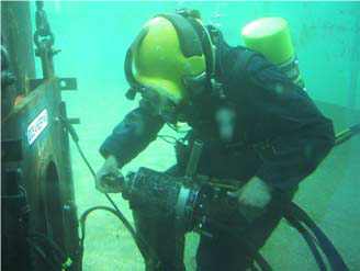

4. Friction welds made underwater
4.1 Offshore Friction Welding Systems
Friction welding equipment designed for use offshore is lighter and more compact than the static machines used in onshore manufacturing. The equipment used underwater is remotely operated by technicians on the surface and relies on divers or Remotely Operated Vehicles (ROVs) to position it (Blakemore, 2000). A clamp, consisting of either magnets, suction cups or a mechanical clamp is required to react against the axial force produced during friction welding (Fig. 9 and Fig. 10). The hydraulic power to the tool is either provided by the ROV or for diver operation from a hydraulic power pack on the surface via an umbilical.
Figure 9 Diver loading a stud into the HMS3000 friction welding tool prior to positioning it into a magnet clamp for friction welding underwater (after Hsu et al 2005)
Figure 10 – A manipulator arm on an ROV positioning the HMS3000 friction welding tool into a magnetic clamp during mobilisation tests

Table 2 Residual stresses measured in an as-welded specimen
Gauge numberCircumferential residual stress, N/ mm2Axial residual stress, N/ mm2Longitudinal distance from weld centre, x, mm
5 -207 -77 30.5
4 -168 -31 15
3 -109 -104 10
1 -47 -186 6.8
6 -54 -177 0
7 -85 -166 -7
8 -160 -110 -10.5
9 -170 -29 -15
10 -173 -27 -30.5
Table 3 Residual stresses measured in a stress relieved specimen
5 -33 -21 31
4 -26 -19 15
3 -29 -24 10.5
1 -15 -26 6.5
6 -18 -25 1
7 -26 -37 -7
8 -32 -25 -11
9 -26 -15 -16
10 -25 -18 -30.5

Table 4 Fatigue test results from the as-welded specimens
Applied stress range, N/ mm2Applied stress ratioEndurance, cyclesRemarks
510 0.1 34,180 Failed in the bar at the edge of the weld
450 0.1 149,500 Failed in the bar at the edge of the weld
400 0.1 170,190 Failed in the bar at the edge of the weld
350 0.1 407,100 Failed in the bar at the edge of the weld
320 0.1 959,540 Failed in the bar at the edge of the weld
300 0.1 1,183,810 Welds are unbroken after several failures in plain material within the gripped ends.
250 0.1 4,404,050 Welds are unbroken after several failures in plain material within the gripped ends.
170 0.1 10,023,320 Unbroken
130 0.1 10,459,900 Unbroken
100 0.1 11,447,210 Unbroken
660 -1 88,320 Failed in the bar at the edge of the weld
510 -1 889,620 Failed in the bar at the edge of the weld
480 -1 1,214,700 Welded are unbroken after several failures in plain material within the gripped ends.
450 -1 2,963,020 Welded are unbroken after several failures in plain material within the gripped ends.
Table 5 Fatigue test results from the specimens with flash removed
510 0.1 127,760 Failed in the welded area. Very slight misalignment. Dye penetrant inspection before testing did not show any indications.
450 0.1 619,400 Failed in the welded area. No detectable misalignment. Dye penetrant inspection before testing did not show any indications.
400 0.1 1,808,910 Failed in the welded area. Misalignment approx 0.5mm. Dye penetrant inspection before testing did not show any indications.
250 0.1 3,271,280 Welded are unbroken after several failures in plain material within the gripped ends. Up to 0.3mm axial misalignment near the weld. Dye penetrant inspection before testing did not show any indications.
Table 6 Fatigue test results from the stress relieved specimens
400 0.1 51,760 Failed in the bar at the edge of the weld
300 0.1 282,260 Failed in the bar at the edge of the weld
250 0.1 350,120 Failed in the bar at the edge of the weld
200 0.1 1,345,280 Failed in the bar at the edge of the weld
192 0.1 10,032,800 Unbroken
185 0.1 10,097,740 Unbroken
170 0.1 10,805,000 Unbroken
