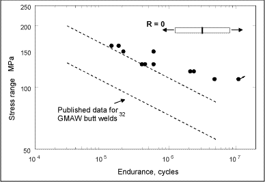

Most of the data used to derive design S-N curves were obtained from arc welded specimens. [16] Thus, there is the need to meet the growing demand for fatigue design data for other welding processes, such as electron beam, friction, laser and, for very thin sections, resistance welding. Some data are available for all these processes, chiefly for butt joints in the first three examples and lap joints in the last, and there is some justification for applying existing design data. [30] However, this might overlook extra benefit which could arise in some cases, notably friction stir welding ( Fig.4) and indeed TIG and plasma arc welds. [30]
Fig.4. Fatigue data obtained from friction-stir butt welds in 6mm 5083 aluminium alloy [30]
There is also scope for improving the existing design rules, which may have been influenced by a lack of data. A notable example is butt welds made from one side without backing. Most rules treat these with extreme caution to allow for the potentially poor weld root quality. However, recent tests on large scale tubes showed that one-side girth welds could match two-sided welds in terms of fatigue performance. [33]
