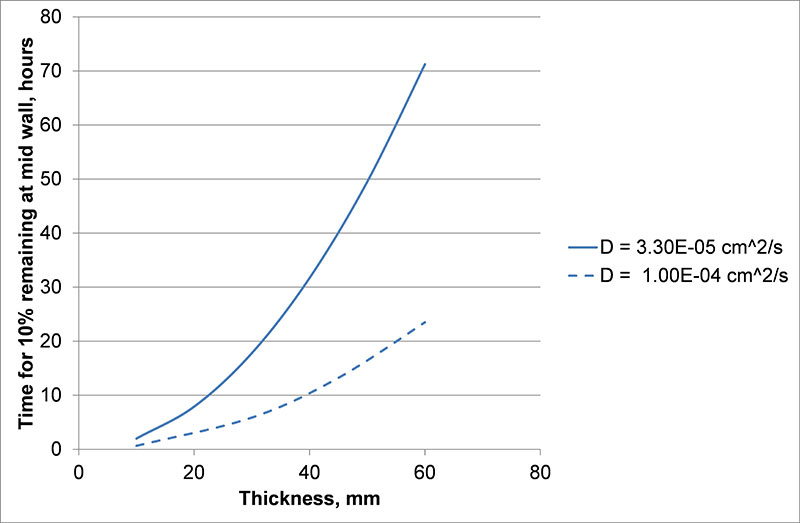

3. Control of cracking risk through Hydrogen bake-out
Although the usual response to hydrogen pick-up during service is to perform a bake-out or hydrogen release heat treatment prior to any welding, the required heat treatment conditions are not codified, and companies tend to have semi-empirical temperatures and times in their internal specifications. These often do not take proper account of the effects of thickness and temperature, and take no account of the initial hydrogen level or the range of diffusion coefficients in different steels. An indication of the effect of thickness is given in Figure 1, for the maximum and minimum of the scatter band of coefficient of diffusion at 300°C for ferritic steels given in Bailey et.al (5). Since welding is taking place on the surface of the steel, and a gradient in hydrogen concentration, with much lower concentrations near the surface, develops during bake-out heat treatment, the effect of thickness on times required to reduce the real risk of hydrogen effects during welding may be exaggerated, but cannot be ignored. Uncertainties due to differences in coefficient of diffusion between steels are however, accurately represented by this figure. Another factor which can make calculation of hydrogen bake-out conditions difficult is hydrogen trapping. Any hydrogen which is contained in deep traps, and in particular in molecular form in voids and blisters, has to escape from those traps before it can diffuse out of the steel. This is not taken into account in any diffusion based time/temperature calculations. Furthermore, any hydrogen which is not released by a relatively low temperature bake-out, may be released by the heat of welding and contribute to cracking risk. Overall, if hydrogen bake-out treatments are to be used, calculations based on remaining hydrogen at mid wall should give a reasonably conservative times, particularly for thick materials. If there is any indication of hydrogen blistering, hydrogen pressure induced cracking (variously known as HIC, HPIC, SWC) or stress oriented hydrogen induced cracking (SOHIC), then extended treatment and/or other precautions should be taken.
One way of managing bake-out treatments, which does not depend on a knowledge of materials diffusion properties or the level of hydrogen charging in service is to monitor the rate of effusion from the surface. Brown et al have published their experiences (6) which showed how the times required varied at different locations on a single vessel. In that paper, the bake-out was deemed complete when evolution (at 320°C) had reached <500pl.cm-2s-1, and in product literature (7), a value of 1000pl.cm-2s-1 is advised as a suitable end point for a bake-out. This is probably a conservative value, in that it essentially represents complete removal of hydrogen, whereas safe welding procedures could be devised and qualified for some intermediate hydrogen level, as discussed further below. A direct use of hydrogen effusion measurements during welding has been reported by Nicholas and Pargeter. (8). With any bake-out heat treatment which involves heating a local area, it should be remembered that hydrogen can feed into the area from material outside it. Thus, it is advisable to progress directly from bake-out to preheat to welding to PWHT (if required).

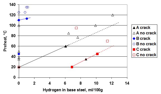

4. Control of Cracking Risk Through Preheat
In the work reported above (4), it was demonstrated that the additional risk of cracking resulting from quite severe hydrogen charging could be overcome by increasing preheat. A summary of the results is presented in Figure 2. It was advised that a preheat of 50°C, or 50°C in excess of that recommended by EN 1011-2, should provide adequate compensation for hydrogen picked up in sour service, provided the steel has CEIIW of ≤0.45%, and that welding is performed at ~0.8kJ/mm heat input with ≤ scale C consumables (ie hydrogen of ≤10ml/100g deposited metal). It is also advisable to increase precautions by using lower hydrogen consumables and higher heat input than assumed in designing the procedure, if possible.

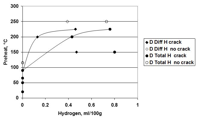

For the 2¼Cr 1Mo steel used in that work, the results are summarised in Figure 3. In that case the magnitude of the effect of only a small amount of hydrogen in the steel was found to be such that control through increased preheat is unlikely to be practical. It also means that bake-out needs to be very thorough, and probably supported by post heating, to encourage further hydrogen escape after completion of welding. As with C-Mn steels, any other hydrogen cracking precautions, and in particular good consumable hydrogen control are to be recommended.

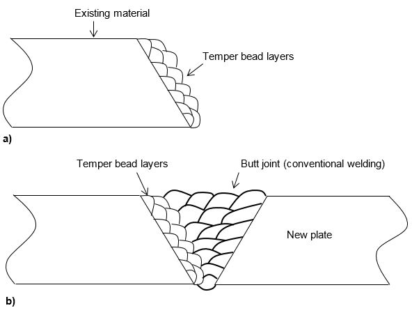

In general, it is helpful to carry out cutting and grinding operations before any hydrogen release heat treatment, as diffusion distances are then reduced. This is particularly relevant to deep excavations or cut-outs in thick plate.
Depending on the concentration of hydrogen within the steel and the steel composition, arc-air gouging prior to hydrogen release may lead to further cracking as hydrogen from the surrounding steel diffuses into the hardened HAZ of the gouge. Thus, this technique should be avoided if at all possible, and at least restricted to clean steels of low CEIIW (<0.43). In any case, where arc-air gouging is used, at least the final 5mm of material should be removed by grinding. For excavations of ≤ 15mm in depth it is advisable to use grinding for all of the excavation.
For excavation of grooves in CrMo material, it is suggested that all removal is by grinding in order to avoid creation of hard zones in hydrogen charged material. Following MPI, the surface of the groove should then be covered with two temper bead layers, with the body of the groove then being filled using a stringer bead technique.
Occasionally, areas containing multiple cracks may be found, and in this situation it may be necessary to cut out and replace the damaged area with new plate. In this case, the area round the cut line should be preheated prior to cutting then the cut surface immediately ground back by 3mm to remove hard zones in hydrogen charged material before they cool to a temperature at which hydrogen cracking may occur. A hydrogen bake out should then be carried out, as required. The prepared face can then be covered with two layers, following a temper bead approach, prior to fitting a new insert plate. Assuming that the vessel will be subjected to PWHT and the HAZ hardness kept below 248HV, it will not be necessary to temper bead the prepared face of the insert plate, and only the usual controls to avoid fabrication hydrogen cracking need be applied, see Figure 4.
7.3 Type of repair
Considering the defects and damage mechanisms that may be encountered, the main types are cracking, erosion and corrosion. Some of these defects may arise as a direct result of the equipment being in hydrogen service, eg SSC and corrosion of the weld and HAZ. Erosion may occur due to process flow conditions not directly linked to hydrogen service, but hydrogen may need to be taken into account when planning a weld repair. The details of repair will be largely dictated by the extent of the defect. For surface damage eg erosion/corrosion, it may be sufficient to apply two temper bead layers, whereas cracking will normally require a more extensive repair involving excavation of a groove to remove the crack.
Additionally, there are occasions where no damage has occurred to the vessel but there is a requirement to modify or alter the vessel. Although the vessel may be in good condition with no cracking or corrosion damage present, any modification involving welding should be approached in the same way as a defect repair.

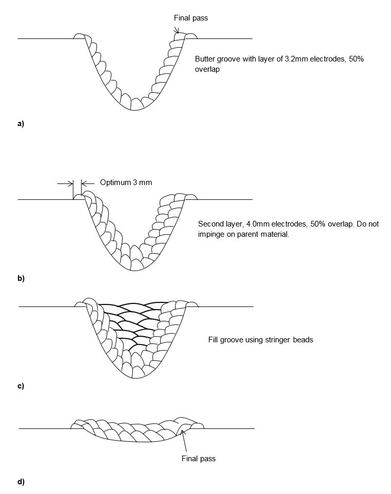

7.5 The Temper Bead Technique
The temper bead technique has long been used as a method of weld repairing PWHT vessels while avoiding PWHT of the repair. Applied correctly and assuming the use of SMAW/MMA process, the repair surface is covered by a layer of overlapping weld beads, laid so that each bead overlaps the previous one by 50%. A second layer is then deposited using the same technique, but at no point does layer two impinge on the parent metal. Layer one should be deposited with 3.2mm electrodes, layer two with 4.0mm, see Figure 5. This has the effect of tempering the HAZ in a way that replicates a conventional PWHT, and should, for a C-Mn steel, result in a HAZ microstructure and hardness that is resistant to cracking without any PWHT. This technique is presented as a means of hardness control (without the need for PWHT) in NACE SP0472-2008 (10), which does make specific reference to repair of ‘minor defects in cast, forged and plate components’. Furthermore, NBIC chapter III supplement 3 (13) allows use of temper bead repair, in place of PWHT after repair, without limit on section thickness. Nevertheless, although the temper bead technique is successful in reducing HAZ hardness and refining microstructure, it will not remove the residual stress arising from the repair weld. Furthermore, considerable care and QA are needed to ensure that no small hard regions remain, and just one could be sufficient to initiate cracking in service. Thus, in the authors’ opinion, if the temper bead approach is necessary, even if it is adequate to achieve safe hardness levels, PWHT remains advisable for equipment returning to hydrogen service.
Welding consumables should be in the lowest hydrogen condition possible and this is most reliably achieved for SMAW/MMA welding by use of vacuum packed electrodes. Most manufacturers guarantee less than 5ml/100g diffusible hydrogen for either eight or twelve hours from point of opening the vacuum seal. Note that if working in conditions of high ambient temperature and relative humidity, the safe exposure time may be shorter than claimed. In this case it may be prudent to assume > 5 ≤ 10ml  H2/100g deposited metal (Scale C, EN 1011-2) and to calculate the preheat accordingly.
While carrying out qualification of the welding procedure it is advisable to carry out hardness surveys of the weldment both before and after PWHT, especially if it is not possible to go straight into PWHT on completion of welding. This step will confirm the effectiveness of the temper bead technique and will indicate whether it is safe to allow the equipment to cool to ambient temperature prior to PWHT, bearing in mind that if only local hydrogen bake out has been performed, hydrogen can diffuse into a hardened HAZ from surrounding areas.

For temper bead welding, using a stringer bead technique, heat inputs for layer one should lie between 1.0 to 1.4kJ/mm, and for layer two should be 1.3 to 1.6kJ/mm, using 3.2 and 4.0mm electrodes for layers one and two respectively. It is important to achieve as closely as possible a 50% overlap of the weld passes in order to achieve the correct thermal cycle in the HAZ. The distance between the edges of the passes one removed from the parent material should be 2-3mm from the toe of the weld to minimise cap HAZ hardness, see Figure 5b.
Once the surface of the preparation has been covered by the temper bead technique, the body of the groove can be filled using conventional build up techniques. The welders should be fully briefed on the requirements prior to carrying out the repair.
When carrying out the hardness survey for procedure qualification, the indent pattern should follow the profile of the fusion boundary at a distance of about 0.5mm on the HAZ side, to ensure that the hardest microstructures are sampled.
A procedure qualified in this way should provide confidence in the soundness and integrity of the actual repair process.

Figure 1. Calculated effect of thickness on time for hydrogen escape for maximum and minimum values of coefficient of diffusion in steel at 300°C
Figure 2. Summary of the effect of hydrogen in base C-Mn steel on required preheat to prevent fabrication hydrogen cracking, after Ref 4
Figure 3. Summary of the effect of hydrogen in base 2¼Cr1Mo steel on required preheat to prevent fabrication hydrogen cracking, after Ref 4 (in terms of diffusible and total hydrogen in the steel)
Figure 4. Technique for welding in of insert plate (also known as Window plate)
Figure 5. Temper bead repair. a-c) excavated groove for, eg crack repair d) shallow preparation for, eg corroded area repair
