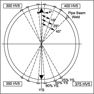

 In phase 1, each ring test piece was produced with four different hard zones on the outer pipe surface, [ Fig.1]. Each hard zone consisted of three separate deposits approximately 100mm long. The locations of these deposits were such that different, but known, stress levels could be applied to each weld in any one quadrant. The hard zones had aim HAZ hardness levels of 300, 350, 375 and 400 HV5. The welding process was mechanised MAG using 1.0mm diameter Bostrand LW1 filler and CO2 shielding. The welding conditions were selected from initial trials, to give appropriate hardness levels.
Fig.1. Test piece design for Phase 1
Bead on plate deposits were also made on the validation test piece of phase 2. Two beads approximately 150mm long were deposited at three locations on the outer pipe surface. The bead locations corresponded with the 90% yield position when the ring was stressed. Each pair of weld beads was displaced from the girth weld by at least 25mm to avoid reheating. The aim hardness levels were 350, 375 and 450HV5. The welding process was the same as for the phase 1 deposits.

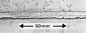

 The full penetration girth weld used to manufacture the validation ring test piece, Fig.2, was produced using a narrow groove weld preparation following established practice. This preparation had a root face of 1.5mm, a root radius of 2.5mm and an included angle of 6° with no root gap. A copper backing bar with a shallow groove was fitted. The welding process was mechanised MAG and welding position was pipe horizontal (1G) i.e. rotated. Bostrand LW1 filler was used with CO2 shielding.
Fig.2. Validation test piece after exposure
Three passes were required to fill the joint. On completion of the capping pass, and after the weld had cooled, a further two circumferential beads were deposited, one at each weld toe on the outer pipe surface. The arc energies of these two additional beads were adjusted such that the associated HAZ regions had hardness levels, estimated from welding trials, in one case of ~350HV, in the other 375-400HV. Similarly, arc energy and preheat conditions for the root pass were adjusted to give an estimated HAZ hardness level of <250HV.

An initial visual examination of the weld zones on both external and internal pipe surface of the test piece did not reveal the presence of any surface breaking cracks although hydrogen blistering was noted on the inner pipe surface, [ Fig.3a]. Further examination by MPI indicated the presence of numerous transverse cracks in the root weld metal, [ Fig.3b]. In places these cracks extend into the weld HAZ. These transverse cracks were present throughout the complete circumferential length of the root pass although the frequency increased in those regions placed in tension during exposure testing. In addition cracking associated with hydrogen blistering was noted, [ Fig.3a]. An ultrasonic examination of the girth weld zone conducted on the outer pipe surface did not indicate any crack like defects in the weld metal or HAZ regions. The results of MPI and ultrasonic examinations made of the validation test piece are summarised in Table 3.
Fig.3. MPI indications showing internal blistering and cracking of girth weld
