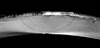

Beachmarking was achieved by the periodic application of blocks of cycles at the same maximum stress as that used for the fatigue tests, but at a lower stress range. This method was chosen to ensure that the beachmarking operation did not influence the rate of fatigue crack growth, in particular reducing it as a result of crack growth retardation due to peak stress changes. The number of beachmarking cycles was controlled to produce a small crack depth increase, typically within the range of 1% to 5%. An example showing such beachmarks is given in Fig.1. Information about the progress of fatigue crack depth was also obtained using ultrasonic inspection.
Fig.1. Beachmarks on the fracture surface of specimen T1-3

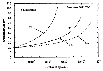

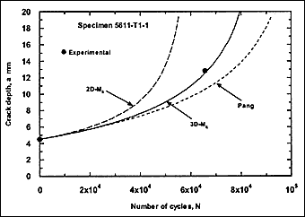

Fig.2a) Specimen T1-1, crack growth in depth and length

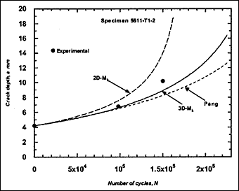

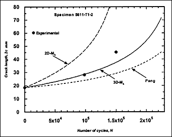

Fig.2b) Specimen T1-2, crack growth in depth and length

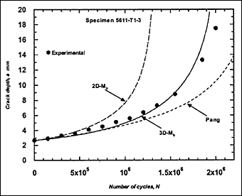

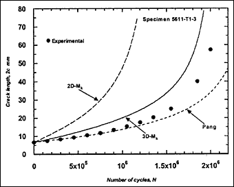

Fig.2c) Specimen T1-3, crack growth in depth and length

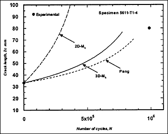

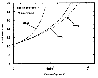

Fig.2d) Specimen T1-4, crack growth in depth and length

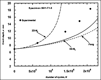

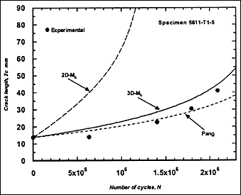

Fig.2e) Specimen T1-5, crack growth in depth and length

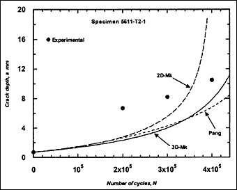

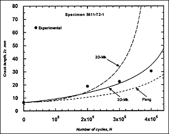

Fig.2f) Specimen T2-1, crack growth in depth and length

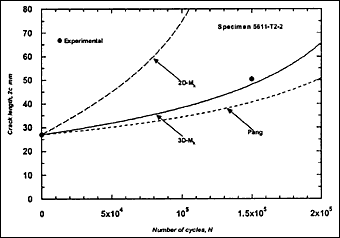

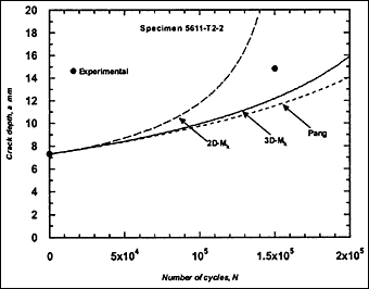

Fig.2g) Specimen T2-2, crack growth in depth and length

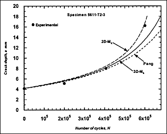

Fig.2h) Specimen T2-3, crack growth in depth

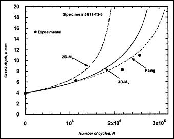

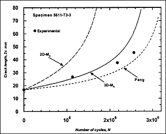

Fig.2i) Specimen T3-3, crack growth in depth and length

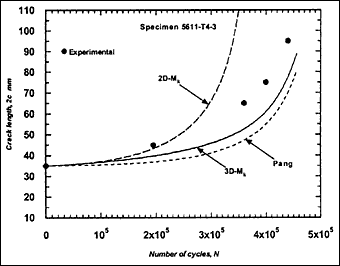

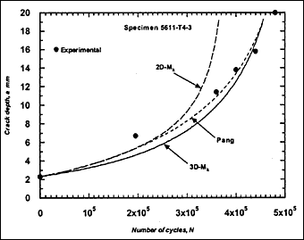

Fig.2j) Specimen T4-3, crack growth in depth and length

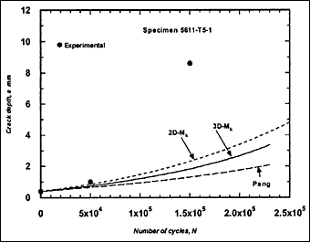

Fig.2k) Specimen T5-1, crack growth in depth

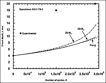

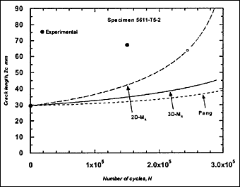

Fig.2l) Specimen T5-2, crack growth in depth and length

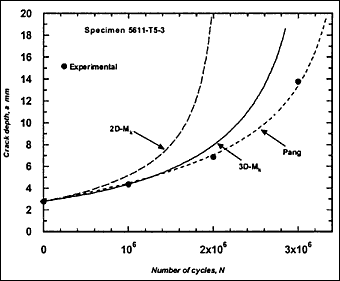

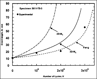

Fig.2m) Specimen T5-3, crack growth in depth and length
Fig.2. Comparison of experimental and predicted fatigue crack extension in depth and length (using the Paris law coefficient C=1.0x10 -13.)
These crack growth data were compared with predictions based on Eq.4. For each case, the prediction started with the earliest recorded crack depth (a i) and length (2c i). The local stress range, including any secondary bending stress due to misalignment, was used in the calculation of ΔK. Initially, when the appropriate recommended mean value of C was used, it was found that the crack growth predicted using the 3D-M k solution overestimated the actual in most cases. The predictions were even poorer when 2D-M k solution was used. It was thought that this reflected the fact that the crack growth characteristics of the actual steels were different from the mean crack growth laws in BS 7910. Limited tests on the pipe steels indicated that m = 3 was reasonable but that C could be as low as 1 x 10 -13, lower than the BS 7910 values. Further trial calculations indicated that this value was appropriate when the 3D-M k solution in BS 7910 was used, and therefore it was adopted for the remaining calculations.
The resulting predicted crack growth in both depth and length directions are compared with the experimental data in Fig.2. It can be seen that the 3D-M k solution gives the best prediction for growth in both directions. Generally, use of the 2D-M k solution still significantly overestimated the actual crack growth, both in the depth and length directions. It has to be borne in mind that these over-predictions were based on a C value that is below the mean value suggested in BS 7910 [2000] [5] .
By reviewing M k solutions for welds, Pang [1990] [13] showed that the assumption of a constant value of M k for crack growth in the c-direction when using the 2D ΔK solution was conservative. By curve fitting of the results from Bell's 3D-stress analysis [1987] [2] , he proposed a less conservative and simple expression for M k to be applied when assessing growth in the c-direction, M kc, for crack front shapes in the range of a/2c between 0.1 to 0.5. It was expressed as a function of M k for application to growth in the a-direction, M ka, as:

M ka is still calculated using the 2D-M k solution. For comparison, this M k solution was also used in the calculation of ΔK to predict fatigue crack growth in the girth-welded specimens. The results are included in Fig.2, referred as Pang. It was assumed that this solution is applicable for any crack front shape. It can be seen that the prediction based on the Pang's expression is close to that obtained using the 3D-M k solution developed by Bowness and Lee [2000] [3] , with Pang's prediction of crack extension being slightly lower. The only exception, where the prediction using Pang's equation was slightly higher, is specimen T4-3. Its initial a/2c aspect ratio was very small (a = 2.3mm and 2c = 35mm), which is out of the application range of 0.1 to 0.5 for the Pang's solution [1990] [13] .

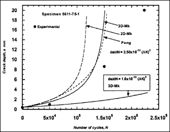

Mention should be made of the two cases, in series T5, where all M k solutions led to underestimates of the crack growth rate, specimens T5-1and T5-2 in Fig.2(k) and (l). In both cases, the crack initiated from the inside and propagated through weld metal. However, there were other cases where cracks that had initiated on the inside did not exhibit such exceptionally high growth rates. It is possible that crack growth in these two specimens was affected by local welding defects, but a full explanation has not been found. The results might simply be a reflection of scatter in fatigue crack growth rates. It may be noted that use of the mean value of C for R ≥0.5 recommended in BS 7910, that is C = 2.5x10 -13, always over-estimated the actual crack growth rate, the predictions based on the 2D-M k being excessively conservative, see one example in Fig.3.
Fig.3. Comparison of experimental and predicted fatigue crack extension in depth for specimen T5-1 using the Paris law coefficient C=2.5x10 -13 suggested in BS7910 for R ≥0.5. The 3D-M k prediction using C=1.0x10 -13 is also included for comparison.

As noted earlier, when using a 2D solution for M k, a constant value of M kc is assumed to apply at the ends of a semi-elliptical crack, due to the lack of a 3D-M k solution. This assumption is recognised as being an interim approach that will be improved once M k solutions for actual semi-elliptical weld toe cracks become available. The present calculations based on this assumption were not successful in that, in general, the fatigue lives predicted by fracture mechanics were much less than those actually achieved. This was partly due to over-estimation of crack growth in the a-direction, but the correlation between the predicted and the actual crack length along the weld toe was also poor, fracture mechanics again predicting faster growth in the c-direction than that observed from the beachmarks. This outcome is not surprising since K depends on the crack aspect ratio a/2c, increasing as a/2c decreases. As the assumed constant value of M kc is higher than its counterpart in the 3D solution, use of the 2D solution leads to a lower aspect ratio crack. Thus, at a given crack depth this results in a higher ΔK value at the crack front than that from the 3D solution, and hence a higher crack growth rate. The 2D-M k solution will approach the 3D-M k solution as the crack aspect ratio decreases.
Indeed, when the initial crack aspect ratio was small, such as in specimen T4-3 (a=2.3mm, 2c=35mm) and in specimen T5-1 (a=0.4mm, 2c=8mm), rather similar crack growth in the a-direction was predicted using either the 2D- or 3D M k solution. However, although the difference in growth in the c-direction was reduced, a difference still remains. Therefore use of the 2D-M k solution provides upper bound fatigue crack growth predictions.
The fracture mechanics predictions are critically dependent on the choice of the crack growth parameters C and m. m is generally taken as 3 for the single-stage Paris law [BS 7910, 2000] [5] . For cracks associated with welds, BS 7910 gives a mean value of C as 2.5x10 -13 to include any tensile residual stress effect. Using this value, conservative crack growth predictions were always obtained with the two 3D-M k solutions, as can be seen in Fig.3 which shows the fastest crack growth rate of all specimens. On the other hand, the 2D-M k solution gave over-conservative predictions of the crack propagation. The high level of conservatism of the 2D-M k solution is further highlighted by the fact that ECA normally make use of the upper bound value of C (mean + 2 standard deviation), which is 5.21 x 10 -13 in BS 7910.
