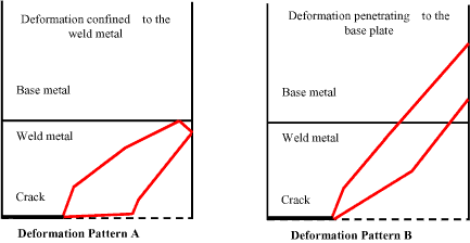

Mismatch limit loads are given in R6 [5] for fully circumferential internal cracks in cylinders; these are taken from work by Schwalbe et al. [6] (As far as is known, there are currently no general mismatch limit load solutions for finite length flaws in girth welds in the public domain.) This geometry was considered representative of a long surface flaw in a pipelinegirth weld. The mismatch limit load solutions consider parallel sided welds and are for weld metal centreline flaws and flaws located at the interface (in this paper, the interface is considered to be representative of the HAZ/fusionline). The choice of limit load depends on the expected deformation pattern. For undermatched welds (M<1) two deformation patterns are possible. Deformation pattern A: deformation is confined to the weld metal. Deformation patternB: deformation penetrates into the base metal, as illustrated in Fig.1.
Fig.1. Possible deformation patterns in undermatched welds
For overmatched welds (M>1), again two deformation patterns are possible. Deformation pattern C: deformation from the crack tip penetrates through weld metal into the base metal (like pattern B in Fig.1). Deformation pattern D: deformation takes place in the lower strength base metal, away from the crack; gross deformation does not occur in the weld metal.

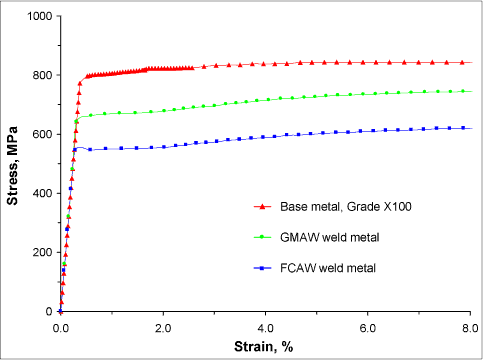

Engineering stress-strain curves were obtained from a Grade X100 pipe with an outside diameter of 915mm and wall thickness of 19mm using 8.9mm diameter specimens. All weld metal stress-strain curves were obtained from welds made in the Grade X100 pipe in a V preparation with 60° included angle using two welding processes employed to fabricate girth welds. These were a GMAW process with 95% Ar 5% CO 2 shielding gas at a heat input of 0.94J/mm, and a FCAW process with 75% Ar 25% CO 2 shielding gas at a heat input of 2.2kJ/mm. The consumables and welding procedures were designed to provide tensile properties that closely matched and undermatched the SMYS of the pipe. The result was weld metal that undermatched the actual strength of the pipe. The tensile properties are summarised in Table 1 and stress-strain curves are compared in Fig.2. Based on yield strength, the levels of undermatching achieved were M = 0.83 and 0.685 in the two welds.
Table 1 Tensile properties
MaterialYield strength, MPaTensile strength, MPaM 0.2
Parent pipe 797 844 1
OM weld metal* 877 928 1.1
GMAW weld metal 661 751 0.83
FCAW weld metal 546 635 0.685
* Artificially created
Fig.2. Experimental stress-strain curves for parent pipe, GMAW and FCAW girth welds
10% overmatching (M = 1.1) was artificially created for the purposes of analysis by assuming the weld metal has the same stress-strain curve as the parent pipe but uplifted by 10%.

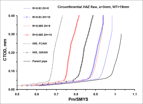

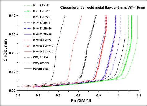

Figures 3 and 4 show how the allowable axial stresses (represented as the ratio of allowable stress to the SMYS of Grade X100 strength pipe; i.e. 690MPa) changes with mismatch level in different weld widths. In these figures the mismatch ratio represents actual mismatch at the yield stress (M 0.2 ). The assessments were conducted assuming that a minimum CTOD of 0.25mm at the minimum design temperature is achieved in both weld metal and HAZ. An initial analysis was conducted assuming that the flaw is inhomogeneous material (no strength mismatch) with tensile properties equal to the lowest strength present. This is the recommended procedure in BS 7910 when mismatch limit load solutions are not available. As can be seen, this provides,as intended, a conservative estimate of allowable axial stress. However, if mismatch and weld width effects are specifically considered in the analyses, benefits to the allowable stress are realised as the weld width is reduced from 20to 5mm. Although the allowable stress is increased for undermatched welds (M<1) it always remains below that for matched and overmatched welds (M ≥1). When overmatching is present (M>1) and the flaw is located in weld metal, increasing the weld width permits the allowable stresses to beincreased. Consequently, when the differences in weld metal and parent pipe strengths are small (M close to 1), the best strategy is to use a narrow weld. If slight undermatching occurs, the reduction in allowable stresses is minimised, but there is still a benefit in allowable stress (> pipe SMYS) if overmatching occurs.
Fig.3. Ratio of allowable axial stress (P m ) to SMYS of Grade X100 pipe for circumferential weld metal flaws 3mm high at different levels of strength mismatch and weld widths (2H)
Fig.4. Ratio of allowable stress (P m ) to SMYS of Grade X100 pipe for circumferential HAZ flaws 3mm high at different levels of strength mismatch and weld widths (2H)

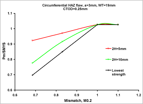

According to the limit load solutions currently available, weld metal overmatching confers no benefit for interface (HAZ) flaws. However, because the HAZ usually has a higher strength than the base metal, there will be some benefit. It may be noted that for a given level of undermatching, HAZ flaws are more sensitive to weld width effects than are weld metal flaws. Nevertheless, the analyses show a clear benefit of using narrow welds if undermatching is likely.
Figures 5 and 6 show how the CTOD requirement (CTOD driving force) varies with applied axial stress for different weld widths and mismatch levels. Also included are analyses for homogeneous material, assuming no mismatch effects. These provide bounds to the analyses and illustrate the benefits of allowing for mismatch effects.
Fig.5. Relation between CTOD requirement and ratio of axial stress (P m ) to Grade X100 SMYS for weld metal flaws with different mismatch levels (M) and weld widths (2H). Note, curves for M=0.85, 2H=10 and M=0.685, 2H=5 are nearly coincident
Fig.6. Relation between CTOD requirement and ratio of axial stress (P m ) to Grade X100 SMYS for HAZ flaws (3mm high) with different mismatch levels (M) and weld widths (2H)
The figures show that CTOD driving force (or fracture toughness requirements) increases more rapidly than the increase in allowable stress. However, a limit appears to be reached when further increases in fracture toughness have no benefit on allowable stress. This condition is obtained when failure is predicted to occur by plastic collapse rather than fracture. However, in practice crack growth by stable ductile tearing will occur before plastic collapse and this will affect the analyses at higher CTOD values (say above about 0.3mm when initiation by ductile tearing is likely to have taken place). To assess this condition a tearing (Level 3B) analysis [4] is required, but this is beyond the scope of this paper. However, a tearing analysis would be beneficial because a CTOD-resistance curve with a positive slope would enable higher axial stresses to be tolerated, provided that limited ductile tearing is accepted in the pipeline girth weld.
The analyses show the clear benefit of just small amounts of weld strength overmatch, in this case just 10% actual strength overmatch, on the allowable stress when considering weld metal flaws. Indeed, for the case considered, axial stresses above the pipe SMYS are acceptable even with a 3mm high flaw present in the weld metal provided that CTOD is greater than about 0.1mm.
The analyses illustrate how weld metal (but not necessarily HAZ) fracture toughness requirements can be reduced if specific allowance is made of the benefits of over matching. Most specifications are based on analyses that do not consider mismatch effects. Figure 5 shows, for example, that for an axial stress equal to base metal SMYS, the CTOD requirement based on parent pipe strength (M=1), would be 0.14mm to avoid failure from a 3mm high flaw. However, even with 10%overmatching, the CTOD requirement can be reduced to between 0.09 to 0.06mm (depending on weld width) if specific allowance is made for mismatch effects.
The analyses also show how fracture toughness requirements need to be increased, to achieve the same flaw tolerance, if undermatching is present. However, the increase would not be as great as predicted by an analysis based on the least strong material. For example, Fig.5 and 6 show that for M = 0.83, an analysis based on the GMAW weld metal would require a CTOD of 0.25mm from the weld metal and HAZ for an axial stress 85% of SMYS. By specifically analysing for the undermatched condition (M =0.83), the CTOD requirement can be reduced to about 0.05mm for both weld metal and HAZ. (Although fracture toughness determination is not considered in this paper, it should be noted that if the HAZ strength undermatches the strength of both weld metal and parent pipe, the likelihood of cleavage can be increased. This can result in very low fracture toughness values being measured in the HAZ. [8] )
