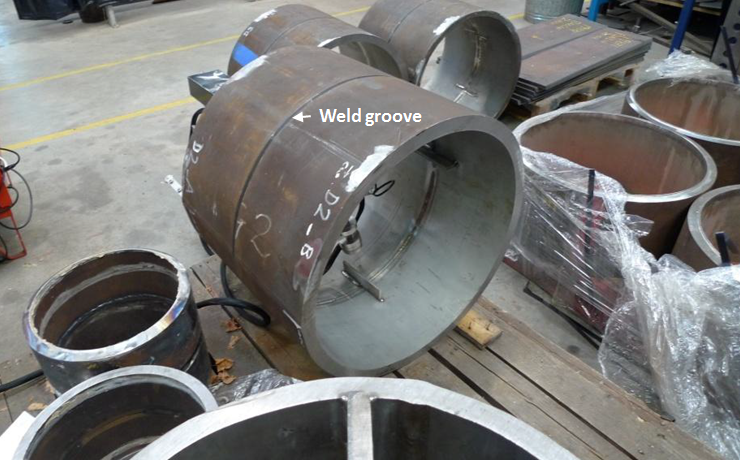

Figure 1 shows the remaining groove from the partially completed weld, ie deposition was halted after the root and hot pass. The artificial flaws implanted in one half of each specimen pipe, represented the type of flaws expected at this intermediate welding stage and hence the ultrasonic techniques were required to detect them with confidence, providing both flaw type identification and accurate sizing information.
Figure 1 Image of specimens used in the project, highlighting a typical weld groove where the fill passes were not introduced to complete the weld.

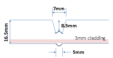

The incomplete fusion in the hot pass (specimen 08) was simulated by introducing a machined slot along the fusion boundary and the flawed area could be visually detected from the outside surface. The presence of porosity (specimen 01) was confirmed through radiography and the presence of the lack of penetration type flaws (specimens 04 and 06) could, to a limited extent, be confirmed through tactile investigation of the weld root. Note that specimen 06 was welded with deliberate misalignment, whereas there was (nominally) no misalignment in the other pipes. In each pipe specimen four flaws were introduced, equally spaced in the region from 0 to 180° around the circumference of the weld. This allowed for half of the weld circumference available for use as an ultrasonic reference and to remove samples for metallurgical analysis (see Section 4).

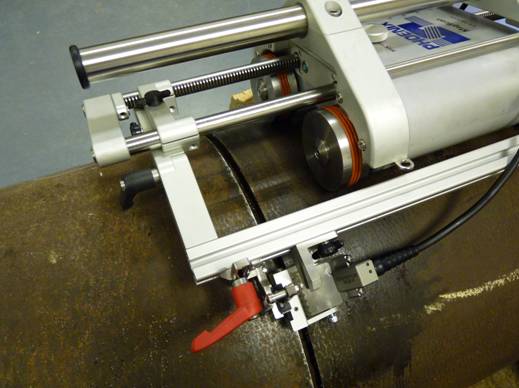

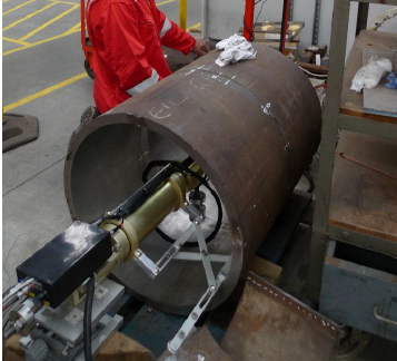

To automate the inspection, the MAGSCAN developed by Phoenix ISL 6 was selected. The scanner is placed on the pipe and remains attached through its magnetic wheels with the probe attached to a scanning arm; Figure 3 shows the scanner mounted on specimen 01 (containing porosity).
Figure 3 The 10MHz array probe connected to the scanning arm of the MAGSCAN and positioned to implement a phased array technique.

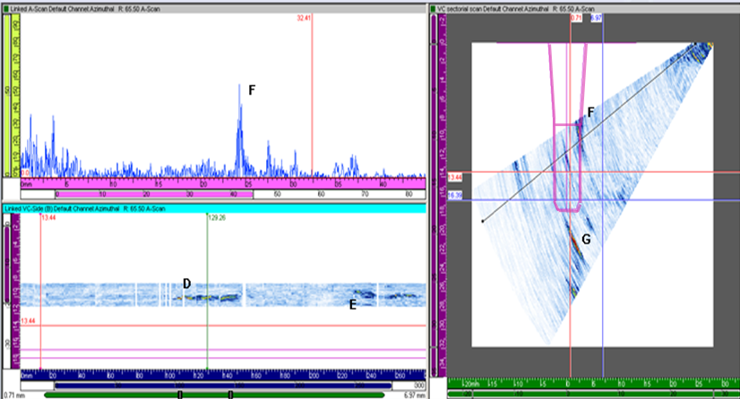

The phased array scan data is presented using methods and conventions established by Olympus NDT. Figure 5 shows a typical data display for analysis of the weld condition with the interlinked cursers:
  1. The sector scan (termed the S-scan) in the right hand data window is composed of all the beam angles generated by the array; there is a sector scan for each 1mm point around the circumference. On the S-scan, a pink outline of the weld has been drawn (the overlay) to aid interpretation of the signals; the incomplete nature of the weld is represented by the horizontal line on the overlay 8mm from the root above which no weld material was deposited. An echo due to a flaw is displayed on the cross-section of the weld overlay and it’s through-wall extent can be evaluated. The black cursor line running through the sector selects the beam angle of interest which is used to display the B- and A-scan views.
  2. The B-scan view (the bottom left hand data window) displays the echoes generated along the black cursor line in the S-scan view; thus the echoes along a certain beam angle which could, for example, be incident in the root region can be viewed in the B-scan view. If there was a flaw in the root this would be displayed in the B-scan view showing its circumferential extent; gates remove irrelevant data such that the B-scan view mimics a strip-chart view around the circumference. The S-scan shown is selected by the vertical green cursor shown in the B-scan view.
  3. The A-scan view (the top left hand data window) displays the fundamental ultrasonic time-amplitude data from which both the S- and the B-scan data presentations are generated. The A-scan shown is from the beam indicated by the black cursor in the S-scan view. The signal amplitude due to a flaw and the S/N condition of the inspection can be evaluated using the A-scan view.

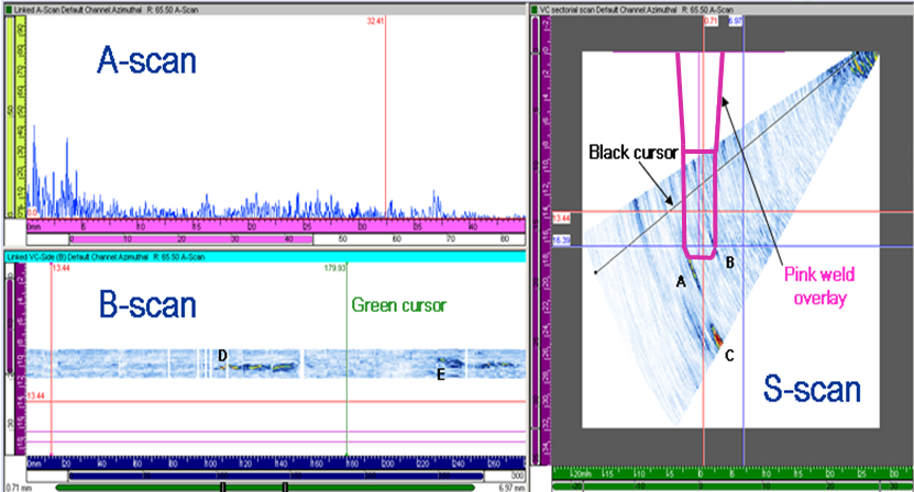

Figure 5 Data display showing the three views for the A-, B- and S-scans along with the two cursors (black and green) which interlink all the data between these three views.
The quality of the data is based on good coupling, lack of missing circumferential data, good positioning of the wedge with respect to the weld centreline so that the weld overlay position is accurate with respect to the data and good S/N performance in the A-scan view. It would be the responsibility of the site team to ensure that the data quality is sufficient (as specified in field implementation procedures) before the weld is analysed and sentenced.
In Figure 5, in the S-scan view, the signal marked A is a geometric signal due to the back of the root; often termed the root signal in a conventional ultrasonic technique and runs the full length of the weld. The signal marked B is also a geometric signal due to the root profile, as is the signal marked C which is due to the lower beam angle reflecting on the back surface (marked as the horizontal blue line at a depth of 16.5mm in the S-scan) and being incident on the edge of the groove at the root. Both A and B are signals which will be present in fully completed welds but C, plotting at a depth of 25mm, is unique to partially completed welds.
In Figure 5 there are two features marked D and E in the B-scan view due to two incomplete fusion type flaws in specimen 08. Note that the vertical green cursor is in a region around the circumference where neither flaw D or E is present; hence the cross-section shown by the S-scan view in Figure 5 does not show either of the flaws, but only the nominal geometry signals. In Figure 6, the green cursor cuts through the indication marked D and now the S-scan in Figure 6 shows a cross-section through the weld at that circumferential point. It is then straight forward to identify the flaw (ie detect it), class it as incomplete fusion due to its position on the weld bevel and further evaluate its size based on its position on the weld bevel. The image of the flaw cross-section given by the signal marked G (below the back wall marked by the horizontal blue line) allows the operator to confirm and check the size measured directly using signal marked F above the back wall (horizontal blue line). The circumferential extent of the flaw can be measured in the B-scan view.

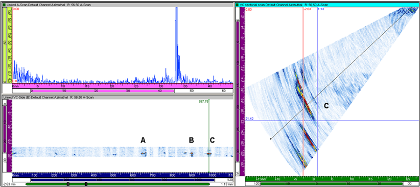

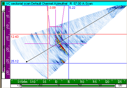

Figure 6 Data through the incomplete fusion flaw marked D; the S-scan shows a cross-section through the weld at the circumferential point (green cursor) and the A-scan view shows the time-amplitude signal (black cursor).

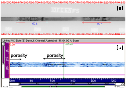

Figure 7 (a) shows the presence of implanted porosity in specimen 01 using radiography and Figure 7 (b) shows the ultrasonic data in the B-scan view.
Figure 7 Radiographic and ultrasonic data showing the presence of porosity in specimen 01.

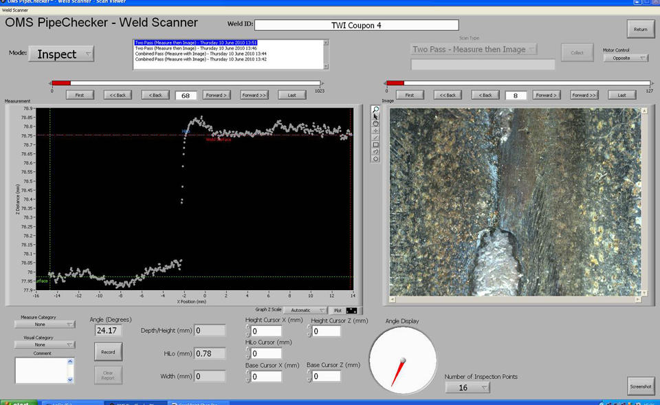

Figure 9 shows the data output from the laser optical system which shows the measured root profile and an optical image of the region. The recorded misalignment in specimen 06 taken directly from the sample using a weld gauge was 2.5mm; the OMS system measured the misalignment every 1mm around the pipe with five hundred measurements across the weld, measuring a maximum misalignment in this sample of 2.61mm.
Figure 9 Laser optical measurement of a lack of root penetration in specimen 04 with a measured length of 10mm, which nominally had no misalignment. The left image shows a typical laser measured root profile to evaluate misalignment and the right image shows the presence of a lack of root penetration type flaw in the weld.

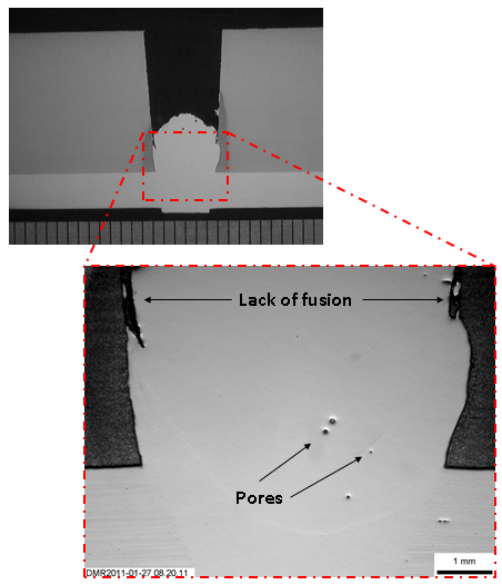

Selected areas of specimens 01, 04 and 08 were sectioned to investigate the through-wall sizing capability of the phased array techniques. The locations chosen were based on the scan data, ie locations where flaws were identified. Figure 10 shows the general weld cross-section through specimen 01 through a region of porosity marked C as shown in Figure 11. Two pores are visible in the micrograph of Figure 10 in the hot pass. However, note also the lack of side wall fusion in Figure 10 which is also evident in the data of Figure 11 at higher beam angles in the sector scan.
Figure 10 Cross-section through a point in the specimen corresponding to the section in Figure 11 marked C, showing pores and lack of fusion on the hot pass side wall.

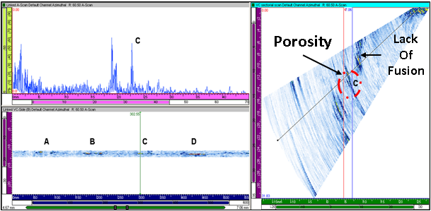

Figure 11 Data showing flawed regions containing porosity in specimen 01, along with a lack of side wall fusion in the hot pass.
It is only possible to size regions containing porosity along their circumferential extent which was confirmed through the radiography; as the volume of the weld is small, through-wall sizing is not required and the weld containing porosity will be sentenced based on the circumferential extent of the damage.

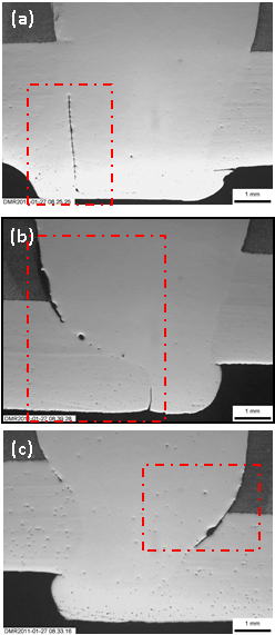

Figure 13(a) shows the micrograph at 663mm showing the lack of root penetration flaw corresponding to the data shown in Figure 12. Similarly, Figures 13(b) and 13(c) show the micrographs corresponding to positions marked B and C in Figure 12.
Figure 13 Micrographs of the section in specimen 04 at (a) 663mm, (b) 907mm and (c) 992mm from the datum, focused on the lack of root penetration flaw (highlighted).

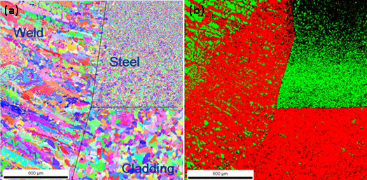

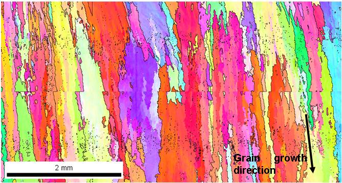

A transverse metallographic section was extracted from the weld area in specimen 01 and mounted in conductive resin for analysis. The EBSD scan was carried out at a magnification of 50 times and the step size selected was 4μm (the distance that separates each point from its neighbour). Figure 14(a) shows the inverse pole figure map and the texture shows that the microstructures of the three areas, the duplex stainless steel weld, pipe steel and 316L cladding material, are very dissimilar. The pipe steel microstructure consisted of very fine grains, as expected, and a magnification of 50 times is not appropriate to assess the microstructure in more detail. The cladding material consisted of equiaxed grains of approximately 70μm diameter on average, consistent with the microstructure expected in 316L sheets. The microstructure in the weld was much coarser than in the other two areas. The elongated shape of the grains and their orientations are directly related to the direction of solidification of the weld metal (from the fusion line to the centre of the weld pool). Figure 14(b) shows the phase map which clearly discriminates between the different materials, hence the steel is fully ferritic, the cladding fully austenitic and the weld has a duplex structure (a mixture both phases).
Figure 14 EBSD scans showing (a) the texture differences between the weld, parent and cladding, and (b) the phase map where green is ferrite and red is austenite.
The wavelength of the shear wave at a frequency of 10MHz is about 300μm, which is much larger than the grains of the steel and is also an order of magnitude larger than the grains of the cladding. This goes some way to explain why the shear wave is able to penetrate the cladding, as the grains of the cladding are on the boundary of becoming significant scatterers of the sound; grains become significant scatterers when their size approaches 1/10th of the wavelength 10. However, by the same argument, the shear wave of wavelength ~300μm will be significantly scattered by the elongated grains in the weld metal. However, note that the angle at which the beams are incident into the weld implies that the wave is being affected by the grain width (similar in size to the cladding grains) rather than the longer lengths of the dendrites; hence the scattering in the weld is also on the 1/10th of the wavelength boundary and, as supported by the experimental evidence, could explain why the propagation is not adversely influenced.
The structure of both the cladding and the weld has an important effect on the capabilities of the ultrasonic techniques. In the case of the development specimens, which used the Duplex weld and the 316L cladding, the metallurgical analysis indicates that the ultrasonic waves (longitudinal and shear) should be able to penetrate the metals, sufficiently, to interrogate the entire weld and the experimental evidence, presented in this paper, supports this hypothesis.
The structure of the cladding is influenced by the method used to generate it, whether it was introduced through metallurgical bonding (such as roll bonding) or through fusion (weld-deposited) methods, such as strip-cladding. Metallurgical bonding does not lead to fusion and solidification that are known to coarsen the grain size of austenitic materials. In this project, only cladding applied by metallurgical bonding was investigated ultrasonically; however, there are occasions when weld-deposited cladding may be used. Thus, work was done to provide some guidance on the feasibility of using ultrasonics, in such cases, to detect critical flaws.
