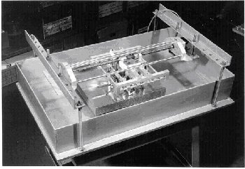

Non destructive examination
Details of inspection equipment and techniques developed to some extent throughout the project, but the principals, which aimed to achieve constant and reproducible coupling, remained the same. For the groove welds, coupling was achieved by immersing the specimen in an oil bath ( Fig.4). A pan of fixed probes, providing a combination of longitudinal and transverse pulse echo and time of flight diffraction examinations, was automatically traversed over the reverse sides of the specimens. Test samples were immersed in the oil bath when they had cooled to about 40°C adjacent to the weld. The time of the first inspection varied, due to differences in weld cooling times and other experimental variables, between about 30 minutes and eight hours after completion of welding, generally being between 1 and 3 hours.
Fig.4 Oil bath and ultrasonic inspection equipment used for groove ends
For the pulse-echo inspections, only indications having an amplitude greater than that from a 3mm side-drilled hole plus 14dB were displayed. Thus, the sensitivity was neither lower nor significantly greater than that which is usual in practice. It should be recognised, however, that the detectability of all defects using fixed orientation probes is limited by comparison with a manual inspection. Time of flight probes were used to compensate for this, and to provide information on crack growth.
Interpretation of pulse echo signals was complicated by an observed increase in signal amplitude for all reflections, including stable geometrical features such as the weld cap profile, as the weld cooled. Where features were observed on first inspection (by either technique) and none of the observed features changed during subsequent monitoring, their nature was confirmed by metallographic sectioning.
For submerged arc welds, immersion in the oil bath was not possible. For these welds, manually controlled mechanised scans were carried out. A probe pan and stepper motor were attached to the back face of each weld with magnetic feet as soon as it had cooled to about 30°C, and kept in place for the duration of the test. Only time of flight probes were used for these inspections.
All inspections were carried out at increasing intervals, over a total period of about 1 week. The initial interval for the automated, oil bath tests was ½ hour, increasing logarithmically to 12 hours at the end of the week. Test intervals on the submerged arc welds were 1 hour for the first 3 hours, every 2 hours for the next 6 hours, every 8 hours for the next 4 days and finally 24 hours until the end of the week.
