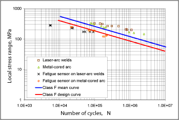

The fatigue test results for the welds are compared with the performance of the sensors in Table 1. Stresses are given in terms of the remotely applied stress range and the larger local stress range at the joint resulting from the angular misalignment. Lives quoted for the specimens are for complete separation. For the sensors, endurances quoted for each crack tip are for failure of the final track, after which the sensor output is saturated.
The test results, expressed in terms of local stress range, are presented in Fig.5 where the Class F mean and design curves are also included for comparison. It should be noted that results for all specimens, nine of each type, are plotted in Fig.5, although only five of each type were fitted with sensors. Angular misalignment results in a secondary bending stress which is tensile on the concave side of the joint and decays to zero approximately half way between the specimen centre and where it is gripped in the machine jaws. As a result, the local stress range at the joint was higher than that at the point of attachment of the sensors, and this was allowed for when plotting the results in Fig.5. Because only angular misalignments, not axial misalignments, were present in these joints, the secondary bending stress induced by misalignment can be reasonably assumed to be linearly distributed. From the value of Km at the positions of the strain gauges (5mm from the weld toe), the average SCF for each sensor was estimated at its centre position. The local stress range for each sensor was determined by multiplying the nominal applied stress range by the corresponding SCF at the sensor. The SCFs and the local stress ranges at both the strain gauges and the sensors are summarised in Table 1.
Fig.5. Fatigue test results of the sensors and the test plates

It will be seen that the fatigue endurances of both the HLA and metal-cored arc welds comfortably exceeded the Class F mean curve, i.e. the 50% failure probability curve, especially for the HLA welded joints. The fatigue endurances of the sensors installed on the metal-cored arc welded specimens were slightly but consistently greater than those of the sensors installed on the HLA welded specimens. In all cases sensor performance was close to the Class F design curve, which represents a nominal failure probability for the welds of 2.3%. The fatigue endurances of all the sensors were less than that of the joints tested. Hence, as intended, the sensors gave a reliable and conservative warning of reaching the fatigue design life of the joint.
The test results from the sensors also demonstrated that the attachment method adopted provided high attachment strength to guarantee sufficient load transfer to the sensor. For example, sensor No.12 tested at a local stress range of ~310MPa (maximum stress = 344MPa) failed before the Class F design curve despite the high applied stress. In all tests special attention was paid to the performance of the attachment studs. No stud failures or cracking occurred at the attachment points.

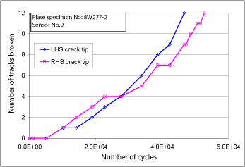

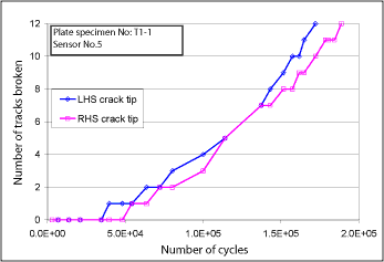

Figures 6 and 7 show typical results for two sensors, one on a HLA joint and one on a metal-cored arc welded joint, showing the full sensor output in terms of the number of severed tracks versus test cycles. The response is close to a linear characteristic. Typically the first track was severed at about 10-20% of the total life of the sensor and subsequent tracks failed regularly throughout the life.
Fig.6. Typical result for the sensors on the laser arc welded specimens, showing sequential failure of tracks (nominal stress range=150MPa)
Fig.7. Typical result for the sensors on the SA welded specimens, showing sequential failure of tracks (nominal stress range=90MPa)

The results obtained demonstrated that the sensors performed well in laboratory tests. It was established that the electrical output of the sensor system changed reliably throughout its life in twelve steps, Fig.6 and 7. As indicated in Fig.5, failure of the final sensor track, i.e. the twelfth step change in its electrical output, corresponded closely with the Class F design S-N curve. In a structural monitoring application, with the sensor installed adjacent to a Class F detail, the twelfth step change in output would indicate that the structure or component had reached the end of its design life. At this point various actions could be considered, such as inspection and repair if necessary, increasing the frequency of inspection, retiring the structure from service or modifying the loading, etc. Since the sensor output is related only to the cumulative applied loading, it is not an indication of the condition of the joint itself. The target joint may or may not show evidence of cracking; the joints tested here survived significantly beyond the Class F design endurance (see Table 1). In applications where the decision is taken to extend the life, the failed sensor could be replaced to allow monitoring to continue.
Because of the difference in angular misalignments, the metal-cored arc welded specimens experienced higher bending stresses than the HLA welded specimens. When plotted in terms of the local stress range at the sensor, Fig.5, it appears that sensors attached to the metal-cored arc welded joints had slightly greater endurance than sensors on the HLA welded joints. This suggests that the performance of the sensor, to some degree, depends on the loading mode. In situations where bending stress constitutes a large proportion in the total stress range the sensor life may exceed the Class F design curve, in which case, it may be cautious to base assessment on the life to separation of the eleventh track.
