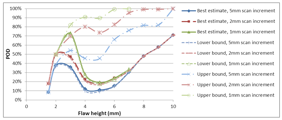

Figure 4 illustrates the variation in POD with flaw height predicted by PODPEDGE for elliptical flaws having a fixed aspect ratio (ie length:height) of 5:1. Best estimate PODs, together with upper and lower bounds, are given for three different scanning increments in the secondary scanning direction (ie along the length of the weld). This illustrates that, at least in some cases, the assumed scan pattern has an important effect on the POD. The best estimate POD in Figure 4 at a flaw height of 3mm, for instance, varies from 36% to 73% according to the secondary scanning increment. A 1D scan would result in a smaller POD than any of these 2D scans so, by implication, the use of a 1D scan (or no scanning) could also have a substantial impact on the predicted POD.
The POD has a local maximum (corresponding to ~70% POD) at a flaw height of ~3mm and then gradually drops to ~20% POD (at a flaw height of ~5mm), after which it steadily increases again, following a more intuitive trend for larger flaw heights. The presence of a local maximum in the POD is counter-intuitive and contrary to the generally held belief that POD increases monotonically with increasing flaw height. It is, nevertheless, believed to be a genuine effect (at least for the idealised elliptical flaws considered here). It arises essentially because the bottom edge response is enhanced when the probe lies near the caustic, ie the line that lies at right angles to the plane of the flaw and that passes through its centre of curvature (10).
Figure 4. PODs predicted by PODPEDGE vs. flaw height for elliptical flaws having a fixed aspect ratio (reporting threshold DAC -10dB).
The lower bound POD is almost identical to the best estimate POD in Figure 4. However, the upper bound POD has a much smoother appearance and, for a 1mm secondary scanning increment, is almost monotonic. This confirms that the trough in Figure 10 at ~5mm flaw height is largely due to the proximity of the caustic. PEDGE is known to be potentially inaccurate in these regions, so the true peak amplitude is unknown. However, it is considered likely that the true peak amplitudes in these regions would be above threshold due to the favourable focussing of the diffracted rays, ie it is possible that the upper bound predictions in Figure 4 are realistic even though the PEDGE amplitudes on which they are based are likely to have been overestimated.
In many of the cases studied, there is very little difference between the ‘best estimate’ POD and the upper and lower bounds. However, Figure 4 shows that, in some cases, the difference between the ‘best estimate’ POD and the ‘upper bound’ POD can be as large as 70% (due to the proximity of the caustic). This highlights the importance of calculating both the ‘best estimate’ and the ‘upper bound’ PODs, in practice, as an internal check on possible model inaccuracy (at least for GTD-based models).
