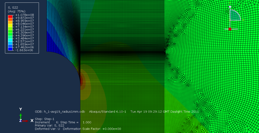

Estimation by the Reference Radius Approach
Since the wall thickness of the girth welded pipes considered in the present analysis was greater than 5mm, the relevant reference radius to be used when calculating the local stress is 1mm. However, for comparison the value normally confined to assessments of welded joints in plates ≤ 5mm was also considered. Two FE models were established for the 1mm reference radius, one with a hi-lo of 0.5mm and the other 1mm. In addition, four FE models were established for the 0.05mm reference radius , with a hi-lo values of 0.25, 0.5, 0.75 and 1mm. Figure 8 shows two FE models with the same hi-lo of 1mm, one with a radius of 1mm and the other 0.05mm.

FIGURE 8 The FE model and the calculated stress contour for the weld root bead profile a)
FIGURE 8 The FE model and the calculated stress contour for the weld root bead profile with a hi-lo of 1.0mm (in this case, hi-lo=weld root bead height, 18.5/19.5mm wall thickness, applied nominal stress=50MP a) Corner radius = 1mm
FIGURE 8 The FE model and the calculated stress contour for the weld root bead profile b)
FIGURE 8 The FE model and the calculated stress contour for the weld root bead profile with a hi-lo of 1.0mm (in this case, hi-lo=weld root bead height, 18.5/19.5mm wall thickness, applied nominal stress=50MPa b) Corner radius = 0.05mm
The estimated fatigue strengths at 107 and 5x106 cycles for the two reference radii and different hi-lo values are compared with the experimental values in Table 2. As the reference S-N curves have the same slope as that for the full-scale girth welds (m = 3), the differences between the actual and calculated fatigue strengths were the same for both endurances. It can be seen that, for both reference radii, the calculated fatigue strengths at both long endurances agreed well with the actual fatigue strengths for a hi-lo value of 1mm, with the differences being less than ±5%. However, for a hi-lo of 0.5mm, which was about the average of the worst hi-lo values of the 33 girth welds examined, both methods over-estimated the actual fatigue strength, by 17% for the 1mm reference radius and 35% for the 0.05mm reference radius.

The 1mm reference radius approach is considered first since, in view of its widespread use in some industries and even acceptance by some design standards, it is the least controversial of the two fatigue strength calculation methods investigated here. Referring to Table 2, good estimates of the actual fatigue strengths at 5x106 and 107 cycles, within 5%, were achieved. However, this was the largest hi-lo seen among the 33 welds examined. Assuming a hi-lo of 0.5mm, the case closest to the average actual hi-lo of 0.47mm, over-estimated the fatigue strengths at the two endurances considered, by 17%. This might reflect a deficiency in the analysis method, but it might also be an indication that the IIW FAT 225 classification is too high. Although it was derived from experimental data [18] subsequent check fatigue tests on fillet-welded joints have produced significantly lower lives than expected for this S-N curve [26]. The specimens concerned were produced using industrial production welding conditions whereas the database used to derive the FAT 225 curve was produced using specimens made in laboratory conditions. Their lower fatigue strengths were attributed to poorer weld profiles and the presence of undercut or cold laps, although the welds met typical weld quality acceptance limits. It is certainly possible that the quality of the girth welds considered here was more comparable with the industrial specimens than the laboratory ones. The above fatigue strength estimate for 0.5mm hi-lo would suggest that FAT 192 is a better choice than FAT 225 for industrial welds, very close to the FAT 194 classification suggested on the basis of the results from the industrial fillet welds [26].
Turning to the results of the analysis assuming a 0.05mm reference radius, rather similar fatigue strengths were obtained as for 1mm reference radius for the 1mm hi-lo case (see Table 2). However, the error for 0.5mm hi-lo was even greater than for the 1mm reference radius. In view of this and bearing in mind the need for more detailed finite element modelling, it will be evident that there is no advantage to be gained from the use of the 0.05mm reference radius compared with the recommended 1mm radius for wall thicknesses greater than 5mm.
