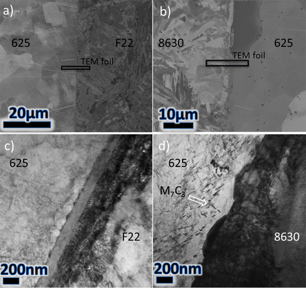

For microstructural analysis by TEM, a sample coupon was electro-discharge machined from each of the F22-Alloy 625 and 8630-Alloy 625 joints (joints 2 and 3).  The as-welded specimens were heat-treated for 10 hours, following the same heating profile as for the SENB specimens. TEM thin foils were milled from continuous interface regions (Fig 4a and b). TEM inspection revealed the presence of predominantly chromium based M7C3 carbides within the planar region adjacent to the interface in the 8630 specimen (Fig.4d). For the F22-Alloy 625 interface, the planar zone did not exhibit the same precipitates (Fig. 4c).  The M7C3 carbides may form due to diffusion of carbon from the parent steel during PWHT. As the 8630 joint has a significantly higher carbon content, M7C3 is likely to nucleate faster than in the F22 material. With longer heat-treatments, a similar band of M7C3 might be expected within the planar region of the F22 sample.
Figure 4 – Images of the dissimilar joints in the 10h PWHT conditions. a) SEM image of the F22-625 (joint 3) showing TEM foil region, b) Ion beam image of the 8630-625 (joint 2), c) TEM image of F22-625 interface region and d) equivalent TEM image of
Figure 4 – Images of the dissimilar joints in the 10h PWHT conditions. a) SEM image of the F22-625 (joint 3) showing TEM foil region, b) Ion beam image of the 8630-625 (joint 2), c) TEM image of F22-625 interface region and d) equivalent TEM image of 8630-625 interface region.

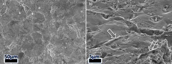

Fractography of SENB specimens from PWHT investigation: The 8630-Alloy 625 specimen (joint 2) was selected for SEM analysis in the as-welded and PWHT conditions. Though in-depth fractography of these samples is ongoing, the as-welded specimens clearly exhibited different fracture morphologies from the equivalent PWHT specimens.
Both specimens exhibited occasional regions of flat crater-like failure as described in Fig.8, however, the as-welded specimen showed a greater surface area of flat interfacial fracture. An example of this is shown in Fig.12a, an image of the steel side of the SENB fracture surface. Penetration of molten weld metal between the HAZ grains during welding, known as ‘prior austenitic grain boundary penetration’, is indicated in the tilted image, Fig.12b.
Figure 12 – Images of the 8630-Alloy 625 SENB fracture surface (steel side) in the as-welded condition. A) A typical region of interface disbonding. B) Higher magnification, tilted image of the disbonded region. Arrows indicate prior-austenite grain
Figure 12 – Images of the 8630-Alloy 625 SENB fracture surface (steel side) in the as-welded condition. A) A typical region of interface disbonding. B) Higher magnification, tilted image of the disbonded region. Arrows indicate prior-austenite grain boundary penetration.
Figure 13 – Images of the 8630-Alloy 625 SENB fracture surface (weld side) in the 10h PWHT condition. A) A large region of cleavage-like fracture. B) Higher magnification image of cracking within the cleavage-like region.

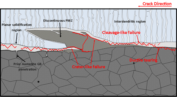

As the stress is applied, the dominant cleavage-like failure mode appears to represent a low energy crack path. In the presence of a discontinuous PMZ, or perturbation in the interface, the crack path is deflected away from the direction of applied stress. The crack remains close to the interface between the planar solidification region and steel-rich material, creating the crater-like morphology. Although still under investigation, it is apparent that the as-welded specimens showed more flat fracture, compared to those which had received PWHT.
It is also possible that the lath-like, martensitic regions in the discontinuous PMZ acted to reduce the amount of carbon within the adjacent planar solidification regions, so that there was less M7C3 carbide growth and thus a reduced propensity for crack-linking along carbide-matrix interfaces.
Cracks may develop ahead of the primary crack-front, as demonstrated in part I of the paper. Nevertheless, failure occurs across the discontinuous PMZ, as a means of linking cracks in planar solidification, low-energy, carbide rich regions. As a result, crater-like failure can exist at different points; above and below discontinuous PMZ regions, as failure mode transitions from cleavage-like to flat, crater-like failure and vice versa. The observations of crack path characteristics for the retrieved joints are illustrated, schematically, in Fig.15.
Figure 15 – An illustration of the failure modes in the retrieved, subsea specimens with PWHT.
Whilst this may be the case for the retrieved subsea specimens that have had a typical, commercial heat treatment, this may not be the case for the joints fabricated for the PWHT investigation that have undergone both longer and shorter PWHTs. Indeed, the resistance to crack growth for the F22-625 and 8630-625 interfaces showed a bi-modal split in response to an applied stress, as the length of PWHT is varied. In the 8630-625 joint, it was possible to see the importance of PWHT; the 1 hour of tempering almost tripled the resistance to crack growth. The low PWHT time may avoid the formation a critical concentration of carbide in the planar solidification region through diffusion of carbon from the parent metal.
In the 8630 joint, 10 and 100 hours of PWHT resulted in little difference in mechanical response. It is possible that the critical carbon concentration to form a continuous band of M7C3 is reached soon after 1 hour of heating. Further heating may act to widen the width of the carbon saturated band, effectively increasing the depth into the planar solidification region at which M7C3 carbide, and hence cleavage-like failure, can occur.
In the F22-Alloy 625 joint, 1 hour of PWHT provided a similar improvement in properties to the 1 hour of PWHT in the 8630 interface, Fig.3. 10 hours of PWHT, however, resulted in a much higher resistance to crack growth in the F22-Alloy 625 system. The F22 system has a much lower carbon content (0.15 wt%) compared to the 8630 (0.33 wt%) and is therefore likely to require longer PWHT times to achieve similar carbon concentrations within the planar solidification region. Fenske et al [7,8] compared F22-Alloy 625 and 8630-Alloy 625 butterings in the 10 hour PWHT condition by TEM. They found that the planar region in the 8630 specimen was densely packed with chromium based M7C3 carbide but the same was not true of the F22 buttered forging. This supports the TEM findings described in Fig.4. Thus, for the F22-Alloy 625 system, 10 hours of PWHT is sufficient to temper the HAZ without forming the critical carbides. This observation further explains the response of the F22-Alloy 625 100 hour PWHT R-curve. At such an extended PWHT, M7C3 carbide may have nucleated, reducing resistance to crack propagation. In order to establish whether or not this hypothesis is true, in-depth fractography must be performed on the 10 and 100 hours F22-Alloy 625 specimens, as the crack paths are likely to differ due to the phase differences within the planar region.
