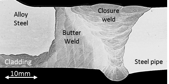

Figure 2 - A photomacrograph of a cross-section of a commercially produced 8630-625 dissimilar weld (8630 hub forging shown on the left).
