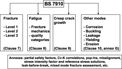

Following the publication of PD6493:1991 and continuing throughout the 1990s, the WEE/37 Committee continued to work on improvements to the document and an extensively revised edition has been first published in 1999 as BS 7910. Following feedback from users in late 1999/early 2000, several typographical errors and technical inconsistencies were corrected and a revised version appeared in 2000 [2] .
BS 7910 includes extensive modifications to the fracture assessment procedures (Clause 7), together with modifications to the fatigue assessment procedures (Clause 8). A completely new chapter (Clause 9) has also been added, covering assessment of flaws in plant operating at high temperature, see Fig.1.
Fig.1. BS 7910 overall structure
The document has been completely re-written to improve clarity and usability, and to incorporate modern flaw assessment technology, including a number of methods originally published in revision 3 of the R6 procedure. Since feedback from users of PD6493 indicated that the section dealing with stresses caused confusion, in BS 7910 special attention was paid to the description of the stresses to be determined and how they are actually used in an assessment. The changes include a new definition of peak stress, to mean the highest stress at a structural discontinuity rather than the elevation in stress it causes. The relevant parts of the fracture and fatigue assessment clauses have also been revised to reflect the changes introduced into BS 7910.

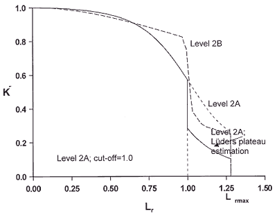

As in PD6493:1991, there are three assessment procedures, or levels, available for a fracture assessment. Flow diagrams have been included to guide users through them. The Level 1 fracture assessment procedure in BS 7910 is unchanged, but is renamed the 'Simplified Assessment' procedure. The Level 1 procedure is based on a conservative Failure Analysis Diagram (FAD). The Level 1 FAD has K r (or √ δ r), S r co-ordinates, where K r (or √ δ r) is the ratio of applied crack driving force to fracture toughness and S r the ratio of applied stress to flow strength (where flow strength is mean of yield and tensile strength hence incorporating some plasticity). The graphical procedure (the CTOD design curve approach, originally presented in PD6493:1980) becomes Annex N in BS 7910.
Level 2 remains the 'Normal Assessment' method for cases where single-value measurements of fracture toughness (e.g. K Ic, δ mat) are available. The PD6493:1991 Level 2 failure assessment method (strip yield model) is now superseded by Levels 2A and 2B; the choice between the two depends on the type of stress-strain data available for the material in which the flaw is situated. Level 2B is used if the relevant full stress-strain curve is available. Guidance has been included regarding the derivation of Level 2A FAD in cases of discontinuous yielding developed in the recently completed European project SINTAP [7] (Structural Integrity Assessment Procedures for European Industry), as follows:
For materials which exhibit a yield discontinuity (often referred to as Lüders plateau) in the stress/strain curve (i.e. any curve which is not monotonically increasing), or for which it cannot be assumed with confidence that no discontinuities exist, either a cut-off value for L r (the ratio of applied stress to yield strength) of 1.0 should be applied or Level 2B should be used. If it is impractical to determine a Level 2B FAD, the Level 2A FAD at and beyond L r = 1.0 can be estimated [7] using:
√ δ r(L r=1) or K r(L r= ) =
{1 + E ε L/ σ u Y + 1/[2 (1 + E ε L/ σ u Y)]} -0.5
where
ε L = 0.0375 (1 σ u Y/1000) is the estimated length of the Lüders plateau (this relation is restricted to σ u Y < 800N/mm 2), (Note)
(Note: There is a typographical error in BS7910: 1999 (Amendment 1) which states a validity limit of 976N.mm 2; users of BS7910 should correct this limit to 800N/mm 2)
σ u Y is the upper yield strength (if this is unavailable, it is conservative to use the yield or 0.2% proof strength),
and
√ δ r(L r>1) = √ δ r(L r= ) L r (N-1)/2N
or K r(L r>1) = K r(L r= ) L r (N-1)/2N
where
N = 0.3 (1 - σ Y/ σ u) is the lower bound strain hardening exponent estimated [7] from the yield to tensile strength ratio, σ Y/ σ u.
For continuous yielding, the failure assessment line is similar to that used in PD6493:1991, Level 3. L r is now used in place of S r for plastic collapse predictions at Level 2, see Fig.2.
Fig.2. BS7910 Level 2B, material-specific failure assessment diagram

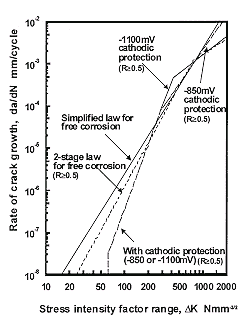

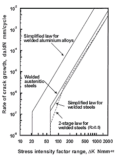

For BS 7910, the fatigue assessment clauses in PD6493:1991 were reviewed in the light of new information and experience gained from their use in practice. The main change was the introduction of new fatigue crack growth laws, based on an extensive review and analysis of published data for steels [10] . These include more precise two-branch Paris laws and allowance for applied stress ratio, R (the ratio of minimum to maximum applied stress during fatigue loading). More attention is paid to environmental influences and the new recommendations cover marine corrosion, with and without cathodic protection, and fatigue crack growth at elevated temperature. The specific cases covered include ferritic steels in air, freely-corroding in seawater and in seawater with cathodic protection (-850mV and -1100mV Ag/AgC1), see Fig.3.
Fig.3. Recommended fatigue crack growth laws in BS7910
New, simplified conservative (upper bound) single-branch Paris laws are also provided, for convenience. They relate to high R-values (R ≥ 0.5) in order to give conservative estimates of fatigue crack growth in welded structures. As in fatigue design, these are assumed to contain high tensile residual stresses and hence to experience a high effective R under any fatigue loading. The basic law for ferritic steels in air gives a slightly higher crack growth rates than the corresponding law in PD6493:1991, based on more recent experimental data obtained at R = 0.5. Apart from air, the recommended laws also cover ferritic steels in seawater and at elevated temperature.
Austenitic steels can be treated using the simplified law for ferritic steels in air, but no advice is given for other environments. New data did not justify any changes to the recommended stress intensity factor threshold values in PD6493:1991, except that a value of zero is now recommended for steels in freely corroding seawater. However, it is now strongly recommended that crack growth rate and threshold values for high R values are used when assessing a flaw in a welded structure, to allow for the influence of high tensile residual stresses.
Advice on the derivation of fatigue crack growth laws and threshold values for non-ferrous metals is also given, using correlations based on relative Young's modulus values.
Allowance has been made for the extensive evidence now available which indicates that there is no need to impose the flaw interaction criteria in PD6493:1991 in a fatigue assessment. Thus, multiple flaws are assessed separately without any consideration of flaw interaction [11,12] .

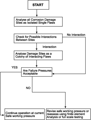

3.6.2.2. Outline of BS 7910 Annex G procedure
General procedure
The general methodology for assessing corroded pipeline is illustrated by a flow chart, as shown in Fig.4. The methods recommended in this procedure are classified into three levels of assessment, depending on required accuracy of the assessment and the level of information available. Limitations of the methods and safety factors recommended are included in Annex G of BS 7910.
Fig.4. BS7910 Annex G assessment procedure for assessment of corroded pipe and pipelines
Level 1 Corrosion assessment
A set of rules identifying longitudinal and circumferential flaw interaction is used for grouping corrosion flaws.
The flaw groups are then treated as single isolated flaws and are assessed using a simple equation, which only requires limited information on material properties and defect sizes. A relation is presented in Annex G to determine safe working pressures using actual or specified minimum tensile strength values for the pipe material and the total projected axial length and maximum depth of the flaw. This relation is based a large parametric database of failure pressures, predicted using non-linear various pipe sizes, pipe grades, defect configurations and defect sizes, and validated against over 100 full-scale burst tests. The estimated safe working pressure is correct only if there is no flaw interaction.
Level 2 Corrosion assessment
Two engineering methods have been developed for the Level 2 assessment dealing with corrosion interaction (Level 2a) and with complex-shaped defects (Level 2b). As further validation of Level 2b is required, it has not been included in BS 7910 Annex G.
With respect to Level 2a, a flaw group may include a number of separate but adjacent corroded areas which interact. The failure pressure is higher than that for a single flaw configuration of the same dimensions.
A safe working pressure is determined by the lowest pressure value predicted from assessments of all combinations of adjacent flaws. Each of the assessments assumes the total length of the defect group but an equivalent depth. This assessment requires additional information on flaw spacing. The method has been validated against a large number of failure predictions (using FEA) for equally sized, axially-separated flaw groups and some pipe burst tests.
Level 3 Corrosion assessment
As the most advanced method, included in BS 7910 Annex G, non-linear FEA together with a validated criterion is recommended for detailed assessment if full material information and flaw configuration are available. The failure pressure of a corrosion model is deemed to have been reached at the load where the von Mises equivalent stress value throughout the remaining ligament reaches the tensile strength of a material. This failure criterion has been well validated. Such analyses generally give accurate failure predictions (within ±5%).

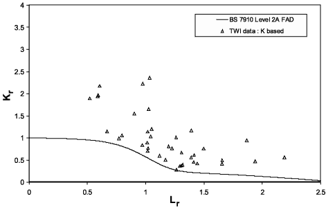

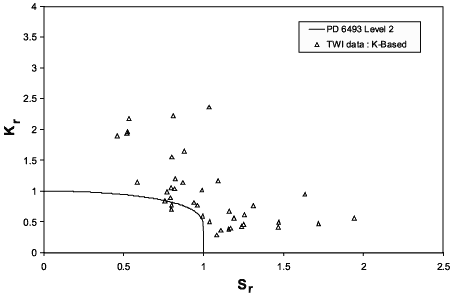

4. Validation of BS 7910 fracture assessment procedures using TWI wide plate data
Validation of the BS 7910 fracture and collapse assessment procedures has been carried out against TWI experimental data of large-scale wide plate fracture tests. Relevant small-scale fracture toughness specimens were used to provide appropriate input data. Eighty-two wide plate specimens have been assessed at Level 2A. The TWI software Crackwise 3 which automates the BS 7910 assessment procedures has been used to carry out the appraisal. The wide plate tests cover a wide range of materials, flaw type/location, load configurations and test temperatures. Materials used were pressure vessel steels, C-Mn structural steels, pipeline steels, aluminium alloys and type 316 stainless steels and their weldments. Flaw types included through thickness cracks, semi-elliptical surface cracks, extended long surface cracks. The flaw location was in parent material, weld and HAZ. Applied loads included externally applied tension, bending or combined tension and bending and welding residual stresses. The test temperatures covered the entire transition range from the lower to the upper shelf.
The failure points of all eighty-two wide plate specimens were predicted correctly by BS 7910 Level 2A assessment procedures, and both K-based and CTOD based assessment routes produced conservative predictions. The K-based results by BS 7910 are presented graphically in Fig.5a. In comparison, assessments to PD6493 Level 2 led to some non-conservative failure predictions, see Fig.5b. It was well known that the PD6493 Level 2 FAD can result in marginal failure predictions in the 'knee' region of the FAD for high work hardening materials. This was one of the reasons to discontinue its use in BS 7910.
(a) to BS7910 Level 2A;
(b) to PD6493 Level 2
Fig.5. Fracture assessment of TWI wide plate data results based on K or J fracture toughness values: (a) to BS7910 Level 2A; (b) to PD6493 Level 2.
Figure 5a shows that the degree of conservatism in the BS 7910 fracture assessment procedure varies and can be quite small. This implies that to ensure a safe deterministic fracture assessment, conservative approaches must be adopted. The current assessment results have been obtained under the following conditions: fracture toughness data were obtained from high-constraint SENB specimens; the minimum value of three tests or the second lowest value of six tests were employed. If the population of fracture toughness tests is large enough to enable a statistical analysis, the mean minus one standard deviation value was used. Caution is advised when using maximum load fracture toughness data for high work hardening materials; rather, it is recommended to apply Level 3 tearing assessments.
In the as-welded condition, residual stresses must be considered not only for cracks located in weld metal and HAZ, but also for cracks close to the weld. The reduction of welding residual stresses after proof tests should be according to BS 7910 Annex O. As recommended in BS 7910 for cracks in the weld metal, a conservative approach is to use the lower properties of parent and weld metals for calculating the collapse parameter L r, even if the weld metal over-matches the parent material as recommended in BS 7910 Annex I. It is recommended to use only validated and well-established stress intensity factor and collapse load solutions, and to be aware of the validity range of solutions for unusual geometries given in BS 7910 Annex M and P.
