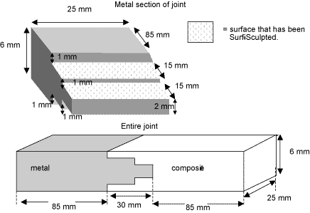

In order to demonstrate the flexibility of the Comeld technique, Comeld joints have been produced using different materials, different production techniques and different joint designs. Table 1 provides a description of the joints that were manufactured for the research presented in this paper, with joint dimensions provided in Fig.2.
Table 1 Description of joints manufactured
Joint numberMetalCompositeManufacturing method
1 Stainless steel 316L Glass fibre reinforced plastic (GFRP) from E-glass non-crimp fabric ELT-850 and EBX-602 with Reichhold Dion 9102 500 vinylester resin Vacuum infusion
2 Titanium 6Al-4V Carbon fibre reinforced plastic (CFRP) from Hexply8552 prepreg with IM7 carbon fibre Autoclave
Fig.2. Dimensions of double step joint
The steps taken to produce the Comeld joints were:
1. The metallic part of the joint was machined to the correct shape for the style of joint to be formed, as shown in Fig.3.

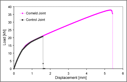

The results of tensile testing of control and Comeld joints between stainless steel and GFRP are given in Tables 2 and 3 respectively. Representative load-displacement curves for the control and Comeld joints are also given in Fig.9. It can be seen that the Comeld specimens had a higher load carrying capability and exhibited a much greater extension before failure than the control specimens. On average, the Comeld specimens absorbed more than five times as much energy as the control specimens before failure.

The loading history for the control specimens and Comeld specimens ( Fig.9) was identical until the sudden failure of the control specimens. As shown in Fig.10, the failure of the control specimens occurred at the interface between the composite and the metal.
In the case of the Comeld specimens, whitening was seen at load values slightly below the failure load for the control specimens within the composite section of the joint near the end of the metal section (section 'A' in Fig.11). This whitening was matrix cracking within the composite. It is thought delamination of the composite prior to failure was prevented by the through thickness stitching of the non-crimp fabric. Instead, progression of damage in the form of matrix cracking was seen and heard until the failure point, when dramatic delamination was accompanied by fibre and matrix fracture.

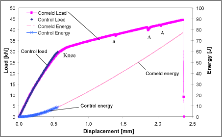

By comparing the test data for control and Comeld joints it can be seen that the Comeld joints outperformed the control joints in many ways. The Comeld specimens had a higher load bearing capability and exhibited considerably more extension during loading than the control specimens. Further examination also reveals that the standard deviation in the test results for the Comeld joints are significantly smaller than those for the control joints. This higher degree of consistency is potentially significant for designers who need to design joints between composites and metals since it provides confidence in the system which may allow a decrease in design allowables.
Fig.12. Tensile test data for control and Comeld joints between titanium and CFRP
Figure 12 shows data from one control joint and one Comeld joint. It can be seen that the two joints have similar loading characteristics initially although the Comeld joint continued carrying load long after failure of the control joint. After the 'knee' in the Comeld load displacement curve, which is thought to be a characteristic of the double step joint, three dips can be seen in the curve. These are depicted using the symbol A. These dips corresponded to damage, which was heard in the form of cracking and subsequently seen as delamination in the composite, initiating at the steps in the joint. It can be seen that despite the damage and dip in the curve, the joint continued to carry load.
Tables 4 and 5 and Fig.12 also demonstrate the exceptional energy absorption characteristics of Comeld joints when compared to control joints. The average values indicate that Comeld joints absorbed in excess of 13 times more energy before failure than the control joints.

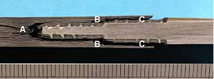

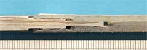

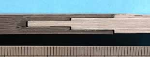

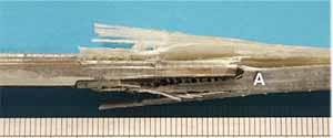

The failure modes of the two types of joints were extremely different. The control joint shown in Fig.13 was observed to fail suddenly, without warning, at the interface between the composite and the metal. By contrast, damage was seen to initiate in the composite section of the Comeld specimen, shown in Fig.14, at the end of the titanium (area A). Cracks and delamination propagated through the composite, absorbing energy but without significantly affecting the load carrying capability. The second stage of damage initiated at the intersection of step 1 and step 2 in the titanium sample (areas B), again allowing cracks and delaminations to propagate through the composite. Final failure occurred with delamination of the composite and plastic deformation of the protrusions in step 2, designated 'C'. All of these damage mechanisms described absorbed energy and gave audible and visual signs that, in a real structure, would allow detection of a problem before failure.
Fig.13. Failed control joint between titanium and CFRP
Fig.14. Failed Comeld joint between titanium and CFRP

Damage occurred in the Comeld specimens in the form of plastic deformation of the metal protrusions and matrix cracking and fibre damage within the composite. This damage contributed to the increase in energy absorbed before failure of the joint. It is thought that the through-thickness stitching in the non-crimp glass fabric prevented delamination, which might have occurred in alternative fabric forms.

As with the previous materials system, the critical difference between the control and Comeld specimens was the failure mode. The control specimens failed without warning, at the interface between the composite and the metal. By contrast, the Comeld specimens prevented interfacial failure, exhibited damage, in the form of resin cracking and delamination that could be seen and heard but did not affect the load carrying capability, quite a long time before failure finally occurred in the composite material.
