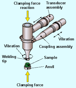

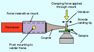

Ultrasonic joining (used extensively in the plastics industry) has been applied to such ceramic-metal combinations as alumina-aluminium, alumina-stainless steel, zirconia-steel and glass-ceramic (cordierite based)-copper. Typical applications include batteries, thread guides, textile cutting equipment and heavy-duty electrical fuses. The advantages of the process are the very fast joining times (less than 1 second), surface preparation is not critical (which is contrary to almost every other ceramic joining process) and the lack of melting and intermetallic formation. However, for joining of hard metals such as steel, soft, deformable interlayers are needed. A limitation of this technique as applied to ceramics is that only films/thin sheets of metal can be joined to a ceramic.
Typically, the technique employs a transducer assembly operating at ~20kHz, which is the source of the ultrasound, coupled to a sonotrode. The sonotrode tip is placed in contact, (usually under a clamping load of 1-10N/mm2) with the workpiece, Fig. 3. The heat generated is localised at the interface (up to 600°C when using aluminium interlayers).
Fig. 3 Set-up for ultrasonic welding
The bonding mechanism relies on the vibratory shear stress of the metal exceeding its elastic limit, coupled with the breakdown of surface oxide films, thus exposing atomically clean metal. The clamping force exerts plastic deformation on the metal, which increases the interfacial contact between the metal and ceramic. Then, mechanical keying occurs across the interface and the joint is formed, perhaps with a contribution from chemical interactions.

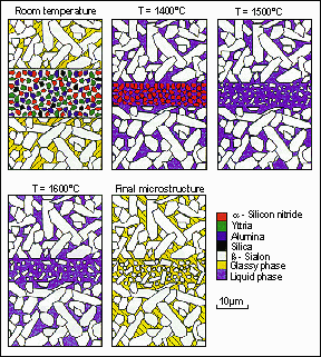

TLPB has the ability to produce a bond at a lower temperature than that at which it will be ultimately used. The technology is currently being adapted for a number of ceramics using 'interlayers' based either on glasses, (such as oxynitrides for joining SiAlON) or pure metals or alloys, (such as Ge and Ge-Si for joining SiC and SiC/SiC composites). The schematic representation for bonding in the SiAlON system is given in Fig. 4. A mixture of silicon nitride, yttria, silica and alumina are applied (by spray coating) to one surface of the joint. As the samples are heated to 1600°C, a load of 2MPa is applied. Joint formation occurs at this temperature over a period of 10 to 80 minutes. At ~1400°C, the oxide components react to form a Y-Si-Al-O liquid phase. This leads to densification and sintering. The silicon nitride then dissolves into the liquid, boosting both Si and N contents and altering the composition to Y-Si-Al-O-N. At the same time, beta-SiAlON grains grow and form an interlocking network a
Fig. 4 Transient liquid phase bonding process (after Walls and Ueki, J Am Ceram Soc, Vol 75, 1992)
The weakness of the TLPB method is that a favourable reaction between the interlayer and substrates is required. For silicon nitrides, the glassy interlayer must redistribute itself and penetrate the adjoining microstructure.
