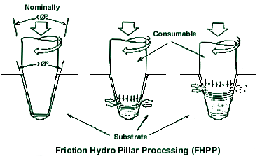

Friction hydro pillar processing (FHPP) is a comparatively recent solid-phase welding technique [1,2,3]. Invented at TWI, this technique is the focus of considerable R&D interest because of its potential in fabrication and manufacturing where it offers a number of novel production routes. The FHPP technique is still under development, but already shows promise for joining and repairing thick plate in ferrous and non-ferrous materials. Conventional fusion welding of thick section fabrications involves lengthy processing sequences and with some process large volumes of consumable material. In contrast, use of the FHPP welding technique should provide a reduction in joint preparation and weld filler metal, which will lead to significant cost savings.
Fig. 1 Basic principle of friction hydro pillar processing (FHPP)
The FHPP technique involves rotating a consumable rod co-axially in a circular hole, under an applied load to continuously generate a plasticised layer. The layer consists of an almost infinite series of adiabatic shear surfaces [4]. The main features of the process are illustrated in Fig. 1. During FHPP the consumable is fully plasticised at the frictional interface across the bore of the hole. This interface travels through the thickness of the workpiece. The plasticised material develops at a rate faster than the feed rate of the consumable rod. This means that the frictional rubbing surface rises along the consumable to form the dynamically recrystallised deposit material. The plasticised material at the rotational interface is maintained in a sufficiently viscous condition for hydrostatic forces to be transmitted, both axially and radially, to the bore of a parallel sided hole enabling a metallurgical bond to be achieved. Since this material is being forced hydrostatically into the surrounding bore, the diameter of the deposit material is nominally greater than the feedstock material.

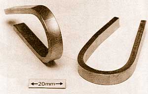

Work at TWI has shown that good mechanical integrity can be achieved: Figure 7a shows typical hammer bend tests and Fig. 7b shows typical tensile test, with failure away from the interface and heat affected zone (HAZ). Impact tests have demonstrated that a significant improvement in toughness properties can also be achieved, e.g. low carbon steel consumable material before FHPP gave impact properties of 31 Joules kV while the same material after FHPP gave deposit core impact properties of 115 Joules kV.
Fig. 7a FHPP hammer-bend test specimens

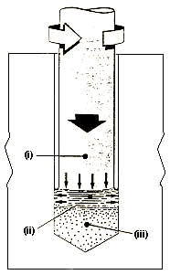

Friction stir welding (FSW) is a new welding technique invented and developed at TWI [7]. This technique has already made an impact on the aluminium producer and aluminium user industries and offers great potential for sectors such as ship building, automotive and aerospace. Friction stir welding is a technique which allows alloys based on aluminium, lead, copper and some thermoplastics to be butt welded continuously with a non-consumable tool. The technique brings the benefits of solid-phase friction welding to material forms e.g. plate, previously regarded as unsuitable[8-12].
Fig. 8 Basic principle of friction stir welding
Friction stir welding is a continuous hot-shear process involving a non-consumable, rotating probe of harder material than the substrate itself. The basic principle of the process is shown in Fig. 8. Essentially, a portion of a specially shaped rotating tool is entered between the abutting faces of the workpiece (i.e. the joint). The tool's rotary motion generates frictional heat which creates a plasticised region (a local active zone) around the immersed portion of the tool, the contacting surface of the shouldered region on the tool and the workpiece top surface. The shouldered region provides additional friction treatment to the workpiece as well as preventing plasticised material from being expelled. The tool is then steadily moved along the joint line, with the plasticised zone cooling behind the tool to form a solid-phase joint as the tool moves forward.

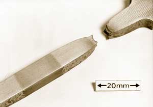

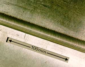

Figure 9a shows an aluminium alloy test plate. Figure 9b show a detail of the weld surface appearance, with part circular ripples. These ripples are caused by the final sweep of the trailing edge of the shouldered region of the rotating tool and point toward the start of the weld.
Fig. 9a Friction stir welded aluminium alloy test specimen
Fig. 9b Detail of surface appearance of as welded test specimen
Successful trials have been carried out on wrought aluminium, many wrought aluminium alloys and lead. Preliminary trials with copper have also shown promise. Test samples have been subjected to mechanical tensile and hammer-bend testing with good mechanical properties being achieved, Fig. 10 shows hammer bends and tensile tests. In addition, good fatigue properties have been achieved [12]. The metallographic examination of FSW specimens revealed the presence of a fine-grain microstructure.
Fig. 10 Tensile tests of friction stir welds show failure away from the original joint. Hammer-bend tests indicate good bend ductility

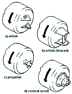

The use of a profiled probe similar to a screw thread or helix has resulted in improved friction stir welding quality [13]. Research work is being carried out at TWI to evaluate a range of probes which are designed to improve the flow of plasticised material around and through the probe itself, as illustrated in Fig. 11.
Fig. 11 Tool geometry
The rationale for the above tool geometry can best be understood from the following statements:
  • That the material being deformed around the probe can perhaps be treated in much the same way as a solid being extrude by friction [14].
  • That the natural dynamic orbit (eccentricity) of the rotating tool allows plasticised material to pass around the probe. For every rotary machine there must be, to a greater or lesser extent, an inherent dynamic orbit about whichthe theoretical centre moves (no machine ever built can maintain true concentricity).
  • ( That orbiting type (probes with very sight bias off-centre) and paddle type probes may allow material to flow more easily around the probe because the region of frictional effect is greater than its displacement volume.
  • That the probe must pass through plasticised material - conversely that the plasticised material must pass around the probe. In the case of a whisk type tool this would additionally allow some of the plasticised material to passthrough the probe. Whisk type tools displace less material than solid tools of similar diameter.

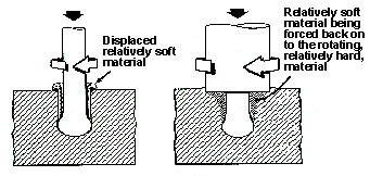

Friction plunge welding involves immersing a relatively hard material in a relatively soft material [14,15]. Relative motion between the workpiece components generates friction heat which creates a localised plasticised zone in the softer material. Since the harder material is pre-shaped to form re-entrant features (a dovetail effect) and is not consumed or deformed, the plasticised material flows into these re-entrant regions. After motion is stopped, the plasticised layer coalesces to form a mechanical interlock and depending on the materials being joined a metallurgical bond may also be formed.

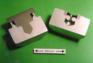

The principle of friction plunge welding is shown in Fig. 12. A removable constraint or containment shoulder forces the relatively soft plasticised material back on to the relatively hard shaped component. This technique provides a degree of mechanical interlock which should help reduce the risk of catastrophic failure in service, especially at elevated temperature were dissimilar materials are susceptible to the formation of brittle intermetallic compounds. Figure 13 shows the typical re-entrant features of the friction plunge welding technique.
Fig. 12 Principle of friction plunge welding
Fig. 13 Macrosection showing re-entrant features
Friction plunge welding trials at TWI laboratories confirm that excellent mechanical integrity can be achieved. Metallurgical examination has shown that the joint interface region is free from defects and that the immersed, relatively hard material is surrounded by a recrystallised zone of the relatively soft material.
