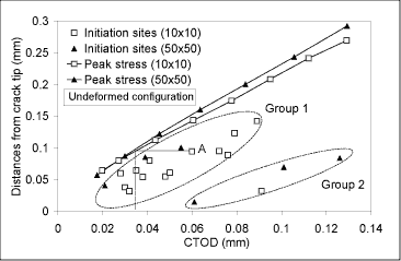

Fractographic analyses were carried out on a scanning electron microscope (SEM) to investigate the conditions of cleavage initiation. Most specimens of Set 1 and a few specimens of Set 2 were selected for comparison, particularly specimens that fractured at a high or a low CTOD. The main initiation point was determined using river lines patterns and its distance from the crack tip was measured. In all cases, it was found that cleavage initiated at grain boundaries. However, notable differences in the initiation conditions existed for specimens with toughness lying at the extremes of the CTOD values range. In Set 1, the very low toughness of one specimen ( δc = 0.006 mm) is explained by an unexpected early intergranular failure that then changed into transgranular cleavage. For specimens with the highest CTOD values, the initiation points were found to be located closer to the crack tip than in most specimens with lower CTOD, in regions where microductile behaviour (microvoids) began to occur.
Finite element (FE) models for both geometries [7] were used to infer the original location of the initiation sites in the specimen before loading. For simplicity, the initiation points were assumed to lie in the plane of the fatigue crack. The distance from the crack tip to the peak stress occurring on the crack plane was also determined in the undeformed configuration at different CTOD values. Both distances are plotted against the critical CTOD values for both geometries in Figure 3 (no data point for specimen 2 of Set 1 is plotted, as no clear initiation point could be found in the intergranular fracture zone). Figure 3 clearly shows that initiation points can be divided into two groups with different nucleation conditions: one, containing most results (Group 1), the other one containing only the highest δc-values of the two geometries (Group 2). Group 1 lies above Group 2, expressing the tendency of cleavage nucleating nearer to the crack tip at higher CTOD. Secondly, all initiation points lie below the 'peak stress lines', which indicates that all initiation points were located between the crack tip and the peak stress location. There is also a general tendency for the distances of both groups to increase proportionally with CTOD, or equivalently with peak stress location distances, so that both groups remain at an approximately constant distance from the peak stress position.
Initiation site and peak stress distances
Fig. 3. Initiation site and peak stress distances v's δ
These observations confirm some well-known results [8] : cleavage is stress-controlled and sufficient plastic strain is needed to achieve nucleation. The fact that cleavage is stress-controlled implies that nucleation sites are to be expected around the maximum stress value, which is the case, since the initiation point location follows the peak stress location as it moves away from the crack tip as loading increases. However, initiation points are not found at the peak stress location, but closer to the crack tip, which expresses the necessity for sufficient plastic strain to nucleate a microcrack, yet still enough tensile stress to propagate it. Further supporting evidence is the fact that all initiation points have 'experienced' the maximum stress at some time during the specimen loading, but this was not coincident with failure. Indeed, ahead of a blunting crack in SSY, the maximum tensile stress stays essentially constant as it spreads with increasing load. Any point of the specimen which 'experienced' the peak stress will therefore have been subjected approximately to the maximum tensile stress value developing in the specimen. The CTOD value at which the peak stress position coincided with the later initiation point location can be inferred from Figure 3. It corresponds to the CTOD value at the intersection between the relevant peak stress line and a horizontal line passing through the data point of interest. For data point A ( δc = 0.06 mm) in Figure 3, this gives a CTOD of 0.035 mm. Figure 3 links with Figure 4, showing the maximum principal stress - equivalent plastic strain history up to failure for point A evaluated from FE calculations. Finally, it is noted that a great deal of the δc-results scatter is due to the varying location of the critical nucleation sites relative to the crack tip, implying both that nucleation leading to total failure is rare and that the critical nucleators are scarce in the present material.

For every specimen examined on the SEM, a unique fracture origin was found, which is a prerequisite to the correct application of Eqns. 1 to 4 to describe the scatter in toughness results. However, considering the small specimen fracture tests, at least three different nucleation processes could be identified, namely: an intergranular failure type transforming to cleavage, a transgranular type with moderate plastic strain (Group 1) and a transgranular type with large plastic strain and microductility (Group 2). It was mentioned in the previous section that Eqns. 1 to 4 were not derived to account specifically for the change in plastic strain inside the plastic zone. Also, each equation is meant to address only one nucleating process at a time, not all of them (as was done in the preceding section), unless they are modified to do so. Here, the choice is made to address only the δc-values originating from the main nucleation mechanism, i.e. these of Group 1. The specimens that were not analyzed on the SEM are assumed to belong to Group 1, given that their δc-values fall in its range. A fit to Eqn. 2 of these δc-values only gives the following ML estimates: Symbol.2 = 2.72, Symbol.3 = 0.056 and Symbol.4 = [1.87, 3.94] for the 10x10 mm 2 specimens, Symbol.2 = 2.46, Symbol.3 = 0.041 and Symbol.4 = [1.67, 3.63] for the 50x50 mm 2 specimens. Once again, the estimated values for α approach the theoretical value of 2, but the size effect is this time more apparent.
