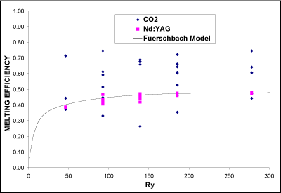

The melting and transfer efficiencies were calculated following the model established by Fuerschbach, [6] Fig.2. The melting or fusion efficiency ( η melt ) is defined as the ratio of the energy used for melting the metal (eq. [5] ) and the heat input. The heat input is equal to the output laser energy (3.5kW for all the experiments) multiplied by the transfer efficiency ( η transfer ). Using Fuerschbach's material-independent model, [6] the energy transfer efficiency can be calculated given the molten (or fusion) area, the total incident power and the welding speed. This model assumes a maximum melting efficiency of 48%.

As a general trend the melting efficiency approaches the maximum theoretical value of 48% for most of the results, Fig.2. This is an expected result since the melting efficiency, as defined by Fuerschbach [6] , is dependent on a dimension-less parameter (R y) given by the welding speed, laser power/irradiance and material properties. Only when the speed is decreased to 0.25m/min (in reduced pressure conditions) does the melting efficiency decrease to less than 40%.
