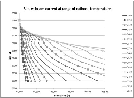

It is a single step from the simple characterisation approach above to one where the 'working envelope' of a potential solution is fully explored and quantitatively characterised. For example, to fully assess the performance of a gun design the emerging beam current and brightness can be assessed for a range of cathode temperatures and bias (Wehnelt electrode) potentials.
This is executed as two nested loops in macro code so that for each cathode temperature the full bias potential range is explored and at each combination of cathode temperature and bias potential the emerging beam current and beam brightness are recorded.

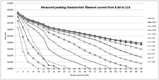

An example for a triode gun with a directly heated filament is shown in Fig.1. This shows the peaking characteristic curves (beam current vs bias voltage) for a wide range of cathode temperature. Fig.1(a) shows the curves predicted by the models (each point on the graph is a distinct model solution), and Fig.1(b) shows the measured characteristics over a range of filament currents (each current relating to a cathode temperature - the form and absolute values of these curves are in good agreement.
Fig.1(a) Gun peaking for a range of cathode temperatures (Kelvin)
Fig.1(b) Gun peaking measured for a range of filament currents (A)
