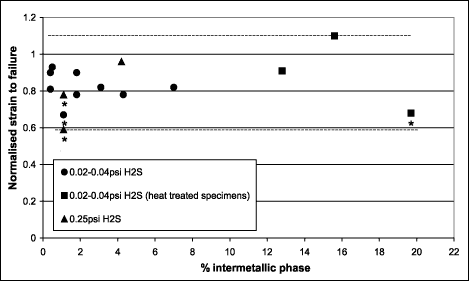

Fig.4. Variation of normalised strain to failure in SSRT tests in sour media with maximum local volume fraction of intermetallic phase *specimen showed environmentally induced cleavage on the fracture face

The specimens showing areas of cleavage fracture spanned the range of H2S partial pressure and the range of maximum volume fraction of intermetallic phase: (i) 0.25psi and 1% (two examples) (ii) 0.02psi and 1%, and (iii) 0.04psi and 19.5%. Example (ii) corresponded to a specimen containing a small subsurface weld flaw, adjacent to which the area of cleavage had developed. The other examples represent (i) a specimen at the low end of the intermetallic range studied, tested at the highest partial pressure of H2S and (ii) the specimen with the highest level of intermetallic phase, tested at a low partial pressure of H2S. In each case, the cleavage was localised and at or close to the surface, being subsurface in two instances. There was no evidence of secondary cracking on any of the specimens but some very shallow surface etching was observed on the gauge lengths of specimens tested at the highest H2S level.

The results indicate no link between the point counted volume fraction of intermetallic phase and the sensitivity to environmental cracking for the conditions tested. The size of the intermetallic phase particles was similar in each specimen, being of the order of 1-5µm, and largely defined by the width of the ferrite units in the TIG root weld metal examined. Although some specimens had much lower levels of intermetallic phases than others, all showed a tendency to contain clusters of particles. Other authors have found that the intermetallic particle size is more important than the volume fraction in terms of influence on measured properties, notably pitting corrosion resistance and toughness [6] . It is suggested that a similar relationship may apply in the case of environmental cracking in sour environments also, although particle size was not varied significantly in the present study.
The observations made suggest that environmental cracking in the SSRT test was hydrogen related, giving rise to patches of cleavage in the ferrite phase. This cleavage presumably initiated at a fractured intermetallic particle or a group of particles, with the hydrogen originating from corrosion. However, no significant corrosion was observed on the specimens, just some shallow surface etching. This might have provided sufficient hydrogen for small areas of cleavage fracture but it is also possible that localised crevice attack at cracked intermetallic particles on the surface may have been involved. The location and shape of the patches of cleavage presumably reflected the distribution of intermetallic phase within the individual specimens. Such a cracking mechanism would be favoured by the plastic strain induced in an SSRT test. However, the test is of fairly short duration, typically 2-4 days, and for extended exposure periods, hydrogen generation and uptake may be much higher. Consequently, it is possible that a similar mechanism may operate at much lower strains over longer time periods.

The SSRT test is acknowledged as a severe test due to the forced plastic straining of the specimen. McIntyre et al [5] proposed a system of classifying SSRT test results and those specimens showing sensitivity here, with normalised strains to failure of 0.59 - 0.78, may be described on 'moderately susceptible' using this system. McIntyre et al stated that environmentally induced brittle fracture on the final fracture surface occurs in moderately susceptible materials, with ductility ratios between 0.5 and 0.75. Remaining specimens were 'immune' or 'practically immune' using the same system. It may be noted that Cooling et al [7] adopted a minimum normalised strain to failure of 0.5 for acceptability for service of 13%Cr steel for downhole applications.

  2. The normalised strain to failure in SSRT tests of all-weld metal superduplex stainless steel specimens tested in sour environments with 0.02 to 0.25psi H2S, 25% NaCl and pH = 4.0 at 100°C showed no systematic variation with the volume fraction of intermetallic phase.
  3. Some SSRT specimens showed evidence of environmental cracking in the form of small areas of cleavage fracture on the faces. These specimens gave the lowest normalised strains to failure of 0.59-0.78.
