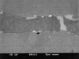

The as-received microstructure consisted of elongated islands and small clusters of austenite in a ferrite matrix. After heat treatment at 800°C/5mins, small amounts of intermetallic phase were visible at ferrite/austenite boundaries and within the ferrite ( Fig.1a). Raising the temperature to 900°C substantially increased the intermetallic content ( Fig.1b), but at 1000°C only isolated pockets of intermetallic were evident. Table 2 gives results of point counting on back-scattered electron images. The greatest intermetallic proportion, nearly 8%, was in material heated to 900°C for 2mins, whilst 1-1.5% was recorded in both the 800°C and 1000°C samples. Small 'white' islands were noted in the SEM images, often within the major intermetallic constituent, up to about 0.5% being found in 900°C samples.
1a) 800°C/5min: optical image
γ = austenite
δ = ferrite
σ = intermetallic
1b) 900°C/2min: SEM image
intermetallic - white
ferrite - dark grey
austenite - light grey
Fig.1. Intermetallic formation

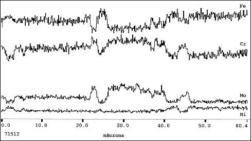

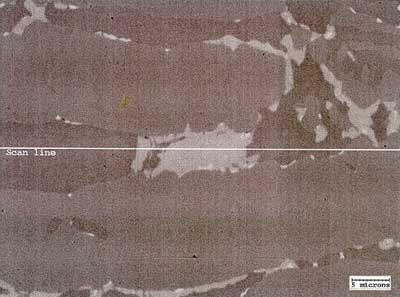

Line scans on as-received material showed the compositional differences in Table 3, as the ferrite to austenite interface was traversed; there was no compositional change within individual ferrite or austenite regions. Figure 2 shows a line scan on the 900°C/2min sample from ferrite into sigma, and back into ferrite: the Cr and Mo contents change as the sigma particle is traversed. Chi phase is also visible. There was no clear evidence of alloy depleted regions adjacent to intermetallic particles, with scans at right angles from either ferrite or austenite into the intermetallic.
Fig.2. Alloying element distribution illustrated by line scan across intermetallic region:
scan direction from ferrite → sigma → ferrite

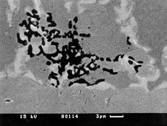

Initiation of pitting attack in the 900°C/2min sample after short term exposure to EDTA solution at 50°C took place at intermetallic phase boundaries, at both sigma and chi particles ( Fig.3). Pits initiated at a number of locations in the sample. The most common sites were at intermetallic/austenite boundaries, but the largest 'areas' of pit initiation were at groups of intermetallic particles which had formed in the ferrite. As far as could be discerned, pit growth took place in the austenite or ferrite with relatively little attack on the intermetallic particle.
3a) in austenite adjacent to chi particle
3b) in ferrite at sigma particles
Fig.3. Pit initiation sites: nominal magnification

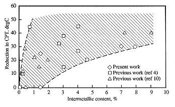

In both test solutions, the lowest values of CPT were obtained from specimens heat treated at 900°C which contained the highest intermetallic volume fractions. The present results are combined with data obtained from other work [4,10] in Fig.4, and clearly high intermetallic contents have a significant adverse effect on pitting behaviour. However, from Tables 2 and 4, heat treatment at 1000°C and 800°C both produced an intermetallic volume of fraction of 1.4%, yet the former temperature had no adverse effect on corrosion resistance, whereas the latter reduced the CPT by some 25°C. While the present results were obtained on isothermally heat treated material, it must be concluded that, at fairly low intermetallic levels as might arise during welding, there is no direct relationship between volume fraction of intermetallic phases and corrosion resistance as indicated by a critical pitting temperature in ferric chloride.
Fig.4. Relationship between intermetallic content of superduplex steels and reduction in CPT

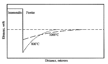

Development of a Depleted Zone
The influence of temperature on intermetallic formation and resultant corrosion resistance will reflect the diffusion rates of substitutional elements, the equilibrium interfacial compositions, and the associated minimum alloy content developed around an intermetallic particle. The situation is illustrated by Fig.5. The EDX scans showed the enrichment in chromium and molybdenum at intermetallic particles. Pitting resistance of stainless steels can be related to composition by an empirical relationship of the form:
Pitting index (PI) = %Cr + 3.3%Mo + 16%N      [1]
The observed 30-40°C reduction in CPT due to intermetallic phases relative to parent material performance implies a decrease in local alloy content of at least 10 pitting index points [13] . The precise depletion will depend on the composition of the intermetallic particle, but such loss in corrosion resistance will correspond roughly to reduction in chromium and molybdenum of about 1% and 3% respectively. This assumes no significant effect of nitrogen in intermetallic formation.
Fig.5. Schematic illustration of depleted zone width adjacent to an intermetallic particle, and minimum local alloy content, following intermetallic growth at 800°C and 1000°C

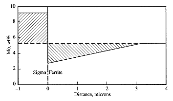

For the isothermal heat treatments used, mean diffusion distances (x) were calculated [14] for chromium and molybdenum in both ferrite and austenite, from the relationship:-
x = 2 √Dt      [2]
where D is the diffusion coefficient and t is the time at temperature. Values of D were obtained from ref 15, but should not be regarded as exact for the present alloy type. The results are given in Table 5. The expected depletion of Mo in ferrite is shown schematically in Fig.6, assuming a typical intermetallic particle width of 1µm, and simplifying the depletion profile from parabolic to linear form [14] . To maintain conservation of solute from ferrite to intermetallic, the minimum Mo content in the ferrite predicted at the interface is about 2.8%. This is consistent with the estimate from eq [1], although the minimum alloy level will depend on the exact value of D and on the size of the intermetallic particle. The greater diffusion distance at 1000°C in Table 5 would lead to Mo depletion of only about 1%, with correspondingly less effect on the CPT. From Fig.6, the Mo content at 1µm from the phase boundary should be some 2% below the 5.3% in the ferrite further away. With the EDX technique used, it is doubtful that such a depleted zone would have been manifest at sigma/ferrite boundaries, while it is also possible that phase boundary diffusion has enhanced intermetallic growth.
Fig.6. Simplified Mo concentration profile across sigma/ferrite boundary in 900°C/5min sample: note that hatched areas are equal

Studies using the scanning transmission electron microscope by Thorvaldsson and his co-workers [5,10] indicated reduction in ferrite Cr and Mo contents to about 22% and 2% respectively, in material immediately adjacent to sigma particles, the minimum occurring over a distance of some 0.1µm. From eq [1], this depletion would certainly induce significant loss of chloride pitting resistance. Moreover, Nilsson found that local depletion in Cr and Mo could be sufficient to induce ferrite transformation to secondary austenite [10] , and considered this reaction (together with Cr2N formation) to contribute to the poor CPTs obtained in S32570 material aged at low temperatures (750°C) which had intermetallic contents well below 1%.
Nilsson et al also considered [10] alloy element depletion in austenite to be unlikely, at least over timescales relevant to welding, because of the slow diffusion rate. However, from the direct observation of pit initiation sites in the present and other work [12] , depletion has occurred at austenite/intermetallic interfaces, although the diffusion distances in Table 5 are significantly smaller than the EDX analysis region, and observation of a depleted zone would not be anticipated. Pit initiation studies on stainless steels have indicated that pits can grow from nuclei as small as 10nm up to perhaps 1µm, depending on the severity of the corrosive medium [16,17] , and hence depleted zones of the size indicated by Table 5 should be quite adequate to induce passive film breakdown and stable pitting in ferric chloride.

From the present and other work [4,10,18] , corrosion resistance is not directly relatable to the volume fraction of intermetallic particles at levels of particular concern during welding. Hence, the common stipulation that welding procedure qualification testpieces should display a maximum intermetallic content of, say, 1% is of doubtful value. A similar situation would arise also for weld area toughness insofar as cleavage resistance would be governed by the maximum size of nucleating defects [19] , assuming these to be intermetallic particles, although it would be accepted that, with an increase in volume fraction, the maximum size of any individual particle is likely to be greater. It can therefore be recommended that acceptance or otherwise of a welding procedure should be based primarily on direct measurement of properties of interest rather than on metallographic examination for intermetallic phases.
