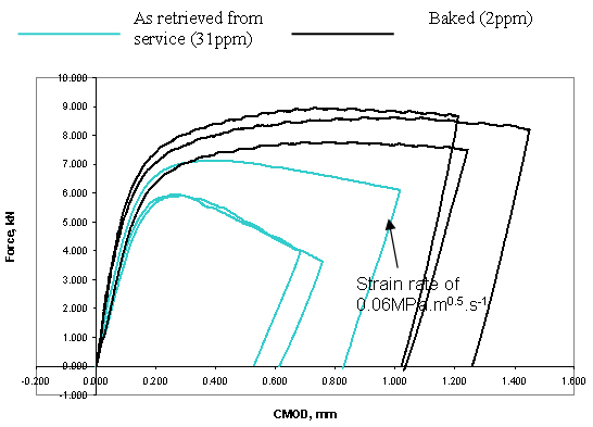

The graph in Figure 1 shows the load versus crack mouth opening displacement (CMOD) curves for each specimen and Figure 2 and Table 3 summarise the maximum load CTOD/J values for each specimen. The baked specimens exhibited higher δmax values, from 0.184 to 0.258 mm, compared to those obtained for the specimens containing a high level of hydrogen (0.049mm to 0.100mm). The high hydrogen specimen that was tested at a faster strain rate exhibited a higher toughness.
Figure 1. Load versus load line displacement records for weld A (service subsea). Strain rate was 0.01MPa.m0.5.s-1 except where indicated otherwise.

Table 3. Fracture toughness of weld metal of weld A
SpecimenConditionHydrogen, ppmInitial K rate
MPam1/2s-1
δmax, mmJ, N/mm
W01-01 As retrieved from seabed 31 0.06 0.100 134.9
W01-02 0.01 0.049 71.2
W01-03 0.01 0.052 72.6
W01-05 Baked 2 0.01 0.184 271.5
W01-08 0.01 0.199 347.1
W01-09 0.01 0.258 383.4
Moreover, the maximum loads for the specimens containing a high level of hydrogen were reached after a CMOD of approximately 0.4mm, which is shorter than for the specimens with a low level of hydrogen (>1mm). This indicates that, under similar testing conditions, the crack extended faster in the high hydrogen material than in the baked material. The initial slopes of the curves for specimens with high hydrogen level were lower than for the baked specimens. Figure 1 also shows that the high hydrogen specimen that was tested at a faster strain rate (6 times faster, but the test still lasted several hours) exhibited better toughness than the other similar specimens.
