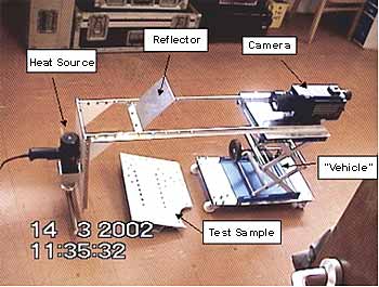

The initial proposal for Robair was to mount a small heat source on the robot vehicle, and to track this using a reflecting system to a high performance thermographic camera mounted on the ground. There was originally no possibility of mounting any system on the vehicle because of the weight. However, a lightweight camera was provided by Horton Levi and it was decided that this could also be mounted on the vehicle.
Two other problems remained, these were the nature of the heat source, and a suitable configuration. After some experimentation the arrangement shown in Figure 4 was arrived at. It was shown that the surface could effectively be viewed through a reflector. The camera could therefore be mounted on the vehicle directly. This arrangement also reduces the possibility of reflection from the aeroplane's surface of lights and heaters in the hanger.
Fig 4. Arrangement for Thermography
The choice of heat source was more problematical, and various methods were used. Variables such as heating time and emissivity were also studied. A range of techniques to adapt to different situations was developed, and two examples of the results are given in Fig 5-6.
