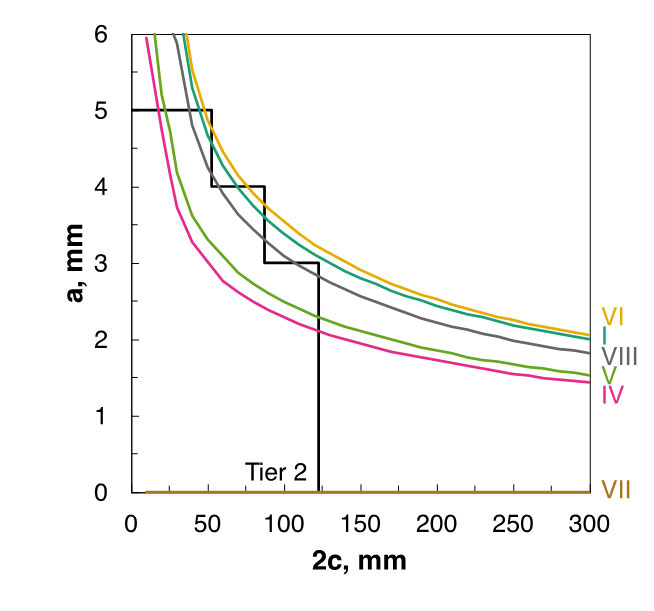

Fig. 8 a) Nos. I, II, III, IV and V
Fig. 8 b) Nos. I, IV, V, VI, VII and VIII
Fig. 8 c) Nos. VI, VII, VIII, IX and X
Fig. 8 d) Nos. VI and XI
d) Nos. VI and XI
I. A primary membrane stress equal to the yield strength of the parent metal. A fracture toughness determined using a single edge notch bend specimen, δmat = 0.15 mm.
II. A uniform tensile residual stress.
III. Global relief of a uniform tensile residual stress due to welding.
IV. Weld toe stress intensity magnification factor for a semi-elliptical surface crack at the weld toe.
V. A fracture toughness determined using a single edge notch bend specimen, Jmat = 125 N.mm-1.
VI. A fracture toughness determined using a single edge notch tension specimen, Jmat = 250 N.mm-1.
VII. Stress magnification (concentration) factor due to axial misalignment.
VIII. -IX. Pm(km -1) is classified as a secondary stress or partially as a secondary stress.
X. Pm(km -1) is classified as a primary stress, but apply Neuber’s Rule as per App. A D205 in DNV-OS-F101.
XI. A resistance curve (J-R) determined using single edge notch tension specimens.
Fig. 8  The tolerable flaw size calculated in accordance with BS 7910:2013, using the Option 1 approach without a ductile tearing assessment (Case Nos. I-X) and with a ductile tearing assessment (Case No. XI)

A circumferential, external surface crack-like flaw in a girth weld is described by Case No. IV. It includes the effect of the local stress concentration at the weld toe (the weld toe stress intensity magnification factor) and the effect of residual stresses. The effect of the local stress concentration at the weld toe is relatively small (Nos. III and IV). The effect of residual stresses is significant (Nos. I, II and III) and the effect of assuming some global relief is also significant (Case Nos. II and III). Residual stresses may be assumed to be uniform or non-uniform. The simplest approach is to assume that the residual stresses are uniform and then to assume some global relief of the residual stresses, as per Clause 7.1.8.2 (as in Case No. III). Annex Q in BS 7910 gives non-uniform residual stress profiles, but these require knowledge of the heat input during welding. (Annex 9D in API 579-1 similarly gives non-uniform residual stress profiles, but does not have an equivalent to Clause 7.1.8.2.) Case Nos. III and IV illustrate the importance of including the local stress concentration at the weld toe and residual stresses. It is also noteworthy that local stress concentration at the weld toe and residual stresses have no effect if the toughness is sufficiently high such that failure is controlled by plastic collapse (Lr is independent of Mkm and Mkb or Qm and Qb). The effect of constraint is significant (Case Nos. IV and V), see below. The effect of axial misalignment is significant (Case Nos. VI, VII and VIII-X), see below.
Case No. VI describes a circumferential, external surface crack-like flaw in a girth weld with a fracture toughness determined using a low constraint specimen, as compared to Case Nos. IV and V with a fracture toughness determined using a high constraint, deep-notched bend specimen. Case Nos. IV and V are lower than Tier 2. Case No. VI is similar to Tier 2, but lower than Tier 3. Tier 2 of the Guidelines is based on wide plate test data. Tier 3 is based on wide plate and full-scale tests data. The Guidelines are semi-empirical. That Case No. VI is similar to Tier 2 is indicative that the different approaches are broadly aligned. Case No. VI is, in fact, still conservative because explicit consideration of over-matching and ductile tearing would tend to lead to a larger tolerable flaw size (albeit noting that the effect of misalignment is to reduce the tolerable flaw size). The use of Option 2 (or even Option 3) would also lead to a larger tolerable flaw size.

The effect of axial misalignment is illustrated by Case Nos. VI, VII and VIII-X. Axial misalignment introduces an additional local bending stress (equal to Pm(km -1), where km is the stress concentration factor). km is calculated using Table D.1, d) Axial misalignment at girth welds in tubes, pipes, vessels …, with or without thickness changes. The effect of axial misalignment is significant. The local bending stress due to misalignment is considered to be a primary bending stress and so it contributes to both fracture and plastic collapse (i.e. Kr and Lr, respectively). It is the effect on Lr that is particularly significant. Case No. VII illustrates that the formulation of the reference stress solution is problematic (the effect is particularly pronounced in Case Nos. VII-X because Pm is equal to the yield strength). The notional effect of Pb on Lr is arguably too large.
Axial misalignment introduces an additional local bending stress (equal to Pm(km -1)). The default interpretation is that this additional bending stress is a primary stress, and so contributes to both fracture and plastic collapse (meaning that it is included in the calculation of both Kr and Lr). Case No. VII follows the default interpretation. Wei, 2010 [22] and Pisarski, 2011 [23] note that it might be more appropriate to treat this local bending stress as a secondary stress (meaning that it is only included in the calculation of Kr). In Case No. VIII, Pm(km -1) is classified as a secondary stress. In Case No. IX, 0.85xPm(km -1) is classified as a secondary stress and 0.15x85xPm(km -1) is classified as a primary stress. Kr increases. Lr does not change or increases slightly. The tolerable flaw size increases if the local bending stress is treated as a secondary stress (Case No. VIII) or partially as a secondary stress (Case No. IX). The effect is significant.
km is an elastic stress concentration. Appendix A of DNV-OS-F101 states that Neuber’s Rule may be applied. Neuber’s Rule is not included in either Section 7 of BS 7910 or Part 9 of API 579-1. The effect of applying Neuber’s Rule is to reduce the value of km. Pm(km -1) is classified as a primary stress, but km is smaller. Kr and Lr are calculated using the reduced value of km. (Kr is an elastic term, so it is questionable whether it is strictly appropriate to use the reduced value of km). The effect of applying Neuber’s Rule is illustrated by Case No. VIII. The effect is significant.
The issues illustrated by Case Nos. VII and VIII-X only arise if the primary membrane stress is large (near yield). A pipeline might be subject to large axial stresses and strains, but in a broader context it is an edge case. The default interpretation is Case No. VII. It is conservative. Case Nos. VIII-X highlight alternative interpretations that should be considered if the default interpretation is problematic.

API 579-1 and BS 7910 are intimidating documents. Annex A in API Standard 1104 and Annex K in CSA Z662-15 have taken all of the legwork out of navigating a route through either API 579-1 or BS 7910. In addition, API Standard 1104 and CSA Z662-15 (and BS 4515-1) present additional requirements regarding testing, qualification and approval of welding procedures and welders, inspection and testing of welds, etc. However, the simplicity of API Standard 1104 and CSA Z662-15 is notional. Option 2 in API Standard 1104 and CSA Z662-15 requires a similar level of calculation to an assessment conducted in accordance with either API 579-1 or BS 7910. The stress intensity factor and reference stress solutions are not significantly better than those in either API 579-1 or BS 7910 (see Fig. 4 and Fig. 5). Therefore, aside from obviating the need to navigate through the larger documents, the benefits of using Option 2 are open to question. The allowable imperfection size (the flaw acceptance criteria) are, at least in the case of the illustrative assessment, similar to or smaller than the tolerable flaw size calculated using BS 7910. The allowable imperfection size includes factors of safety, but that on length is at least partially there because of the simplified treatment of residual stresses.
Option 1 in Annex A of API Standard 1104 is, relatively speaking, very simple and straightforward to apply.
Tier 2 of the Guidelines is also very simple and straightforward to apply. Tier 2 will, for equivalent loading, etc., give larger tolerable flaw sizes than Option 1 in Annex A.
A simple and pragmatic approach would be to use Tier 2 of the Guidelines or Option 1 in Annex A of API Standard 1104 if and when all of the respective requirements are satisfied. Fatigue loading during installation or operation is the obvious load case that would prevent their use.
API 579-1 or BS 7910 should be used if and when the requirements of the Guidelines, etc. are not satisfied. A preference for either API 579-1 or BS 7910 is largely subjective and also an issue of familiarity. The stress intensity factor solutions in API 579-1 tend to have a wider range of applicability (and these solutions could be used instead of those in BS 7910). The treatment of uniform residual stresses in BS 7910 is arguably better than that in API 579-1. The reference stress solution for a surface flaw in BS 7910 is arguably more appropriate. The crack tip opening displacement, whether determined using SENB or SENT, is commonly used in Welding Procedure Qualification (largely for historical reasons). The crack tip opening displacement and the J-integral can both be determined independently from the test record, and both parameters have their uses. The J-integral determined from the test record (if available) should be used in an assessment (the use of the crack tip opening displacement would be slightly more conservative). Fracture toughness testing using SENB and SENT is standardised in BS 7448 [24-26] and BS 8571 [27], respectively10.
In the spirit of taking some of the legwork out of navigating a route through BS 7910:2013 (analogous to API Standard 1104 and CAS Z662-15), and only considering the calculations required for a fracture assessment, a few signposts to the relevant sections in BS 7910 are provided below:

An ECA is undertaken during design in order to calculate the tolerable sizes of flaws in the girth welds. The flaw acceptance criteria should be informed by the results of the ECA, but not dictated by these results. The capabilities of the inspection method, etc., should be considered. An ECA should complement good quality workmanship.
The goal is to consistently fabricate high quality girth welds at a reasonable rate of production. It is not to produce the largest possible flaw acceptance criteria.
Conclusion
An engineering critical assessment (ECA) is more than calculations and it is more than the software used to conduct the calculations. A black box obscures understanding. An investigation of the effect of assumptions made in the assessment with respect to constraint, misalignment, residual stresses, etc., illustrates the effect of the various assumptions. Curiosity is a step towards understanding. Software is then a tool to remove drudgery rather than a black box.
API 579-1 and BS 7910 are intimidating documents. Annex A in API Standard 1104 and Annex K in CSA Z662-15 are less intimidating, but arguably, either API 579-1 or BS 7910 are preferable to Option 2 in either Annex A or Annex K.
Option 1 in Annex A Alternative Acceptance Standards for Girth Welds of API Standard 1104 or Tier 2 of the EPRG guidelines on the assessment of defects in transmission pipeline girth welds – Revision 2014 should be used if and when all of the respective requirements are satisfied.
API 579-1/ASME FFS-1 and BS 7910:2013 include compendia of stress intensity factor solutions and reference stress solutions. The solutions for circumferentially orientated surface and embedded flaws in a cylinder are different (apart from the reference stress solutions for embedded flaws). The differences are both small and large. An understanding of the reasons for the differences would reduce the scope for significant differences between assessments using the different standards.
The effect of the stress concentration due to misalignment on the reference stress (and limit load) warrants further investigation.

Table 1   Assessment levels in API 579-1/ASME FFS-1 and options in BS 7910:2013
API 579-1/ASME FFS-1 2016
BS 7910:2013
Level 1
a simple assessment based on screening curves; limited to cracks and cracks-like defects in pressurised cylinders, spheres or flat plates away from all structural discontinuities
no comparable option
Level 2
a material non-specific FAD without an assessment of ductile tearing
Level 3A
as Level 2, but with partial safety factors
Level 3D
as Level 3A with an assessment of ductile tearing
Option 1
a material non-specific FAD; with or without an assessment of ductile tearing
(with or without partial safety factors)
Level 3B
a material specific FAD without an assessment of ductile tearing, with partial safety factors
Level 3D
as Level 3B with an assessment of ductile tearing
Option 2
a material specific FAD, requiring a uniaxial true stress-strain curve; with or without an assessment of ductile tearing
Level 3C
a material, geometry and loading specific FAD without an assessment of ductile tearing, with partial safety factors
Level 3D
as Level 3C with an assessment of ductile tearing
Option 3
a material, geometry and loading specific FAD, defined using finite element analysis; with or without an assessment of ductile tearing
Level 3E
the use of other recognised assessment procedures
Notes:
  • The Level 2 FAD in API 579-1 is similar to, but not the same, as the Option 1 FAD in BS 7910:2013. It is identical to the Level 2A FAD in BS 7910:2005. The FADs used in Option 2 in Annex A of API Standard 1104 and in Option 2 in Annex K of CSA Z662-15 are also identical to the Level 2 FAD in API 579-1 and the Level 2A FAD in BS 7910:2005.
  • The Level 2A FAD in BS 7910:2005 was taken from R6 Revision 3. The Option 1 FAD in in BS 7910:2013 is taken from R6 Revision 4 and FITNET.
