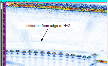

An image of a welded EF joint in a 180mm PE pipe is shown in Figure 10, where the indications from the heating wires can clearly be seen as well as the line indicating the edge of the heat affected zone (HAZ) in the fitting. The distance of the edge of the HAZ to the plane of the heating wires gives an indication of the amount of PE material that has been melted during the welding process and can therefore be used to detect cold welds. [8]

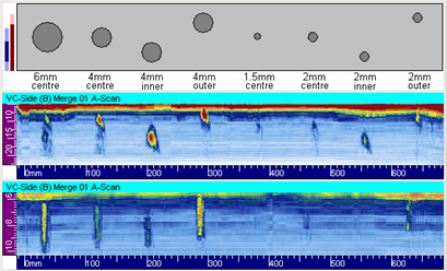

Figures 15 and 16 show data from scans on 225mm pipe containing FBHs and slots, respectively.
Fig.15 Developed view of FBHs in the end of a 225mm PE pipe using the sector pulse-echo and tandem techniques
Fig.16 Developed view of slots in a 225MM PE pipe using the creeping wave and TOFD techniques
The top part of Figure 15 shows a schematic of the FBH locations in the end of the pipe. The bars to the left of the drawing show the theoretical coverage of the techniques; the red bar showing the coverage with the sector pulse-echo technique and the blue bar showing the coverage with the tandem technique. The lighter areas in the bars show the contributions of the beam spread. In the center part, the B-scan end view of the sector pulse-echo scan, using a 4MHz probe, is shown. The axis on the left shows the through-thickness depth of the indication. In the lower part, the B-scan side view of the tandem scan, using the same probe, is shown. As can be seen, all of the FBHs can be detected using the sector pulse-echo technique and all but the 1.5mm and the 2mm inner FBH can be detected using the tandem technique.

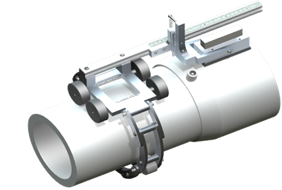

A flexible scanner system has been designed and manufactured that will enable full 360° rotation around both BF and EF joints in a wide range of pipe sizes (Figure 20). It comprises a main plate that is held in position around the pipe by several links and an adjustment mechanism. The plate contains an encoder and also the support for the probe holders for the BF and EF joints.
