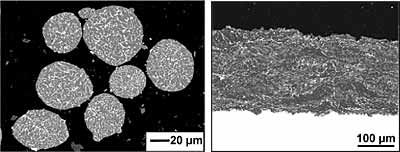

The development and optimisation of HVOF spraying for depositing Al-Sn based bearing alloys has been undertaken by the authors. [2,3] These alloys have been deposited using a number of HVOF systems of different design and atomised powders with a range of particle sizes. Coatings nominally 300mm thick were prepared and spraying parameters optimised within a 'design of experiment' approach. The optimised coatings are very dense with porosity measured well below 1vol% and oxide levels of about 1wt% or less. The deposited coatings were then heat-treated to develop suitable microstructures consisting of an aluminium alloy matrix with a fine dispersion of tin precipitates. A scanning electron microscopy (SEM) image of a cross section through an Al-12Sn-1Cu coating prepared using a liquid fuel HVOF system is shown in Fig.1 after heat treatment, with the lighter contrast phase being the tin precipitate.
Fig.1. SEM image (backscattered) of AlSnCu powder and coating heat treated at 300°C 1hr. Both viewed in cross section

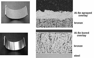

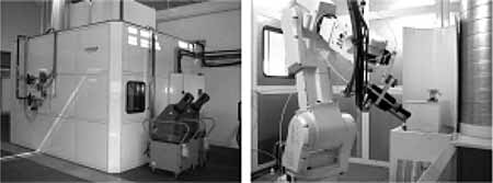

HVOF Sprayed overlays for a trimetal bearing
Glacier Vandervell at their Rugby Technology Centre have developed and introduced a new trimetal engine bearing that uses HVOF spraying to deposit an Al-Sn-Cu overlay. This approach has also been part of a move away from lead-based linings and overlays without loss in bearing performance. A prototype spraying facility was set-up to develop and demonstrate spraying of overlays onto large batch production runs of half shell bearings. The spraying facility is shown in Fig.2, with views of the spray booth, HVOF spray gun and component-loading carousel. The Al-Sn-Cu overlay is initially applied as a 100mm coating over a bronze-based lining, then bored back to leave a thin layer of just a few microns, whilst also allowing the required dimensional tolerances to be achieved, Fig.3. The HVOF sprayed overlay has been successfully applied to both lead containing and lead-free bronze linings. Extensive laboratory testing has compared the wear, seizure and fatigue properties of bearings having HVOF sprayed overlays to those with a more conventional sputter overlay. The results obtained for a viper wear test and 'Sapphire' seizure test show that the HVOF overlay has a lower wear rate than the sputter overlay, while still matching its resistance to seizure. A lower wear rate is important to maintain clearances in the system and prolong overlay life to reduce the risk of seizure. Following these engine trials, a production facility has now been established in France.
