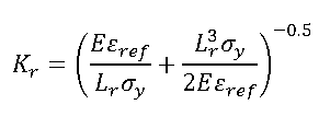

The fracture parameter, Kr, is the ratio of the elastically determined applied SIF to the material toughness defined in terms of a SIF. The elastic, plane stress conversion between J and SIF is given by expression 4.
eq4
[4]

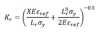

An alternative FAD has been proposed which uses parameter X to change the effective coefficient from unity for low loads to two for higher loads. This is given by the expressions (6) and (7).
eq6
[6]
eq7
[7]

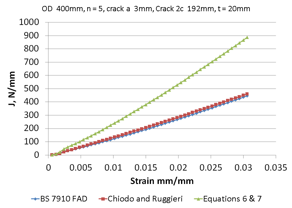

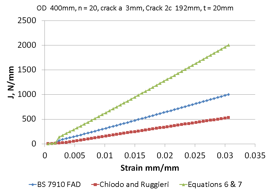

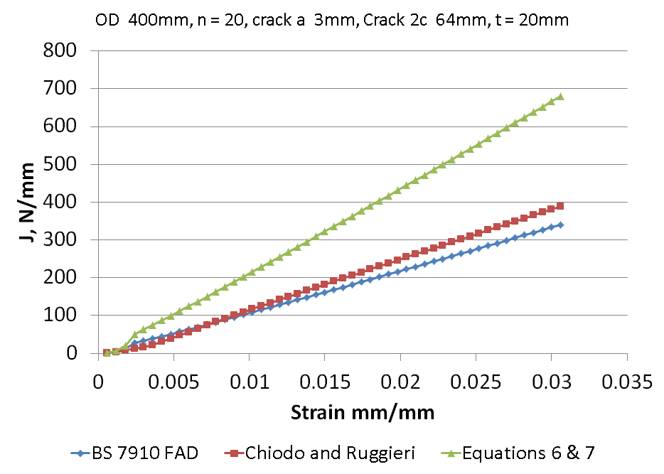

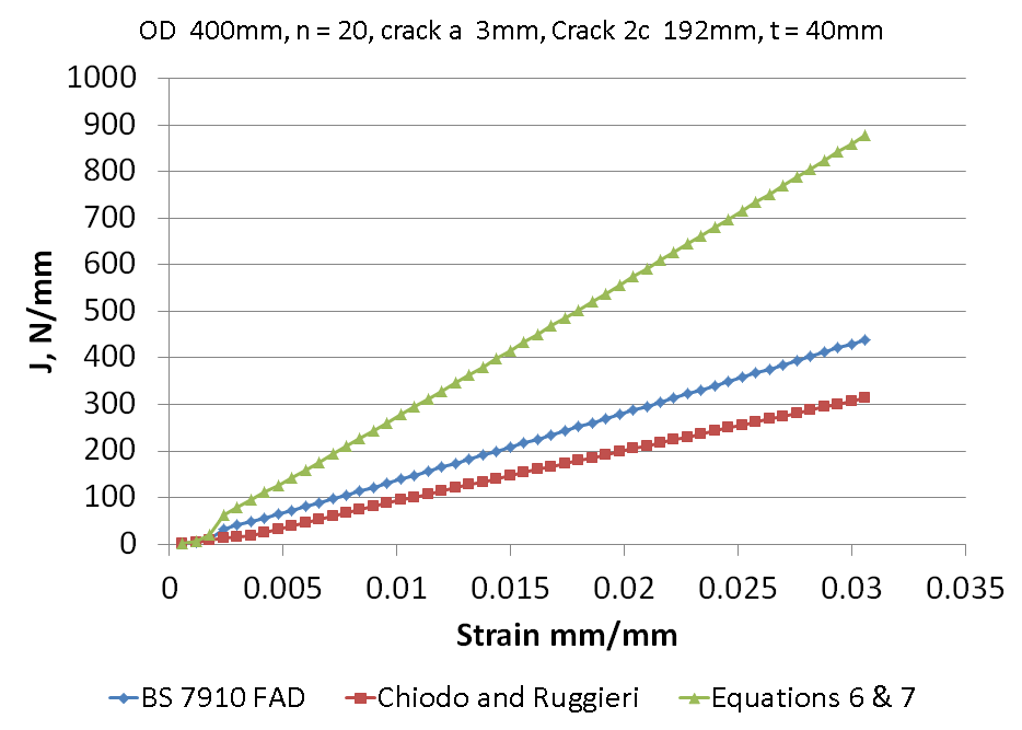

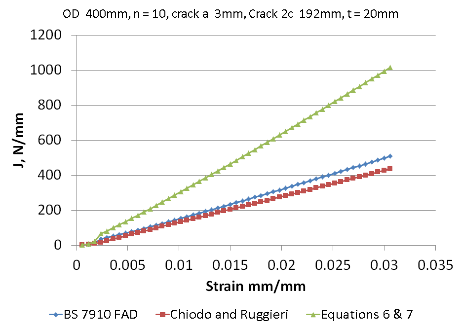

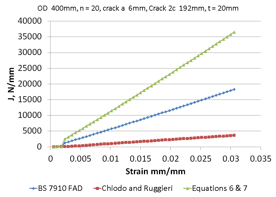

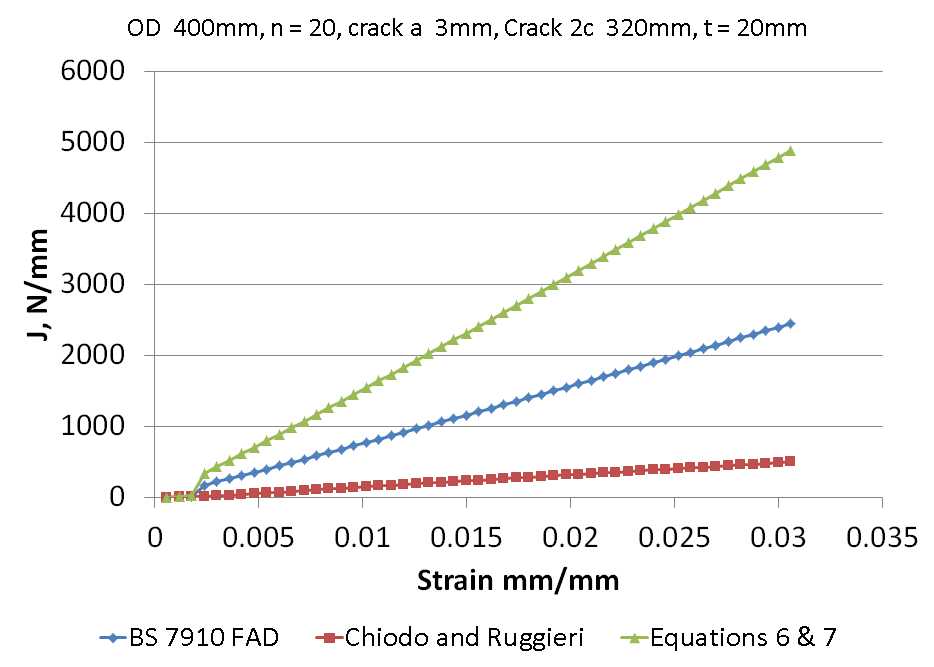

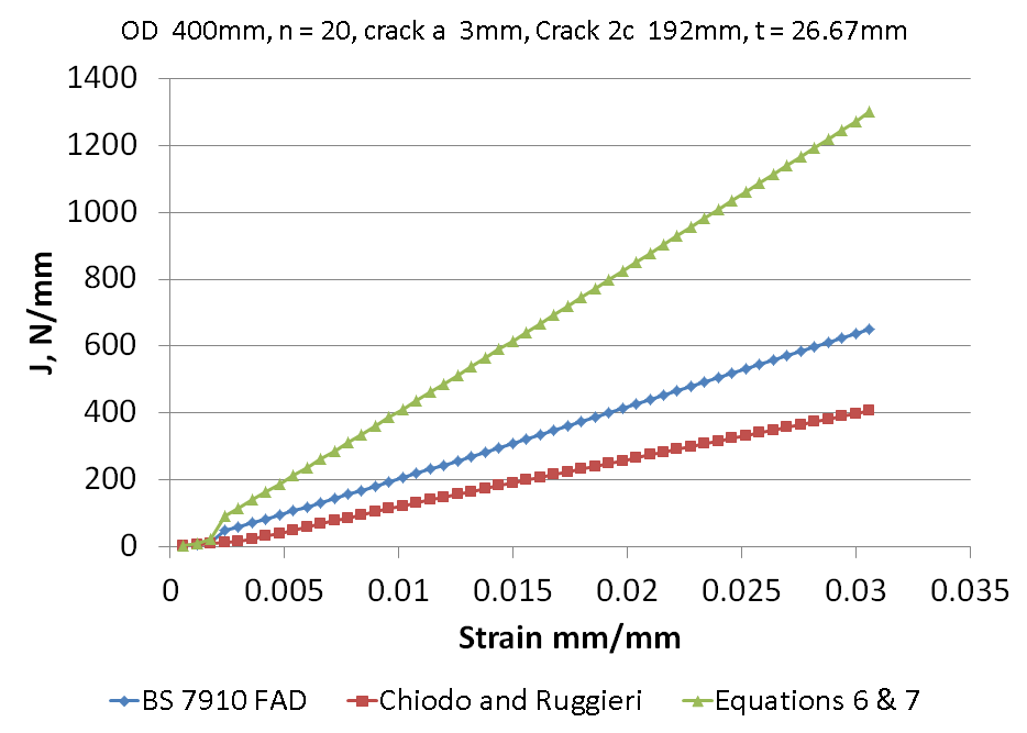

A comparison of the FAD-based derived J curves with the results from Chiodo and Ruggieri was generated based upon a pipe of 400mm outside diameter and a material of yield strength 448MPa (65ksi). Results are presented for pipe wall thicknesses of 40mm, 26.7mm and 20mm (D/t ratios of 10, 15 and 20). Comparisons were made for work hardening exponents, n, of 5, 10 and 20. Crack depth to wall thickness (a/t) ratios in the range 0.075 to 0.45 were analysed. Chiodo and Ruggieri defined crack widths using an unconventional definition of angle as specified by their equation 13. The study investigated a range of actual total crack width, giving rise to a subtended angle at the pipe centre of 2θ. The half angles studied were in the range 0.05 to 0.25 expressed as the ratio θ/π.
The implied J from the existing BS 7910 level 2B material specific FAD (equation (2)) was compared with J derived from the Chiodo and Ruggieri (Equations [8] and [10]). The comparison is therefore being made with FEA results, albeit in the form of curve fits to the FEA results. The results also show J from the new FAD (expressions (6) and (7)).
A list of the results and their figures is given in Table 1.
Discussion and Conclusions
Smith (2012) and the current paper were motivated by concerns that BS 7910 was not conservative for SBD. However, the results show that BS 7910 is in fact conservative for most of the cases studied. Two cases of non-conservatism were found. The first case of unconservatism (Figure 7) was for low work hardening combined with a small crack width (2c). BS 7910 was also slightly unconservative for at a higher rate of work hardening (n equal to 5, Figure 6). The modified ‘Smith’ FAD was conservative in all cases, but its level of conservatism was always significant, so that it appears to be unattractive. BS 7910 was also found to be overly conservative for both long and deep cracks (Figures 8-10).

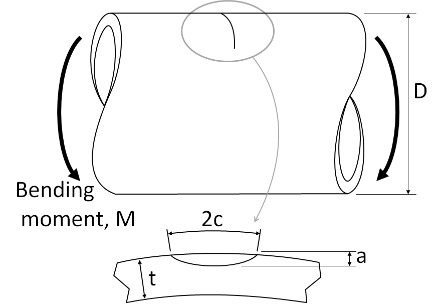

Figure 1 Geometry of the cracked pipe under a pure bending moment, M.
Figure 2 J versus nominal applied strain for a pipe of 400mm diameter (D)
Figure 2 J versus nominal applied strain for a pipe of 400mm diameter (D), yield strength of 448MPa with D/t = 10, n = 20, θ/π = 0.15, a/t=0.075.
Figure 3 J versus nominal applied strain for a pipe of 400mm diameter (D)
Figure 3 J versus nominal applied strain for a pipe of 400mm diameter (D), yield strength of 448MPa with D/t = 15, n = 20, θ/π = 0.15, a/t=0.112.
Figure 4 J versus nominal applied strain for a pipe of 400mm dia (D), yield strength of 448MPa with D/t = 20, n = 20, θ/π = 0.15, a/t=0.15.
Figure 5 J versus nominal applied strain for a pipe of 400mm diameter (D), yield strength of 448MPa with D/t = 20, n = 10, θ/π = 0.15, a/t=0.15.
Figure 6 J versus nominal applied strain for a pipe of 400mm diameter (D), yield strength of 448MPa with D/t = 20, n = 5, θ/π = 0.15, a/t=0.15.
Figure 7 J versus nominal applied strain for a pipe of 400mm diameter (D), yield strength of 448MPa with D/t = 20, n = 20, θ/π = 0.05, a/t=0.15.

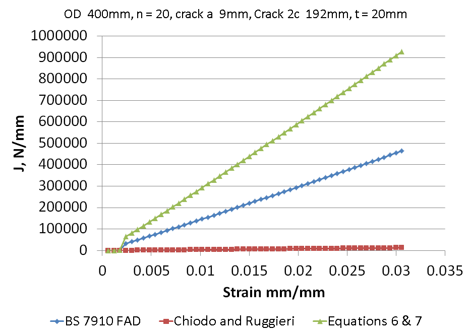

Figure 9 J versus nominal applied strain for a pipe of 400mm diameter (D), yield strength of 448MPa with D/t = 20, n = 20, θ/π = 0.15, a/t=0.3.
