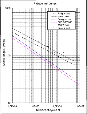

3.2.4 Fatigue
Fatigue testing was only required for the 12mm AL24 welds. Fatigue testing was performed on T joints both with the stiffener in a load carrying and a non-load carrying configuration. Fatigue testing was performed with an R = 0.1. Fig.15 shows the fatigue curve obtained for the load carrying situation compared with EC3 and IIW design curves for similar MAG welds.
Fig.15. Fatigue curve for an Nd:YAG laser-MAG hybrid welded T joint in AL24 steel with the stiffener in load-carrying configuration
As can be seen from the figure, the fatigue curve obtained lies well above the design curves for similar MAG welds (Euro code 3 CAT36 and IIW FAT45), especially at lower stress levels. The fatigue curve obtained for the Nd:YAGlaser-MAG hybrid weld also has a flatter slope than the design curves of IIW and EC3. This flatter slope is often seen for laser welds, and it seems that this laser trait is also present in hybrid welds. The difference in slope means that at lower stress levels the lifetime of a hybrid-welded part is significantly longer than predicted by the EC3 and IIW design curves.
Two different crack initiation and propagation modes were observed for the load-carrying condition. Mode 1, which is shown in Fig.16a was observed in specimens tested at higher stress levels, whereas mode 2, which is shown in Fig.16b, was observed in specimens tested at lower stress levels. It can be seen from the figures that the geometry of the welds giving these two different crack modes was similar.
a) high stress  b) low stress level
Fig.16. Crack propagation in fatigue specimens tested at: a) high stress; b) low stress level
Mode 1 has two different crack initiation points, namely the root of a weld and the toe of a weld. This is likely to have resulted from the fact that the fillet size of the welds was close to the critical fillet size for which crack initiation shifts from root side initiation to initiation at the weld toe. The fatigue crack in mode 2 initiates solely at the weld toe on the bottom plate.
The fatigue testing of T-joints in the non-load carrying condition showed similar results, i.e. a fatigue curve well above the design curves for MAG welding, and with a flatter slope. Both the fatigue tests thus showed that the fatigue properties of Nd:YAG laser-MAG hybrid welds had a closer resemblance to fatigue properties from laser welds that fatigue properties from MAG welds.
