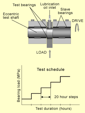

Fatigue properties: The fatigue strength of several bearing linings was measured using a 'Sapphire' test rig at Dana Glacier Vandervell, Fig.2. In this rig two test bearings are housed in a connecting rod big-end and run against an eccentric shaft. A load is applied to the test bearings for a period of 20 hours after which the bearings are examined. If there is no sign of fatigue damage in the aluminium lining, these are replaced in the machine, the load increased by 7 MPa, and run for another 20-hour period. This continues until the lining is seen to fail by fatigue.
Fig. 2. Schematic of Sapphire test rig and load schedule used to measure fatigue strength of the bearing linings
