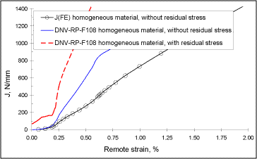

Analyses of the conditions described above were conducted according to DNV-RP-F108 to generate J driving force curve as a function of applied strain. As already explained, the assessment procedure is based on BS 7910 and Level 2B/3BFAD based method was used which employs the parent material stress-strain curve. The method assumes that the weld metal strength overmatches that of the parent pipe but no advantage of this is taken in the analysis. Linear elastic stress intensity factor solutions based on the Newman and Raju equations provided in BS 7910 were employed and plastic collapse was assessed using a reference stress solution based on the Kastner model. [4] This is recommended in BS 7910 for circumferential flaws in pipes and includes a modification to enable membrane and through-wall bending stresses to be included. Analyses were conducted for a series of strains. Since strain is not a direct input into BS 7910:2005 assessments, the corresponding stress was taken from the parent material stress-strain curve, as recommended in the reeling procedure. [3] However, in these analyses the true stress true strain curve was used instead of the engineering curve. For small strains less than about 1.5% differences in the stresses between the two curves are relatively small. The stress obtained was assumed to be constant through the pipe wall.
For each of the flaws considered two J driving force curves were obtained. In order to make a direct comparison with the results from the numerical analyses, the first curve was estimated with no allowance for welding residuals tresses. The second curve was obtained assuming that an initial welding residual stress, of yield magnitude, exists in the region containing the flaw. The second curve represents what would be calculated, according to BS 7910 and the reeling procedure, when the residual stress is included in the assessment as a secondary stress (i.e. contributing to fracture but not plastic collapse) in addition to the applied stress. The initial residual stress was allowed to relax, as the applied stress increased, according to a simple rule recommended in BS 7910. This rule does not allow the residual stresses to relax to zero; the minimum value is 40% of yield. This is highly likely to be a conservative estimate, since straining to around 2% would relax the residual stresses transverse to the girth weld to low levels. Nevertheless, the inclusion of residual stresses as described above can be considered to provide a factor of safety,the significance of which will be explained later.

Figures 3-6 show the relationship between the J driving force and remote applied strain predicted by numerical analysis (labeled as 'J (FE)') and according to the reeling procedure (labeled as 'DNV-RP-F108') for the four flawsizes considered. Results are shown from numerical analyses obtained on homogenous material (or an 'even strength matched' condition where the tensile properties of the weld metal are the same as those of the parent pipe) and, for the3x50 and 6x50mm flaws, on models where the tensile properties of the weld metal overmatch those of the parent pipe by approximately 20%. Both sets of numerical analyses were conducted without including welding residual stresses. Two sets of results based on the reeling procedure, obtained with and without including welding residual stresses as specified above, are shown (both assume homogeneous material).

Focusing first on results obtained assuming homogeneous material without including welding residual stresses, it can be seen that when the flaw height is less than 40% of the wall thickness ( Figs 3-5), the reeling procedure consistently underestimates the J driving force for applied strains greater than about 0.75%. When the strains are less than 0.75%, there is good agreement in predicted J values for the two analysis methods. For a deep (>40% of wall thickness) long flaw (90mm), the reeling analysis over-predicts the driving force J ( Fig.6).
Generally, the reeling procedure is used to justify acceptance of relatively small flaws, certainly less than half way through the wall thickness, therefore, the non-conservative nature of the reeling analyses when the pipe is subject to plastic straining is of concern. However, there are mitigating factors that reduce the possibility of obtaining non-conserve assessments and these are discussed next.

Another requirement of the reeling procedure is to allow for the effects of welding residual stresses. Two alternatives for incorporating these are permitted by the reeling procedure. The first is based on recommendations in BS7910and the second is based on adding yield strain to the applied strain. When the assessment is to BS 7910, as adopted in this paper, an initial welding residual stress, of yield magnitude, is assumed to exist in the region containing the flaw. As the applied stress is increased, the residual stress is allowed to relax down to 40% of the yield strength of the parent metal. The maximum relaxation occurs when the reference stress is equal to the flow strength (average ofyield and tensile strengths). However, as explained previously, a lower level of residual stress is likely to be present in the actual weld at applied strains above yield. The residual stress is treated as a secondary stress and therefore does not contribute to plastic collapse but does affect the fracture axis of the FAD. The outcome is that the residual stress will increase the J driving force for the reeling analysis as illustrated in Figs 3-6. These show that the reeling analysis curves including the effects of welding residual stress (labeled 'DNV-RP-F108 homogeneous material, with residual stress') lie well above all other curves including the numerical analysis curves obtained assuming homogeneous material and the reeling analysis curves obtained without allowance for welding residual stresses.
If residual stress is treated as a yield strain added to the applied strain, the J driving force curves for the reeling analyses in Figs 3-5 are shifted to the left by 0.24% (the parent pipe yield strain). Although this increases the J driving force for a given applied strain, it is insufficient to correct for its non-conservatism, for flaw heights less than 40% of the pipe wall thickness, in comparison with the results from numerical analysis at strains above approximately 1%. Clearly, the alternatives offered by the reeling procedure are not equivalent and on the basis of the results presented here, the recommendation is to treat residual stress in accordance with BS7910. Treatment of residual as an addition to the applied strain can lead to the prediction of a non-conservative J driving force when the applied strain exceeds approximately 1%.
