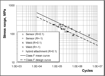

An example is given in Figure 4 of the comparison between the fatigue samples and the CrackFirst TM sensors for some constant amplitude fatigue tests. All samples failed by fatigue cracking from the toe of the weld. The results plotted for the sensors show the endurances at which the last track on each side of the sensor was severed; results for the earlier tracks are omitted from this plot for clarity. Since two sensors were tested on each specimen, and each sensor gives two results (one for each crack tip) there are four sensor data points for each weld. The Class F mean and design curves from BS 7608 are shown for comparison.
Fig. 4. Fatigue test results obtained under constant amplitude loading
It will be seen that the results for the welds lie close to the Class F mean curve, i.e. the 50% failure probability curve, as expected for joints of this type. A small effect of stress ratio is evident, tests under alternating loading (R=-1.0) giving endurances similar to or slightly greater than those under fully tensile loading (R=0.1). In all cases the sensors failed conservatively before the welds. At R=0.1 failure of the last sensor track was close to the Class F design curve, which represents a nominal failure probability for the welds of 2.3%. Hence, as intended, the sensors gave a reliable and conservative warning of reaching the fatigue design life of the joint. An exception was the test at the highest stress range, 210MPa, where the results for the last sensor track were greater than expected. As shown in Figure 4, this test was repeated with sensors attached using the hybrid method, i.e. the combination of CDW studs and adhesive, giving an acceptable result. It was concluded that at this relatively high stress range, with a maximum tensile stress in the cycle of 233MPa, attachment by CDW studs alone was insufficient to guarantee adequate load transfer to the sensor, but this was corrected by adoption of the hybrid attachment method.

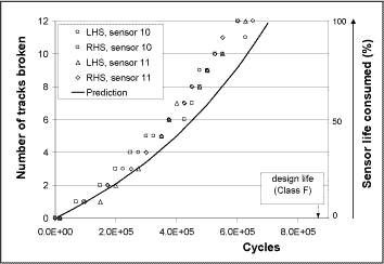

Figure 5 shows typical results for two sensors tested at a stress range of 90MPa, showing the full sensor output in terms of the number of severed tracks versus test cycles. The response is close to a linear characteristic and the prediction based on fracture mechanics. Typically the first track was severed at about 15% of the total life of the sensor and subsequent tracks failed regularly throughout the life.
Fig. 5. Typical results for two sensors under constant amplitude loading (stress range=90MPa, R=0.1) showing sequential failure of tracks

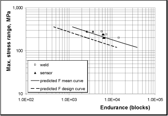

A number of validation tests were also conducted with loading of variable amplitude, using a loading history provided by one of the project partners (Caterpillar) obtained from strain measurements on the chassis of an articulated off-road truck. Stress ranges in the sequence were magnified to obtain failures within a maximum endurance of 30 million cycles. Test results for variable amplitude loading are plotted in Figure 6 in terms of the maximum stress range in the loading sequence versus the number of sequence repeats to failure. Results for the sensor are for failure of the last track. As observed under constant amplitude loading,all the sensors failed before the test specimens, with values in the range 0.44 to 0.84 for the ratio of the sensor endurance to that of the weld.
Fig. 6. Fatigue test results obtained under variable amplitude loading
Under the variable loading sequence adopted, the test welds gave lives significantly greater than predicted by Miner's rule, with values of the ratio experimental life/predicted life in the range 1.79 to 2.23. The sensors show a similar trend, but with values in the range 2.64 to 4.55. This is an important finding. It is well documented that under variable amplitude loading joints may survive longer than predicted by Miner's rule or may fail prematurely, depending on the type of loading sequence. Accurate prediction of such deviations from Miner's rule is not presently possible, even when the applied loading sequence is well characterised for example by strain measurements. On the basis of tests to date, it appears likely that the CrackFirst TM sensor will be a useful aid in predicting such behaviour. Clearly, investigation of other loading sequences is required in order to extend the validation, especially those for which Miner's rule is expected to give unsafe predictions due to crack acceleration.
