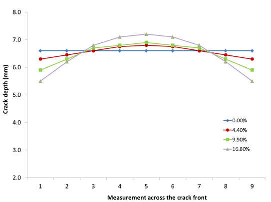

Some progress has been made in defining fatigue pre-crack front straightness requirements. The initial crack length, a0, is defined as in BS7448 Part 4 and is obtained by first averaging the two measurements at the outer points and then averaging this value with the seven inner points. The two outer measurements are taken 0.01B from the surface. Crack front curvature is defined as the difference between a0 and any of the nine crack length measurements. The maximum limit set by BS7448 Part 4 is 10%. A survey of fatigue pre-crack front curvature measured in over 400 SENT specimens is shown in Figure 7. If the curvature limit in BS 7448 Part 4 were adopted many of the results would be considered to be not qualified as the majority of the data give crack front curvature greater than 10%. However, does this apparently excessive curvature have an effect on the SENT test result? To assess this, the effect of fracture front curvature on J and CTOD was examined through a series of finite element analyses where the curvature was 4, 10 and 17% of a0 (Figure 8). The effect on the variation of CTOD and J across the crack front was examined and compared to a straight crack front. The SENT specimen had a cross-section with B=40mm and W=20mm, a/W was 0.33. The results are presented in Figures 9 and 10. They show that with up to 17% curvature, errors in J and CTOD, relative to a straight crack front, do not exceed 10% and 7%, respectively. Consequently, it is recommended that crack length measurements of SENT specimens are based on BS7448 Part 4 and that the maximum allowable curvature is 20% of a0, (Malpas et al, 2012).

Figure 7 Fatigue pre-crack front curvature as defined by BS7448 Part 4, in SENT specimens, from Malpas, Moore & Pisarski, 2012.
Figure 8 Crack curvature models for SENT specimens with =40mm, W=20mm and the same a/W but curvature up to 16.8% (as defined by BS7448 Part 4) from Malpas, Moore & Pisarski, 2012.
Figure 9 Effect of crack curvature, as defined by BS7448 Part 4, on CTOD across width of specimen (B=40mm, W=20mm), derived from Malpas, Moore & Pisarski, 2012.
