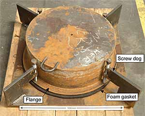

Two exercises were carried out. The first exercise consisted of a simple demonstration of the attachment of an enclosed dam to the underside of a plate underwater, simulating the attachment of such a structure to the underside of an FPSO. A gasket cut from closed cell polymer foam was adhesively bonded to the welded flange of the enclosed dam; see Fig.1. The attachment of the dam was effected by welding each of four screw dogs to a flat plate, representing the hull, with a three-pass fillet weld. The screw dogs were arranged radially, such that each bolt impinged on the flange of the enclosed dam. Whilst a flotation device would normally be used in practice, it was not employed in this instance. Instead, the enclosed dam was supported from above, through a hole cut in the centre of the plate to which it was being attached, thereby simplifying positioning of the assembly underwater. However, in other respects the activity was a simulation of the attachment of an enclosed dam.
Fig.1. Enclosed dam attached to the plate that simulated the bottom of the hull of an FPSO. Each of the four screw dogs shown was attached by depositing a three-pass fillet weld on one side in the overhead position.

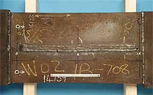

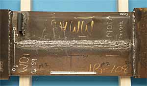

Visual Appearance of the Panels
Photographs of two of the butt welded panels are shown in Fig.2 and 3. The visual appearance of all the welds, including W01 deposited underwater, was good, as expected for MMA welds deposited in the flat position.
Fig.2. Weld W02, deposited in air, with an open root
Fig.3. Weld W01, deposited under water employing a backing bar

W01, the wet underwater weld, met the radiographic requirements of AWS D3.6 [5] Class A, which is the quality that is required of welds deposited in air. Welds W02 and W03 contained no significant defects, and were acceptable to BS EN 25817:1992 [6] Level B.

Photomacrographs of two of the three butt-welds are shown in Fig.4(a), and 5(a). The generally good profile of all the welds is noted, particularly that of the TIG root bead that was deposited in the open root of weld W02, Fig.4(b).
4a) Overall view 4b) Root Detail
Fig.4. Transverse section through weld W02. The nominal magnification is indicated by the millimeter scale
5a) Overall view 5b) Root detail, showing a small crack in the weld metal
Fig.5. Transverse section through weld W01. The nominal magnifications are indicated by the millimeter scale and by the micron bar.

  1. In a simple demonstration exercise, an enclosed dam was attached successfully to the underside of a plate by fillet welding screw dogs in place, simulating the attachment to the underside of an FPSO.
