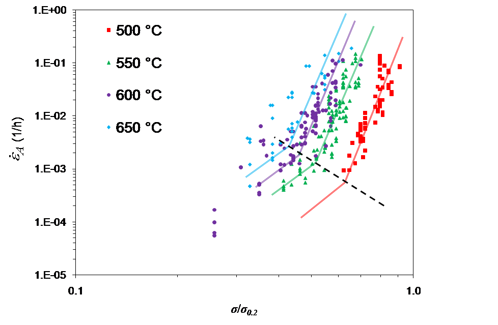

Figure 1 shows the plot for Eq. (5) in the logarithmic scale for the modified 9Cr steel parent material. Note that the data provided in this figure have been obtained from different batches of materials subjected to different heat treatments prior to testing and are therefore likely to show increased scatter. However, they have been considered as a single set of data to deduce the creep strain rate trends in the inherent creep data scatter. In this figure the applied stress is normalised by the proof stress to illustrate the level of plasticity. The proof stress used here 394 MPa at 500 oC, 349 MPa at 550 oC, 272 MPa at 600 oC and 183 MPa at 650 oC. However, as it is shown in Figure 1 the contribution of plasticity in the creep deformation behaviour of the material is negligible at the examined temperatures. As shown in Figure 1, a change in the average creep strain rate exponent, nA , can be observed from short term to long term test data at the range of temperatures examined. Also shown in this figure is that a trend (shown by a dashed line) between the normalised stresses at which the transition from short term to long term creep strain rate slopes and the temperature may be inferred. This is simplified by determining a transition point to indicate a lower/upper bounds for long and short term test times. Table 1 shows the σ/σ0.2 values at the transition points for different temperatures.
The best average of individual slopes at each temperature has been fitted to the data using the least squares method in Figure 1. The same behaviour has also been observed in C-Mn steel [11]. There are at present little or limited long term creep data that can be found in the literature for modified 9Cr. This is partly due to the relatively recent development of the alloy and partly due to data not being in the public domain. Either way for the purpose of this analysis an assumption of a transition point is conservative in terms of life assessment at long terms. In this analysis the values of nA = 13 and nA = 5 have been used for the modified 9Cr base metal at 600 °C in short-term and long-term estimations, respectively, considering the transition points indicated in Table 1. The same slopes have also been employed to provide the line of best fit at other temperatures even where limited data are available.

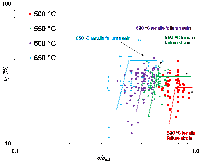

As seen in Eq. (4), the most sensitive parameter in the NSW prediction model is the creep ductility. Figure 2 gives the plots for modified 9Cr based metal creep failure strain versus the applied stress normalised by the proof stress of the material at each temperature. Figure 2 shows that a strong stress dependency may be inferred in the creep ductility of the material at different temperatures. Although data show a large scatter, a drop in failure strain is apparent when the applied stress decreases, especially in the higher temperature range. This means the material should satisfy the condition of Eq. (7) and shows nA > νr (note that for brevity, the rupture time data are not shown here, however the data at 600 °C confirm that nA > νr ). The stronger dependency of failure strain on applied stress at higher temperatures could be due to the effect of aging which is accelerated at higher temperatures.
If it is assumed the tensile test results at any temperature represent the highest level plasticity, this could be aligned with the upper-bound for creep ductility. Figure 2, shows this assumption can be considered valid for uniaxial creep test, especially at higher temperatures. The upper-bound value of tensile strain at failure for each temperature is provided in table 1. For the lower bound failure strain, an initial assessment would be the failure strain at the transition points identified in Figure 1 and listed in Table 1. Using the same σ/σ0.2 values for the failure strain it is clear that there is very little data available for all the temperatures to determine a transition lower-bound. It is likely that P91 does not exhibit a very sharp change in failure strain with respect to stress at longer times. The average of individual slopes has been worked out and fitted to the data, using least squares method, for the range of temperatures examined in figure 2. It is also clear that there is no lower-shelf behaviour apparent in this data set. This could be because there is no longer term data available or possibly due the inherent brittle nature of P91 which fails at very low σ/σ0.2 values of between 0.3-0.6 σ/σ0.2 over the whole of the stress range observed.

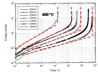

In addition the definition of creep ductility or failure strain may vary based on the material. In a general approach, failure strain is assumed to be the strain at the time of failure. However, a closer look at most of the creep curves, indicates that a big increase in strain to failure takes place toward the end of the life. This can be due to a considerable amount of necking which happens at the end of the life in a test specimen and possibly thin wall tubes in practice. On the other hand, once the material enters the tertiary creep region, it is not considered to be fit for service anymore. This is generally the case for P91 steel as shown in Figure 3. Therefore an alternative definition of failure strain could be adopted using the strain at the end of secondary (steady-state) region. Figure 3 illustrates these two definitions. This approach known as Monkman-Grant Ductility (MGD) has been used for P91 Parent material previously [12]. Using this method, MGD at various ranges of temperature and stress is presented in figure 4. The immediate conclusion from this figure is that the graphs in figure 4 present marginally less scatter compared with figure 2 and also there is more apparent dependency of MGD to stress. The comparison between the failure strains at different stresses still satisfies the power law relationship between creep ductility and applied stress. This method is expected to be a better and more conservative assessment of failure strain for longer term component behaviour

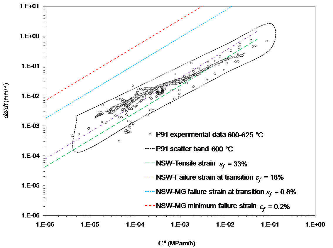

To apply the above discussion to the predictive CCG models, P91 scatter band developed in the previous work [7] was used together with recent test data developed at Imperial College London and TWI Ltd together with data from [3]. Figure 5 summarises the results. Here, an overall value for high stress and low stress condition from figure 1 (nA = 9.7 and AA = 2 x 10-26 ) were assumed to fit in Eq. (1). For NSW plane stress condition, the creep ductility was assumed to be the failure strain at the tensile. Using a constant value from the tensile failure strain data (εf = 33%) in NSW model provides Eq. (2) as follows:
Creep Crack Growth Prediction of Very Long Term P91 Steel Using Extrapolated Short-Term Uniaxial Creep Data Eq8
[8]
The plot of this equation is given in figure 5. Comparing this plot with P91 scatter band [7] shows it fits well with the lower band for the current available CCG data in high value of C* and consequently in lower C* values. It should be noted that this is considered to be in plane stress condition therefore higher predictive values of CCG rate are expected when considering a plane strain condition. For NSW plane strain condition, the creep ductility was assumed to be the lower creep ductility observed in figure 2, as assumed to be the lower bound ductility limit.
Using a constant value from the failure strain data at the transition point from figure 2 (εf = 18%) in NSW model provides Eq. (2) as follows:
Creep Crack Growth Prediction of Very Long Term P91 Steel Using Extrapolated Short-Term Uniaxial Creep Data Eq9
[9]
The prediction is closer to the middle of the data band. However it is still unable to provide a conservative prediction of the upper band. To fix this problem, another approach was adopted where the creep ductility is assumed to be obtained from the MGD approach (see figure 3). The failure strain obtained from this approach at transition point (εf = 0.8%) was used in NSW model which will provide Eq. (2) as follows:
Creep Crack Growth Prediction of Very Long Term P91 Steel Using Extrapolated Short-Term Uniaxial Creep Data Eq10
[10]
The plot of this equation in Figure 5 shows it can appropriately predict the upper bound CCG rate from existing test results.

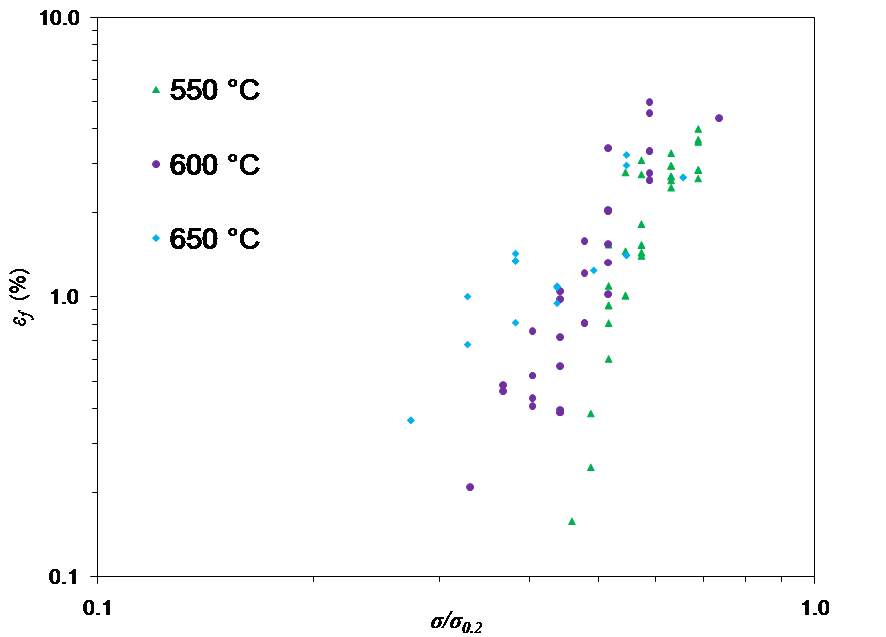

To illustrate the most extreme case, the lowest MGD from figure 4 (εf = 0.2%) was also used. This value may be obtained by applying the method from figure 3 to longer test duration; if the criteria of the failure strain is considered as the cross section of secondary creep and rupture time, a value of 0.2% creep ductility could be assumed for long-term uniaxial test which corresponds to low C* creep crack growth experiments. In the previous work [7] it was shown that current scatter band is only validated for values of C* greater than 10-6 MPam/h. From figure 5, the following equation is proposed for CCG rate prediction for P91 when C* < 10-5MPam/h gives:
Creep Crack Growth Prediction of Very Long Term P91 Steel Using Extrapolated Short-Term Uniaxial Creep Data Eq11
[11]
As seen in Figure 5, this approach provides the prediction line which is more likely to be capable of predicting the long-term CCG behaviour of modified 9Cr based material. The validation of this analysis is crucial and long-term CCG data are needed to support the prediction model.
Despite fact that the long-term CCG data are not available for this material, long term CCG tests on grade 316 stainless steel by EDF Energy Ltd [13] indicate that the correlations show similar trends to the prediction shown here for P91.

Figure 1: Average creep strain rate versus normalised stress

Figure 2: Creep failure strain versus normalised applied stress

Figure 3: Comparison of failure strain determination methods (provided by National Institute for Material Science)

Figure 4: Monkman Grant creep failure strain versus normalised applied stress

Figure 5: Extrapolation of creep crack growth rates at the low C* regime compared with the short term scatter band of Modified 9Cr CCG data at 600 oC
